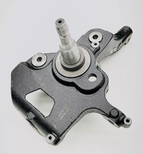

  4. nobby
    Joined: Jan 8, 2006
    Posts: 1,358
    nobby
    yes, I know what you mean,
    It would be better to start with a later model rotor like that of the 1999 -2010 ford ranger or 2wd explorer
    combined hub and rotor 4.5'' and use its twin pot caliper
    as it has the tone ring pressed on already and an aperture for a speed sensoruse the stock dust guard
    plus tyou cpould simply borrow long term the spindle part as it appears peressed in
    Front Right Steering Knuckle for FORD EXPLORER RANGER 1998-2009 ZZP/FR/023A | eBay
    run the stock twin pot caliper - -combined carrier
    the forging would be quite flat then if the spindle is pressed in
    use all the stock parts
    back plate
    caliper
    rotor
    bearings
    then if you ran a rear axle with the same brakes, you could use the master and it be all the same - -you know 2000 up ranger 8.8
    literally set it up on a so-cal 48'' wide axle with the 36.5'' perch - -the drop of the steering arms for using a stock 35/6 wishbone - -just 2'' from stock
    dial it all in for a 112 inch wheel base with the stock track
    you could literally sell them for the price of
    a pair of spindles
    a pair of stereing arms
    a pair of brake caliper hangers
    the bearing adaptor
    at least 500 us dollars a pair
    Brake Discs + Brake Pads Front For FORD EXPLORER 1995 - 2001 2WD | eBay
    might help in the longer term, when for example
    you run abs
    or the 10 speed automatic transmission needs a speed signal from the wheels
    you may not need to run older transmissions ,
    just a though
    the likes of that big brake company could then do a kit for the ranger/explorer carrier.
    it would be great.

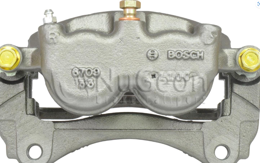

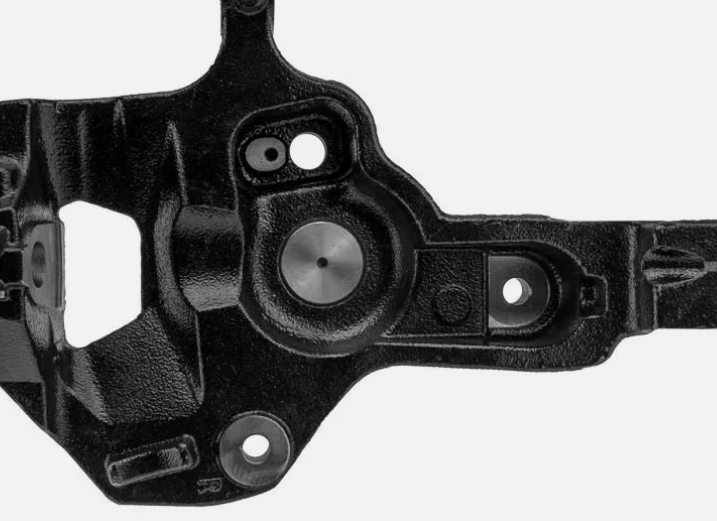

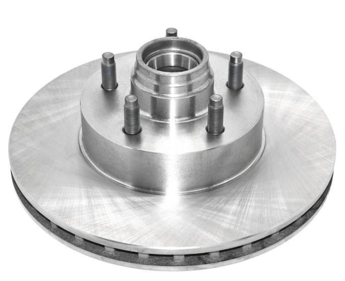

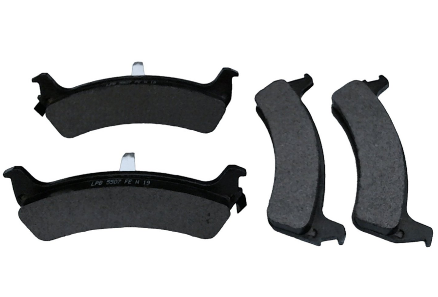

  12. nobby
    Joined: Jan 8, 2006
    Posts: 1,358
    nobby
    i think what i mean is
    the 2000 up ranger explorer 2wd knuckle has a pressed in spindle - -stub axle
    press that out - -5 axis machine a 1.5 inch thick steel flat stock part
    with the king pin nubs and the bouble eye dropped steering arms on the caliper side where it says 'R'
    the discs are 11.30 ''i bet they would go in a 15 inch steel wheel
    4.5'' ford.
    tone rings etc etc 7 bucks each
    lots of friction material
    the stock caliper carrier = =l
    one stop shop
    double eys rhd
    steering arms have a bit of web strength added to lower caliper mount hole
    just a thought
    stock dust guards you cannot seem to get though.
    machine it flat
    press in the stub axle
    no extra bolt on steering arms - already drop them and beef them up
    no sweat on bearing adaptor
    all that
    and a tone ring vss
    plus the hat or hub is really quite shallow
    so you can add to dial in geometeryer
    run a 6'' king pin
    i would pay 500 bucks for a pair
    Deutscher likes this.
