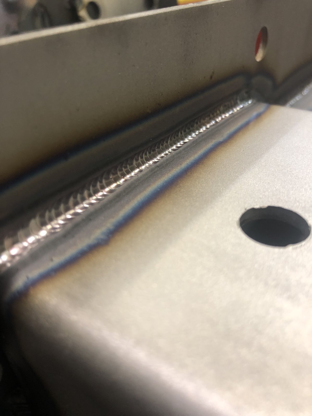

  4. Marty Strode
    Joined: Apr 28, 2011
    Posts: 9,774
    Marty Strode
    IMG_3926.jpeg Mig has its place but when it comes to welding thin, round tubes, you can’t match Tig.

  17. Sharpone
    Joined: Jul 25, 2022
    Posts: 3,614
    Sharpone
    That is art. Probably should be on FAS lol.I’ve seen tig welded stuff that is simply beautiful I welded up a SS header with MiG it looks ok and will work but I wish I had a tig for such stuff I did burn burn through a couple times ground, refitted and rewelded probably wouldn’t have burned through with a tig and the tig welds would look more sanitary.

    tubman
    "Stack of Dimes".:)

  22. Petejoe
    Joined: Nov 27, 2002
    Posts: 12,680
    Petejoe
    from Zoar, Ohio
    A good point for discussion.
    Take a good look at the stack of dime welds.
    Not the picture posted on this thread.
    With every “dime” you see on a weld. Instead of a constant and even flow of weld metal and heat… you are actually viewing a cold application of metal that’s not maintaining constant flow and heat.
    This uneven application can cause slag entrapment and possibly loss of strength.
    No ripples are better than small ripples, and small ripples are better than big fat dimes.
    One might like the appearance of "stack of dimes," and one could argue that in many cases, "stack of dimes" is "strong enough for the application." But you can't argue that it's superior, or even equal to, a smooth, fair weld in its resistance to fatigue.
    again…. This is not suggesting a critical view of picture shown on this thread.

  24. [​IMG]
    If you can lay a weld like this down with a Mig my hat's off to ya. If a stacked weld is good enough for the kind of work you do that's okay. Some of it just comes down to the overall quality of what you're turning out. I couldn't imagine a big fat Mig weld done on a product like Marty's and as a customer I wouldn't consider paying for such a job.
    If you're working on a rotted out door skin and have the ability to roll out a correct replacement skin section with Crown and Curve you want the final product to represent that work.
    When you start welding the new skin on the hand built inner structure you expect a quality finish without a bunch of whiskers protruding through to the inside. Then you should be able to do a File Finish like any quality repair would be. I don't care how good you might think you are, you can't get this kind of finish from a Mig Weld!
    This kind of work takes a few coats of primer and some block sanding, Not Body Man in a Can to carve out a finish surface. And that's why we that can Tig Weld, Tig Weld!

  26. 19Eddy30
    Joined: Mar 27, 2011
    Posts: 4,483
    19Eddy30
    from VA
    Just asking & not criticizing the welding,
    Is those beads
    ( I've aways ,was called stack of nickels)
    Any ways , are those beads done with dipping rod into puddle & controlling the heat with the pedal , or is it done with a pulsating controlled tig machine

  29. tomcat11
    Joined: Mar 31, 2010
    Posts: 1,183
    tomcat11
    Some people will get that stack of dimes look by pulsing the pedal but personally I don't think that produces the strongest welds. Some prefer a constant current flow while dipping the rod which creates the puddle freeze lines on the surface you see. The later does not have much of an effect on the penetration. Pulse settings are for thin material where you want to minimize the affected heat zone and distortion or shrinkage.
    I should add there are other important indicators in a weld profile to observe like the crown, toes, and color.
    The old square wave Miller is more than capable as long as it is in good working condition and is set up right. Fancy options? What are those? Could he be taking credit for someone else's work? Humm..
