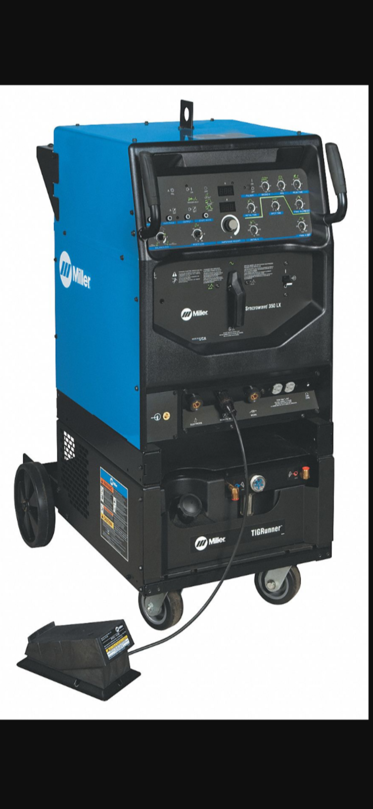

    A tig like this, He works @ a plaint as maintenance repair mechanic,
    I have seen one @ miller store ,but I have not used or check what all the function do, my square wave simple Power ,polarity ,amp adjustment and stick option with water cool

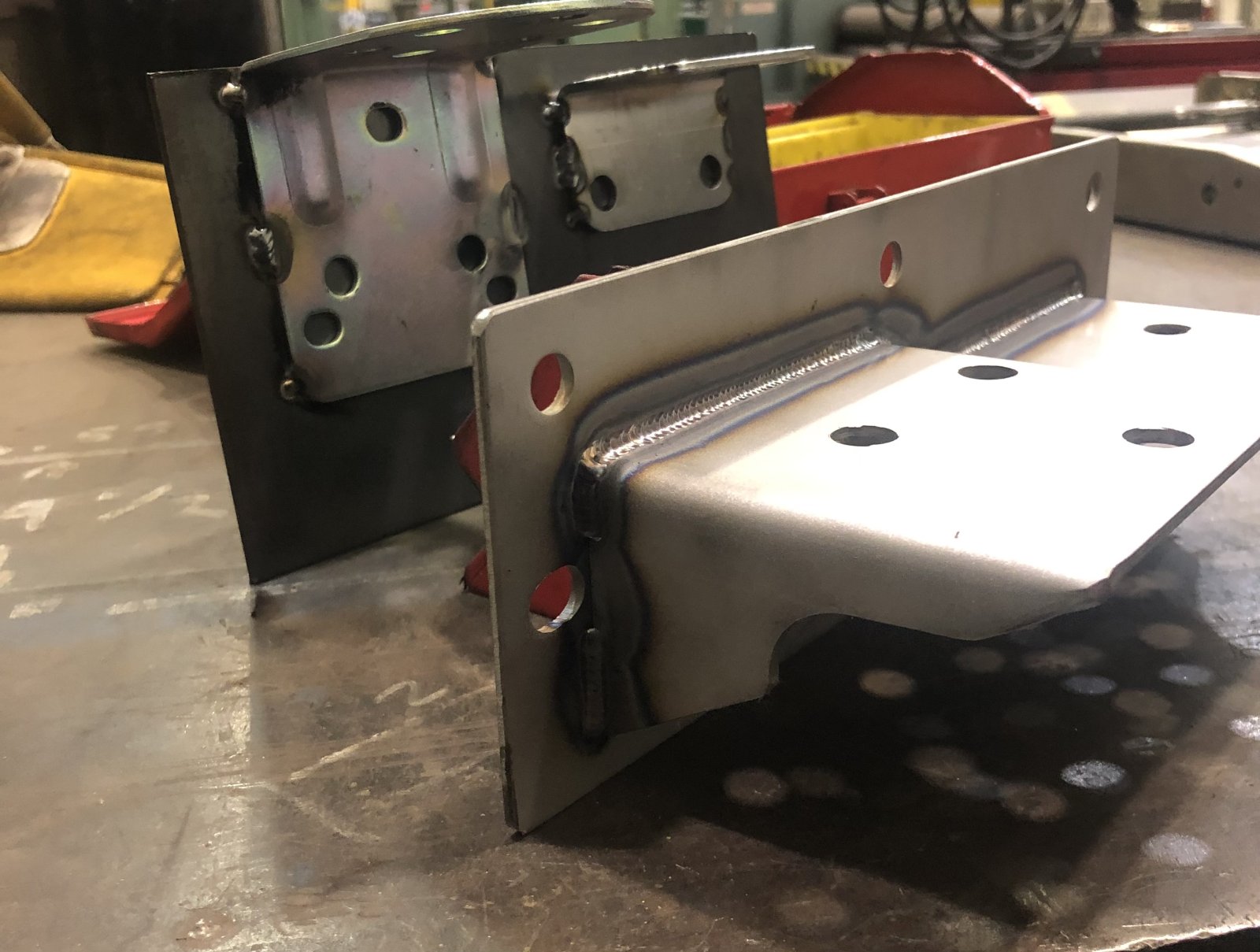

  15. In this instance all of those options were switched in the off position. I set the machine to the minimum amps needed to get the puddle going and hold the pedal down all of the way and have to start lifting off on it as I get closer to the end of the bead since the heat starts to really pile on the closer you get to the end of the work. I keep the tungsten practically in the puddle and dip the rod as needed. The cleanest material you can get also makes a big difference as well as the least amount of gap between the joint. The material is .125" plate for my fuel pre filter/pump mount. Made it modular so it can be dropped out easily if needed. I did not want to use the supplied mounts that came it each part so I tacked them to a s**** plate and matched all of the mounting holes up as one unit.

    Those beads to me are perfect uniform!!!

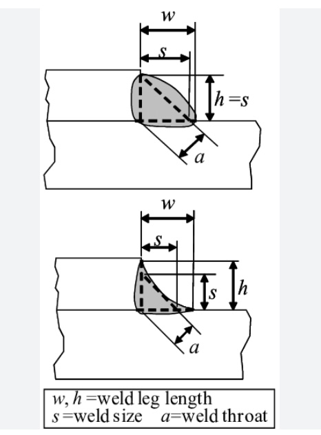

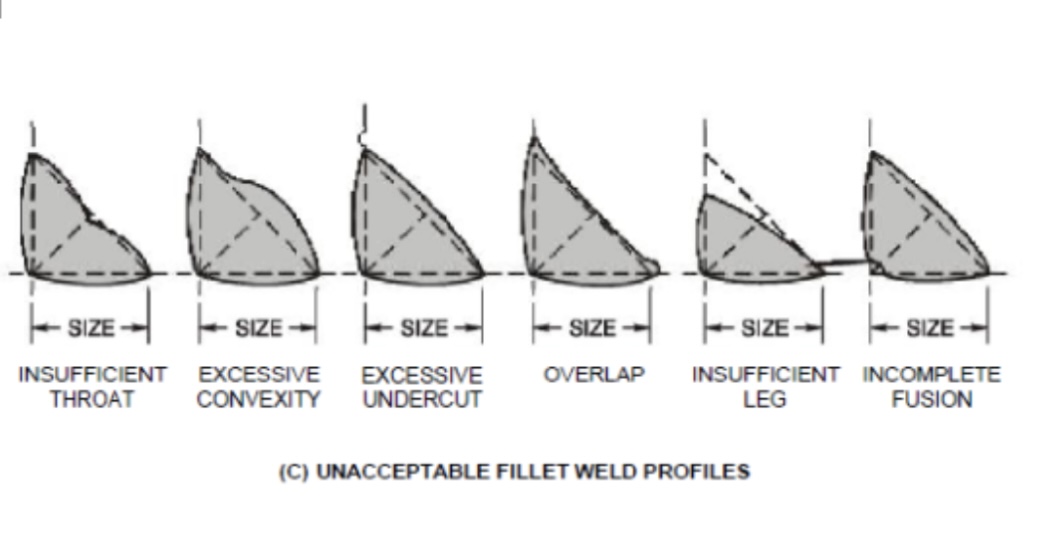

    IMG_0297.jpeg IMG_0298.jpeg Another interesting point that many see as acceptable…..
    The “fillet weld size and shape”
    A “concave filet weld can be weak” regardless of whether it’s as smooth as **** and shows no signs of cold lap or slag entrapment.
    I’ve seen many welds as being top notch but actually fall into this category.
    The weld configuration should not look like this.
    A concave weld may look pretty but could actually have a throat thats too thin.
