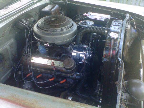

    Post a picture of your engine compartment.

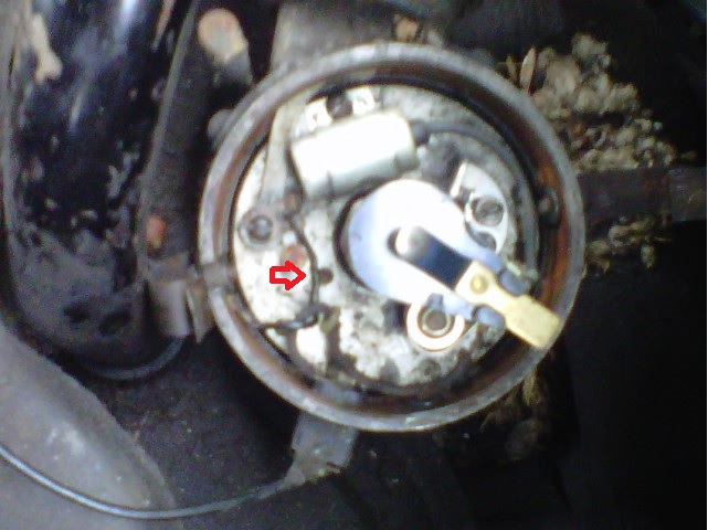

  16. This is under my distributor cap in case anyone wanted to see a shot.

  18. d2_willys
    Joined: Sep 8, 2007
    Posts: 4,394
    d2_willys
    from Kansas
    What is the part shown by the red arrow? Is it a wire that looks like the insulation is burned or melted. If so, that is the pigtail to point plate. And if that is not grounded to distributor outside shell, then no spark. See photo

  21. No moisture inside. Going to start now.
    and uh, I dunno what that red arrow is lol. If it doesn't start then maybe that will tell me something...

  23. Still no start...sprayed starter fluid a couple times and nothing, just the smell of the fluid...so I guess I'll go back to earlier pages and try some of the other things.

    If I think what the red arrow is pointing to is what I think it is, the car will not start. I had a friend's 68 Firebird 400 die on the side of the road. Guess what it was the grounding pigtail. This grounds the point plate to the distributor shell, and yes, the connection can go bad overnight. Call it gremlins or whatever, it happens.
