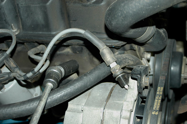

  22. mashed
    Joined: Oct 15, 2011
    Posts: 1,474
    mashed
    from 4077th
    Don't need a fancy spark plug tester to test for spark. All you need is someone to crank the engine while you ground the end of a spark plug like this. You should see spark jumping and if you don't time to eliminate possible no spark causes. Ain't rocket science..
    Notice the end of spark plug is touching ground. Let's go!
