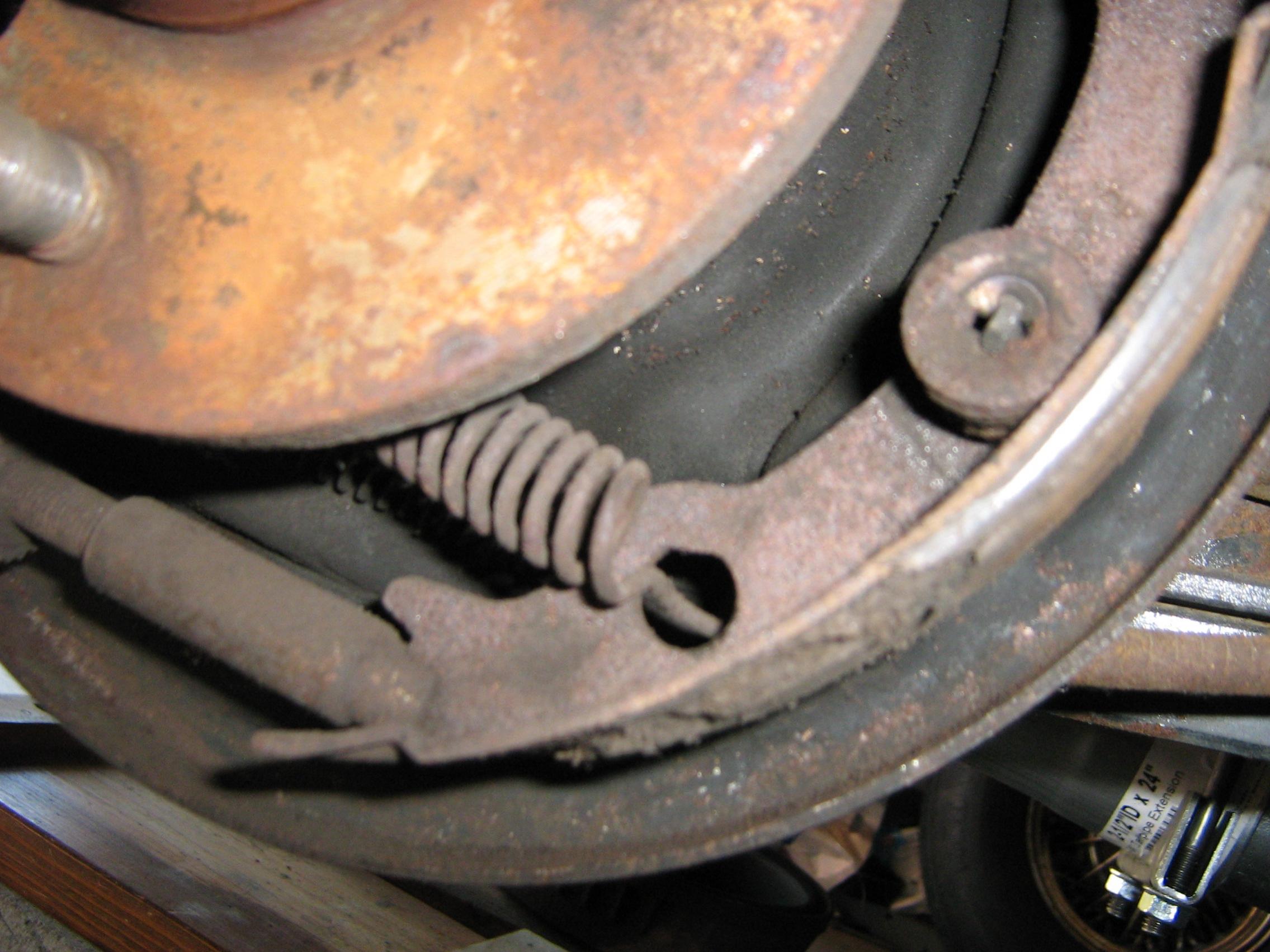

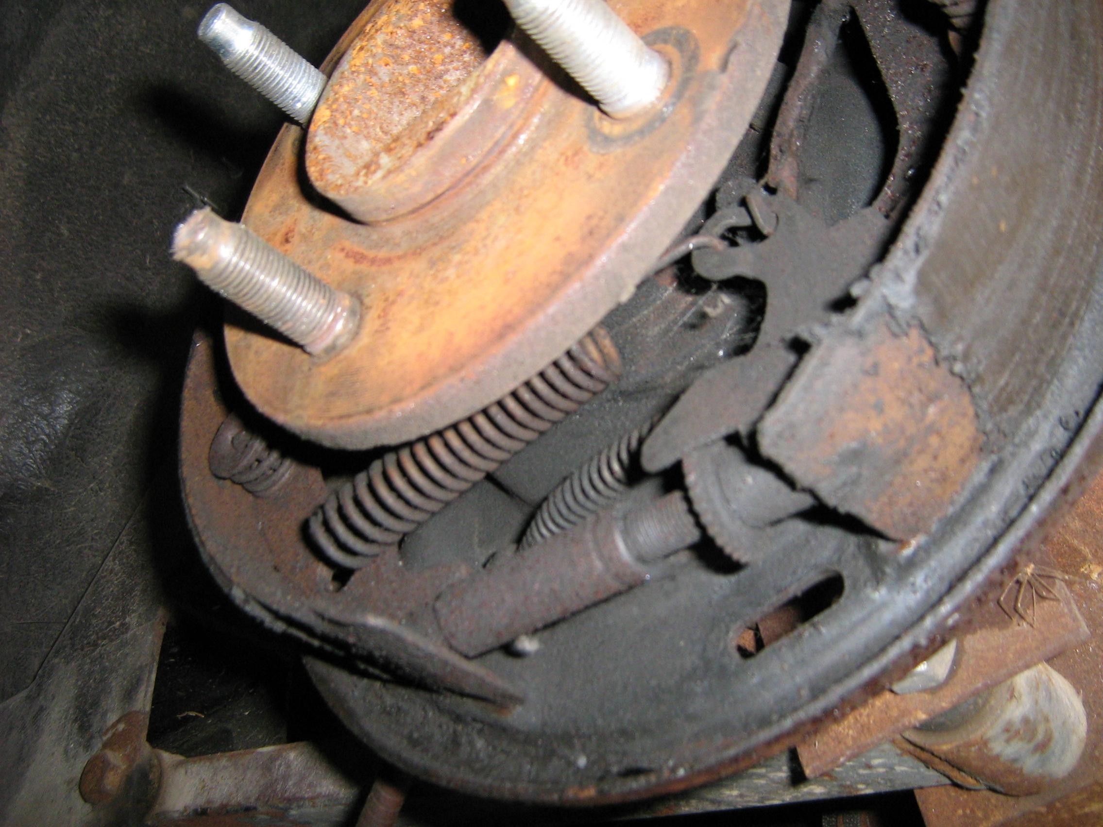

    pat59
    Well got it all apart. Everything inside was completly rusted out and seized up. I used the hole saw to cut that flange off of the drum centers. and a couple BFHs and pry bars and alot of sweat. I've now got a bunch of s**** metal. Now to clean up the rear and get all new brake parts.
