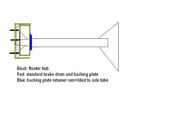

    Why can't you make up a backing plate flange to weld on the axle tube, then bolt the backing plate/brake assemble to that and slide the drum over your current hub. See pic below for crappy picture of above.
