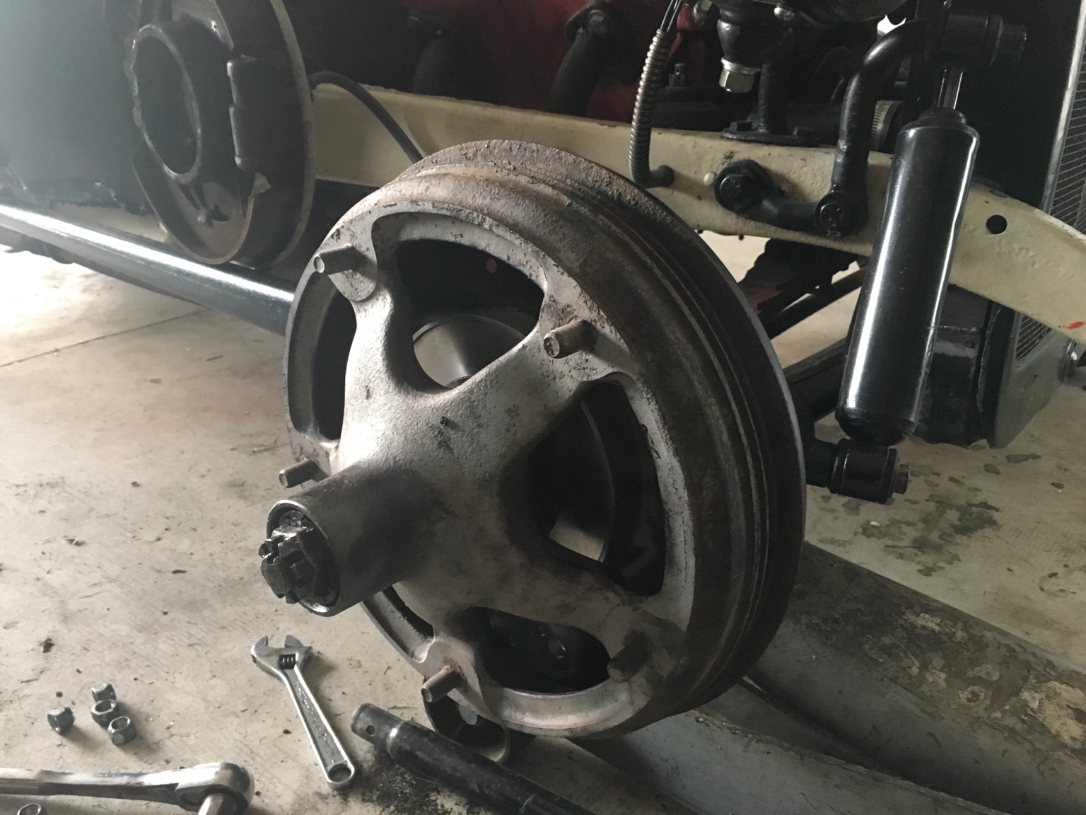

    I have been is search of a set of front wide 5 Rocky Mountain drums for a long time.. these popped up a few weeks ago and I was able to grab them for my coupe... thanks to fellow H.A.M.B.'er, they showed up and I couldn't help but to take some pics of this project coming together... I don't know if Rocky Mountain brakes are the correct term for these drums but they kick ***... I had to modify a set of backing plates but spindles and drums did not have to be touched.. new set of 40 ford wheel bearings make them spin perfect... I need to do the finish welding and painting yet, but I'm pleased with the results.... [​IMG][​IMG][​IMG][​IMG][​IMG][​IMG][​IMG][​IMG][​IMG][​IMG][​IMG][​IMG]

    Nice,please explain the modification to the backing plates.

    I had a set of 40 ford backing plates here that had already been chewed up... I cut some tubing to a 7/8" spacer... I machined up a new flange for the spindle and "wala"... tacked everything together and son of a gun it all laid out perfectly... as for getting road dirt in them, well I do have wide 5 hub caps, but they look to cool to cover up... no off roading without hub caps...

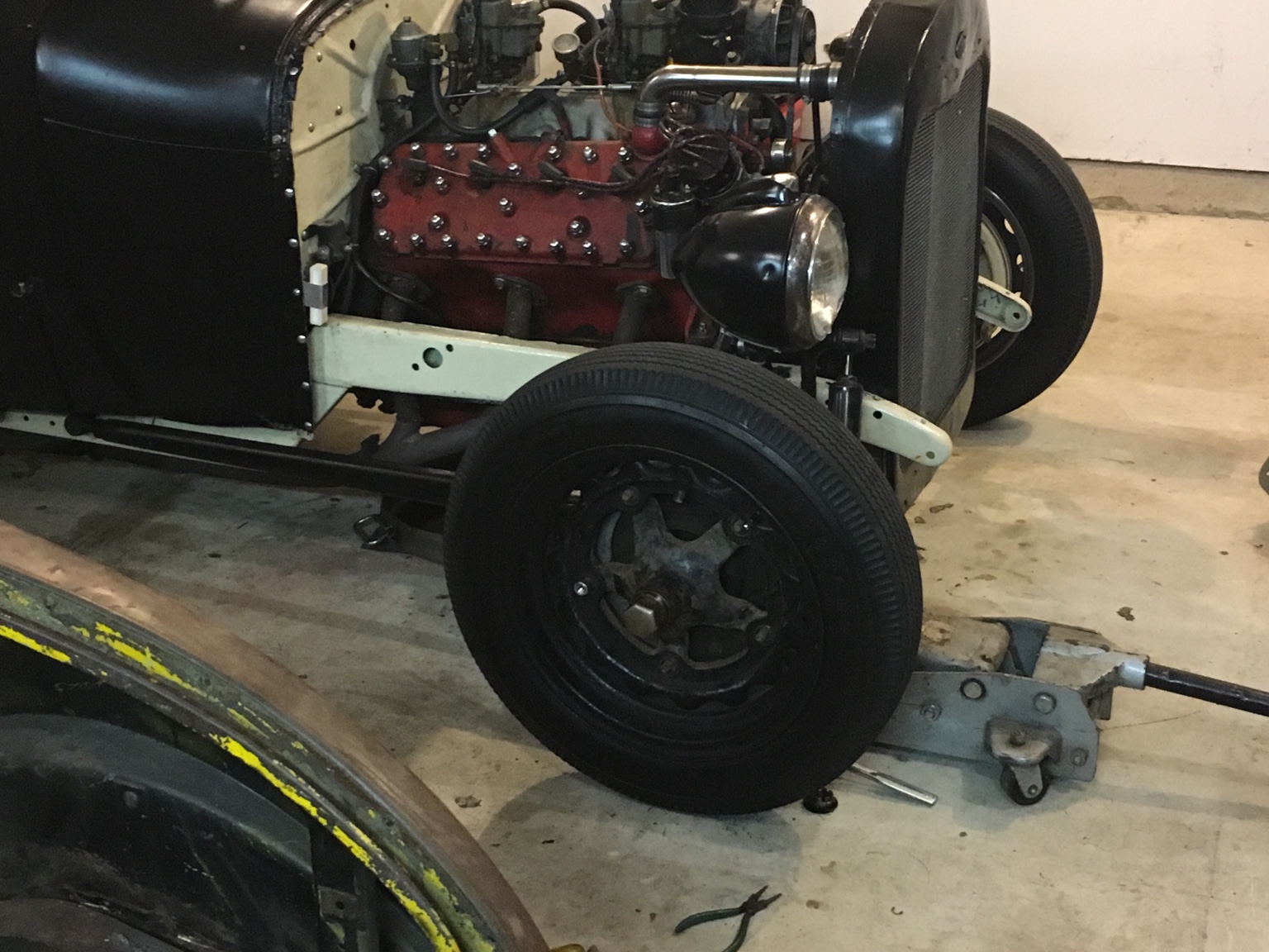

    Rolled the car out of the garage for the first time with its new brake set up... going to take it out this weekend to try them out... over all happy with how they came out... IMG_1089.jpg IMG_1091.jpg IMG_1097.jpg IMG_1106.jpg IMG_1115.jpg IMG_1113.jpg

    What makes the 36 spindle stand alone... I had to turn up a .063 shim/ spacer to place behind rear wheel bearing to get a proper seat of the wheel bearings... these are 40 spindles.... they spin smooth as can be... so I guess I'm asking is it the length of the snout on spindles that make 36 different from later years... thanks for your input...

    Yes, the snout is different length on 36 spindles. Otherwise they are exactly like 35 spindles.
