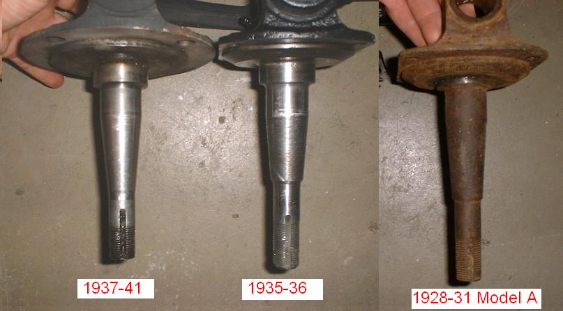

  2. here is a picture from the web that shows the difference between spindles spindleComp.jpg
    Tim_with_a_T likes this.

    Fantastic, thank you for that side by side shot.... what a learning adventure this has been... thanks for all the info guys... took the car out this weekend and brakes worked great....
  4. So, I have read this post and re-read it a few times. I am confused as to how you got the longer snout and bearings of the 36 hub to fit on the shorter later spindles? When I look at the pictures it looks like you have full castle nut engagement, when I know you should be having problems there.

    Ok, I can give somewhat of an explanation... now I do not know if the bearing races were pulled and replaced or if they were modified... I started by measuring a stock 37 drum... took all the internal measurements and went to these drums and they measured the same.... the offset was different.. so that's were the recessed backing plates came into play... now once I got the backing plates set, I was able to ***emble everything... once I greased the bearing ( which were ford bearings and seals, and same as my 37bearing/seals) I set my preload on my bearings and took her out... I did not completely like the seat so I machined up a shim to give the rear bearing a better fit.... I drove the car all over Syracuse this weekend and no problems with the brakes.. wheels bearings are tight and spin just as smooth if not better than my stock drums... I did check spindles to see where my bearings are running and they are in place... not knowing anything about these drums before I started, I went the route of "making it fit the spindles properly and modify the rest... again, maybe these were modified before I got them...
