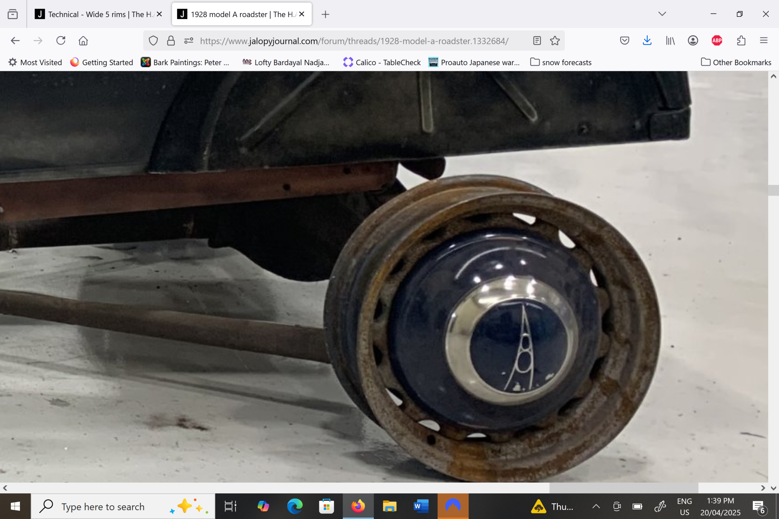

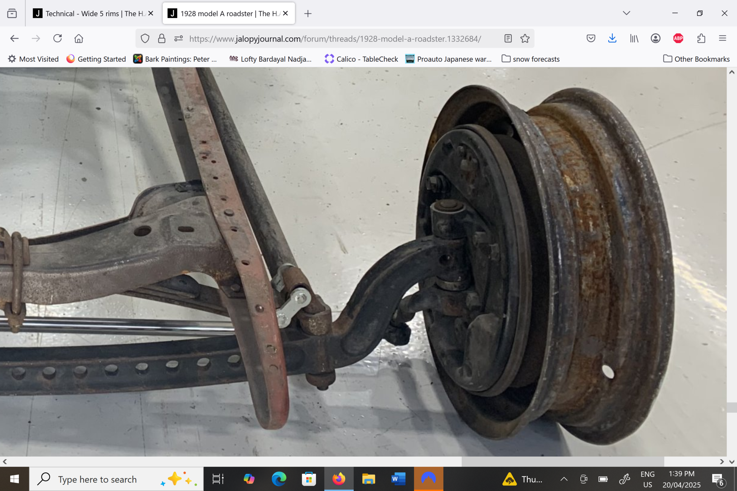

  12. panhead_pete
    Joined: Feb 22, 2006
    Posts: 3,719
    panhead_pete
    Thanks!
    51504bat likes this.
  13. Dedsoto
    Joined: Jan 7, 2014
    Posts: 375
    Dedsoto
    from Australia
    They're the most common 16x4
    panhead_pete likes this.
  14. gimpyshotrods
    Joined: May 20, 2009
    Posts: 24,525
    gimpyshotrods
    16 x 3.5 V8-60 and 16 x 4 look the same, but the width.
    16 x 5 doesn't have the short spokes.
    18's have longer spokes.

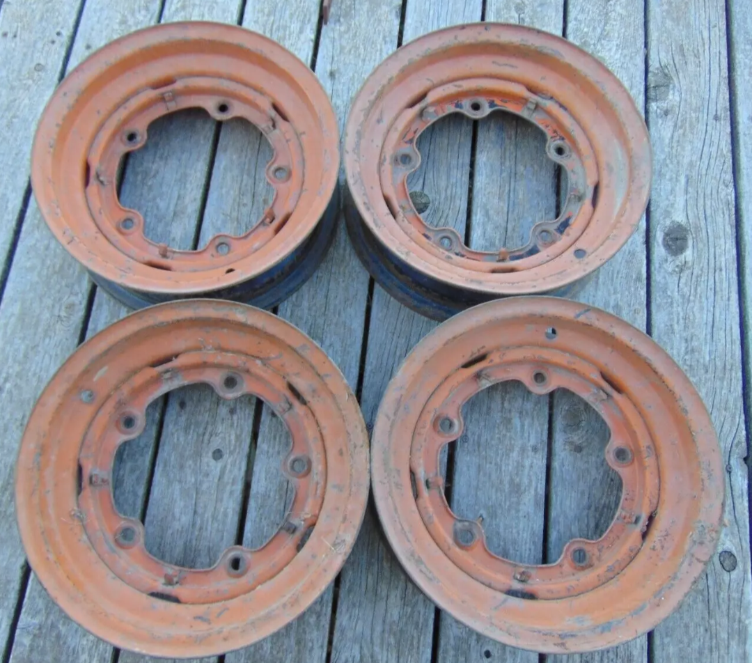

  16. gimpyshotrods
    Posts: 24,525
    gimpyshotrods
    51504bat and panhead_pete like this.
