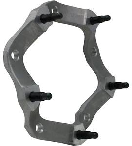

    Check with the oval track suppliers. Wide 5 is a mainstay in dirt track racing. I’ve seen a couple of different types of spacers for wide 5 in Speedway’s catalog. One type is like a nut that threads onto the studs behind the wheel. Another type is a little funky. It’s a casting I think that bolts to the hub and has 5 studs offset between the hub studs that you bolt the wheel to. Not sure I’d trust that type. There’s probably someone who makes a ring that is placed between the hub and wheel, but I’ve never seen one like that
