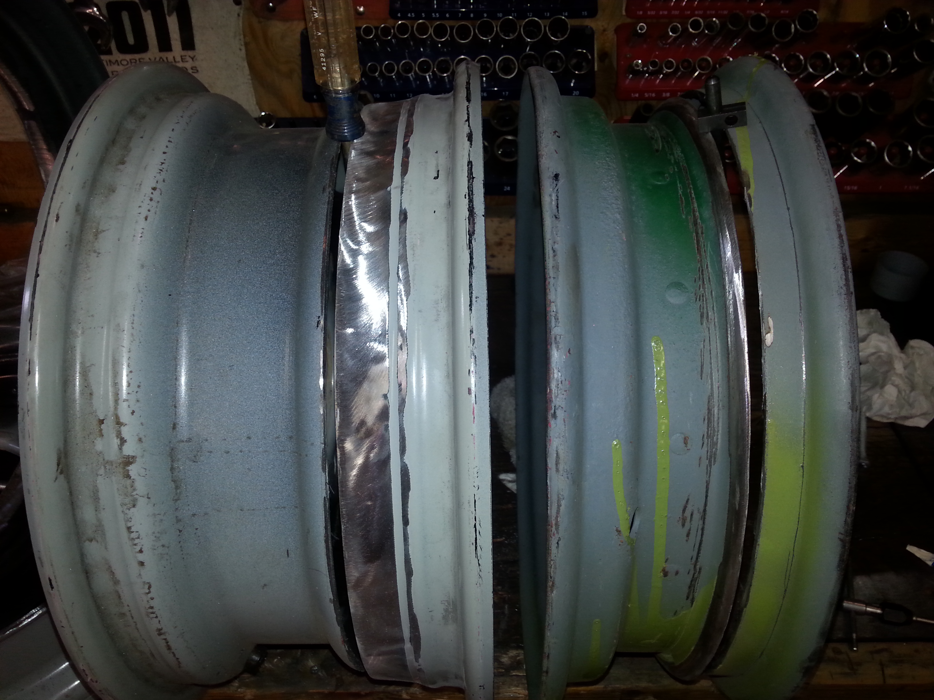

    For you guys that are modifying them, there is FACTORY built 5 or 5 1/2" (i forget, i have 2 of them tho) wide 5's, kinda rare, but good stuff
    ALSO there are 6 1/2" x 16 hoops on some late 90's GM p/u's and vans that work perfect, only problem is the front face is stamped as one piece with the rim, so they take a bit of work grinding them to look right. Otherwise they are perfect size hoops, just drop your center in place

    Hey guys thanks for the tech on shrinking and widening. Jim Ford

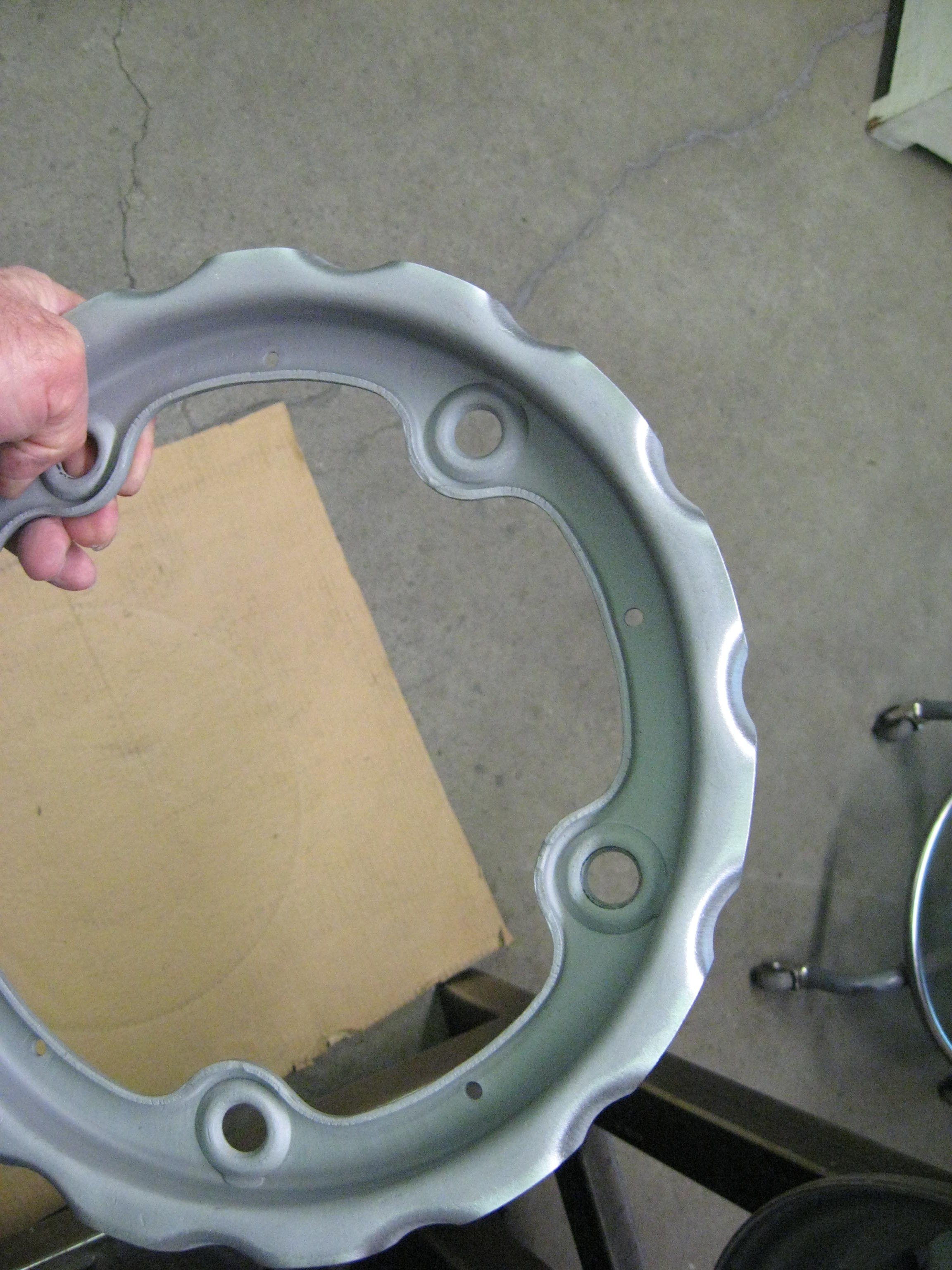

    A couple of years ago I made these for my RPU. I used 2001 Chev. truck spare tire rims. ( they are 16 inch) Hopefully I can get the pics to come up.I had a friend cut the centers out of the pickup wheels with a lathe,reversed the rim for looks, don't forget to redrill a new valve stem if you reverse.The centers fit in perfect,

    That is nice to know that they fit right because a lot of 16 rims are too small. How wide are they?
