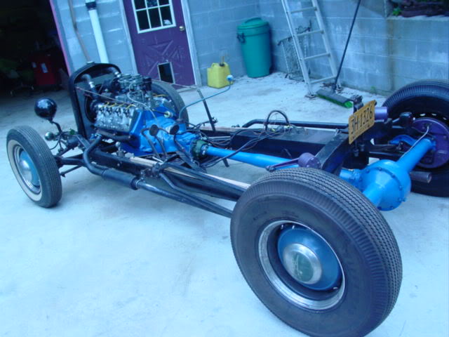

    heres my friends car with lincoln caps.
