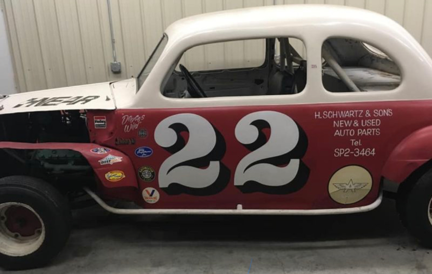

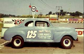

  5. Yes, as @Marty Strode says it is that simple.
    Oval track racers have been doing it for years-
    Charlie Binkley's 46 Ford winner at Nashville Fairgrounds and Huntsville 1962
