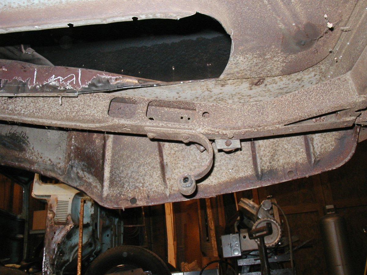

  12. Actual cost runs all over the place. It depends on what you have to start with, who does the job and how far you take it. I've done many different versions of this job and each job has it's own issues. Quoting an actual cost is near impossible without seeing the Car. Once into the job they seem to grow and end up going over quoted price. Rust seems to hide it's severity and always plays a part in more $$$$. There are things you might be able to do that are less involved if it's like a 57 Ford. I've never actually done a 56 but here's a couple photos of a 57 job and just food for thought. I moved the spring hangers inboard and up to have full access to stock wheel house and installed a full 12" wide tire without any work to actual wheel house. Spare tire well got adjusted as needed and re installed. This is way less involved than anything Fatman can supply and you can still drive it and will enjoy being in the car. Not so much for any tri link or four link you can install. I guess I should say,, that depends on what you expect out of your car.
    The Wizzard
    Rear Axle mod 001.jpg Rear Axle mod 002.jpg Rear Axle mod 006.jpg Rear Axle mod 008.jpg Rear Axle mod 010.jpg Rear Axle mod 011.jpg
    Dangerousdan likes this.

    Hmm...I’m working through this in my head but a little stumped. The leafs are in line with the frame rail originally so how are you gaining tire width...wouldn’t the wider tire still hit the frame?
  15. Moving the springs inside gave room for Brakes and U-Bolts and a much deeper rim, not necessarily a wider tire in all cases. In the 57 Ford the Axle bump stop and a Spring check bump. See photo.
    Rear Axle mod 004.jpg You may not have this issue in a 56 Ford. The Axle stop gave up 3.5" more tire space. Moving the hangers up lowered the car 4.5" without using a block on the spring. In your case lets say you can run an 8" wide rim but to do so the center needs to be on center in the Hoop. Now add a 3" lowering block. Now have a Flat tire out on the road. You are in Trouble!
    The Wizzard
  16. I should have added that I did remove the bump stops that are on the outside of the frame rails and relocated them. I need to learn to proof read prior to hitting Post Reply.
