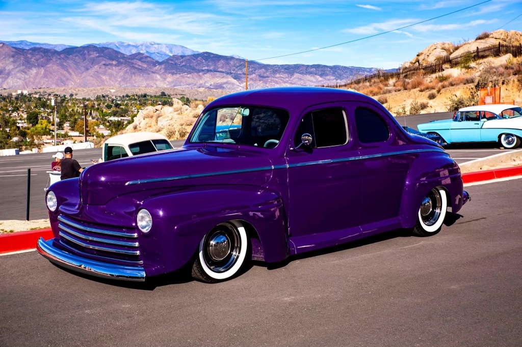

    D7E2323A-D3C1-4AF3-91A1-96FC1CAA71F7.jpeg I’ve had DiamondBacks on my 46 for about 3 years now. They are made out of BF Goodrich TA radials. I have 60 series tires. They have been awesome. Just as white as when new and zero problems.
    I really like the DB’s because the white goes all the to behind the wheel lip and the white part on the front tires and back tires are proportionately equal to each other considering I have “big and littles”

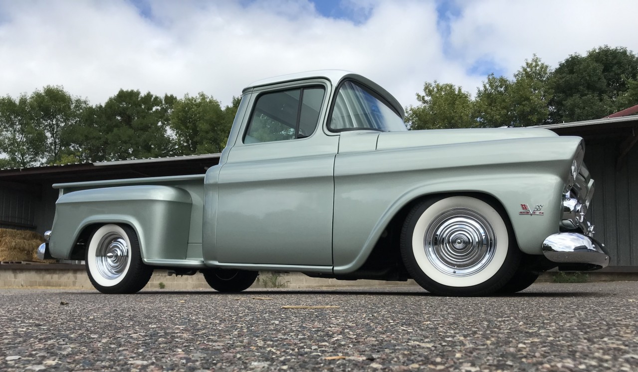

    I have used Diamondback tires on several vehicles, most recently was a set of wide white DBIII's (BFG TA Radials) on my truck. The ride quality and handling are decent, and the white walls are nice and bright.
    As far as tire pressure goes, a lot depends on the vehicle. With a 454 the truck is nose heavy so I run 3 more psi in the front tires, 35psi /32psi cold. On my OT Hot Rod I have to run 18 psi in the rear tires to get full width tire contact.

    I really like this car ! Looks just right, sit's great!

    Thank you for the compliment!!!
    I have owned this car for 40 years now!!!
    I like it too!!!
