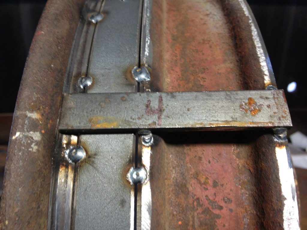

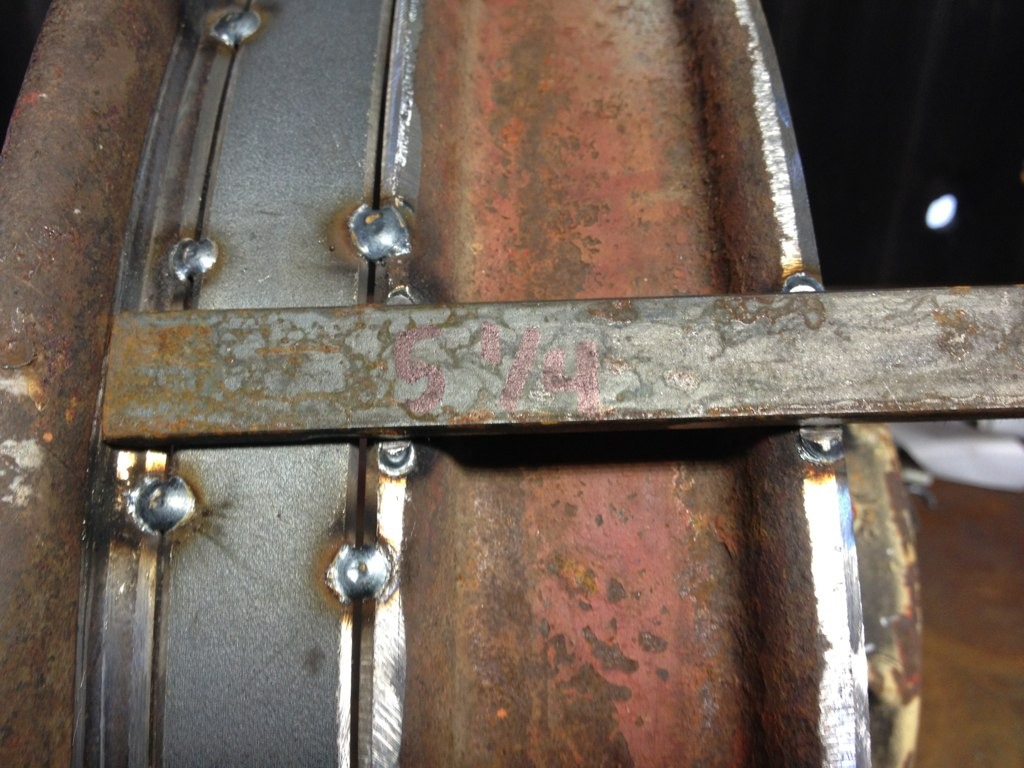

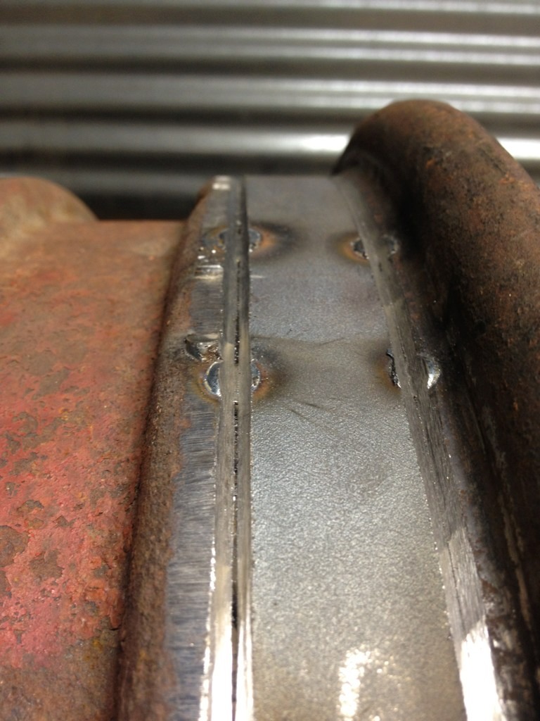

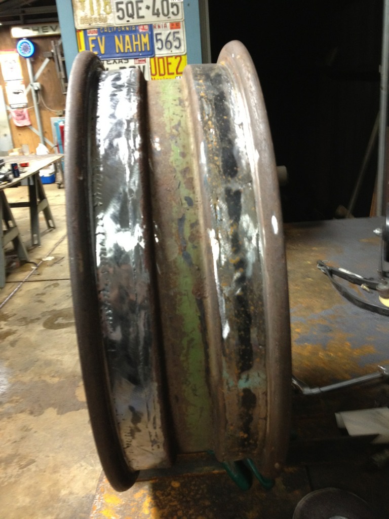

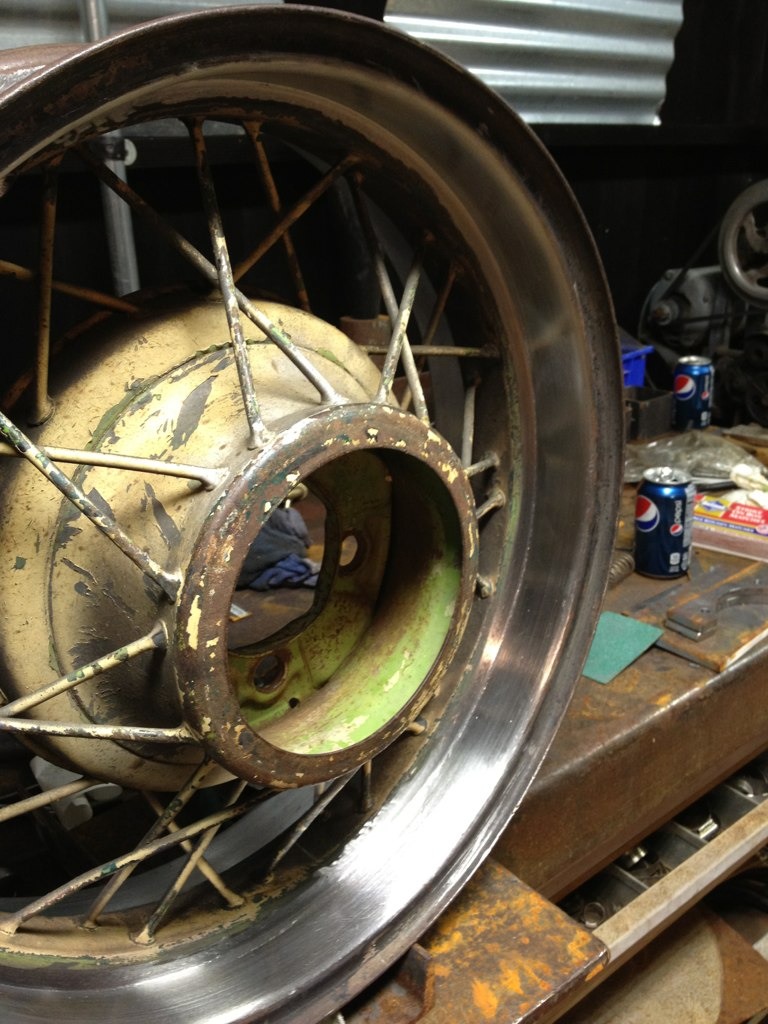

    Anyone ever widen wire wheels? I just finished my first one. At first I didn't think it would be that hard. The easiest part was cutting and welding the wheel back together. The hard part is making sure you have 100% penetration and making it look like it came that way. The best compliment is "what did you do?" I added 2 inches one 1" strap to each side. Going from 3 1/2 to 5 1/2.

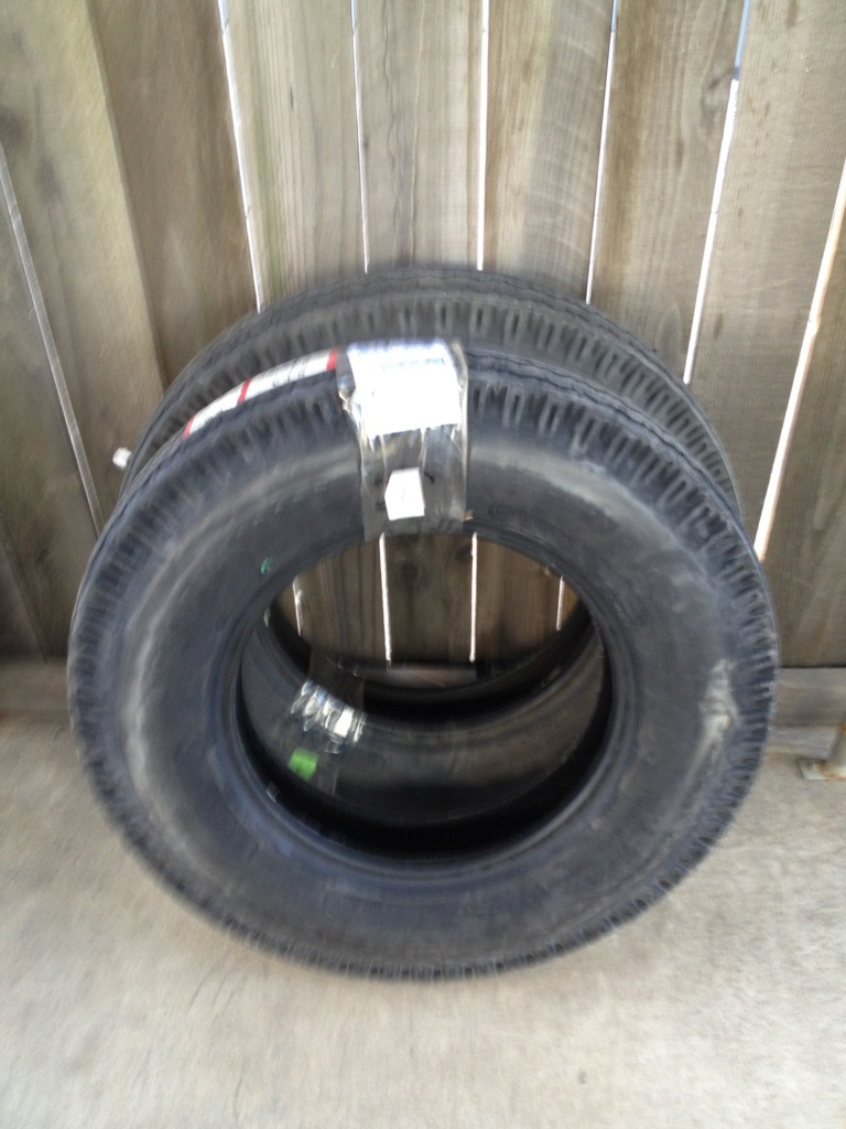

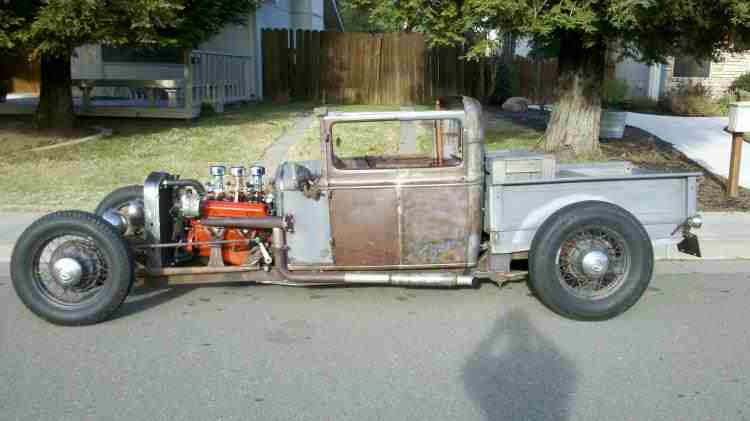

    The wheels were true before I stated. I marked the wheel before I cut it so it would get it back in the same place. I'm putting 750 heavy duty truck tires. The tire should be mounted on a 6" wide rim but I think 5 1/2" is good enough. They are for the rear of my 30xl model a pickup

    Now I'm on to the second one. Now that I know how to do it I'm keeping track of my time. I got it cut and prepped.
    ImageUploadedByTJJ1354845697.728460.jpg ImageUploadedByTJJ1354845777.593598.jpg
  9. You already missed a step.....
    HOW did you cut it, cut-off wheel? lathe?
    weld on.......
  10. percifab
    Joined: May 1, 2010
    Posts: 79
    percifab
    from Dixon,CA
    A big cut off wheel on a grinder. It's a hand full. I had an extra spindle and hub so I clamped it in the vice to hold it while I work on it

    Two words of advice, Next time widen the drop center, you're wheels will be somewhat difficult to mount a tire onto. Also, You didn't take it too extreme, so I think you'll be ok, but widening these old wire wheels is generally a bad idea because they're so weak. The only reason they're usually ok is because they're so skinny they cant get enough traction to hurt themselves, but when you start you widen them, they are a lot more stressed. But like I said, you didn't take too extreme and will probably be ok, but keep an eye on them.

    I made the rings for the wheels today. I bent a 8' piece around a 15" wheel. I made 8 bars and tacked them to the center to clamp the ring to on the wheel. You have you round the corners so they fit in the bead of the wheel. I used the short ones first witch are 4" long. Once I got it all strait and true on the hub I tacked it heavily. Then cut the short bars off and tacked on the long ones that are 5 1/4" long. Bough sides of these have to be rounded to sit in the bead. Then I started on the other side with the second ring doing the something. I got it all tacked together and was about to put it on the hub to weld it up and it rolled off the work bench and broke into 5 pieces. Now I have to start all over again. ImageUploadedByTJJ1355025970.696666.jpg
