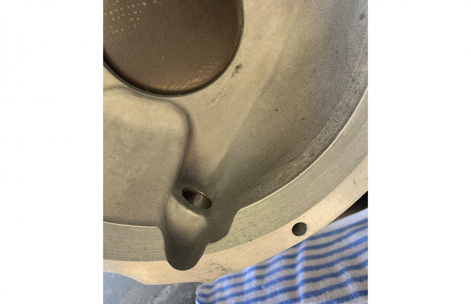

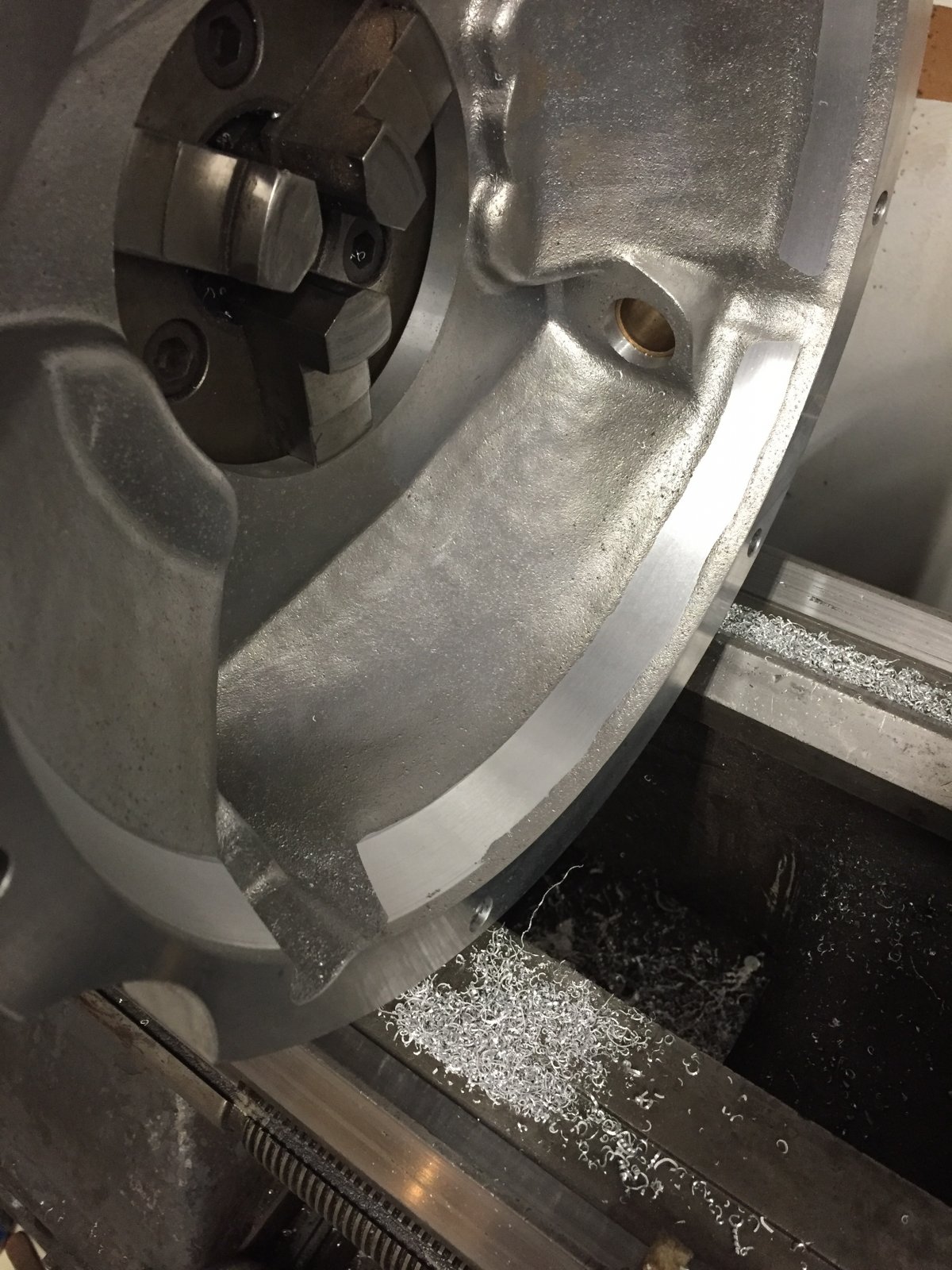

    Not sure of Wilcap’s adapter but on my Offenhauser I had the machine shop take a bit off the inside lip to alleviate any potential problems. From what I understand some pressure plate/adapter combinations may have issues. I decided not to screw around with the possibility of problems now or somewhere in the future and opted to simply give myself some extra 9AE1580F-5F22-4B1C-A6CD-45003A57B475.png 1406AA37-7528-472B-8A01-C7D8B32EC235.jpeg clearance. I opted to machine the adapter rather than cutting off counterweights.

    11 5/8” dia. At top
    10 3/4” dia at bottom
    7/8” deep
    I got these measurements from a post here on the Hamb by “Hot Rod Pro” who regularly did this modification.

    18F352CD-A4F1-4E8D-8B8A-1EFCAE633C4C.jpeg I had to trim my adapter for the counterweights. I personally wouldn’t cut them off the clutch.

    I had a hard time finding a machine shop willing to taper cut the adaptor with the given dimensions.
    I tried about 5 local machine shops, 4 of those turned me down right away, and only 1 was willing to try doing it but offered a straight cut for $250...didn't give me that feeling of confidence, so I walked away.
    Opted to do the 35 miles drive to Vellios in Lawndale. I have use them before for other things. They looked at it and didn't even hesitate. He knew what I needed and what it was for. Confidence!!!

    It about the same as what the other guy did above. Not sure why the extra material was even there its a non essential area. Its about 3/4” wide there and was about 1/4 tall at the highest point. You could have sent it to me and I would have done it for you. Doesn’t take very long, just need a big machine.

    Happy ending to this story. I got the adapter back from Vellios yesterday, and they did an awesome job with it.
    Followed the clearance amount provided above and it gave plenty of clearance to the counterweights.
    Best part, they only charged me $75...huge difference from the first machine shop that was asking $250
