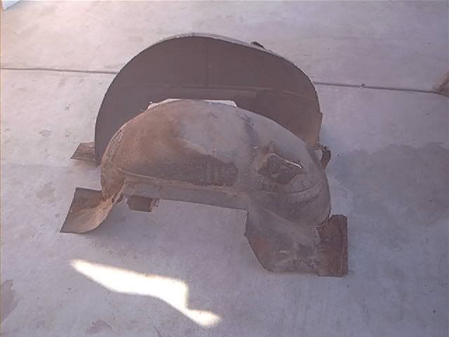

  12. Here are some more pics if cutting and modifying the body. This rear floor section was removed...
    ...then this section will be moved forward to mate with the floor in front of it. If you see the cut out plate sitting on the floor in this pic, it is a header flange made for my Pontiac HEMI heads. Do not remember why it was there, probably using it as a straight edge.
    This is the area with the wheel houses cut out. Once this floor was moved forward, the quarter windows are no longer operatable.
    Peeking in through the outside left wheel lip area.
