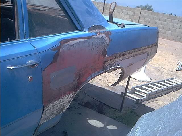

    Here is my friend Bill, a few decades my senior, starting to weld on the car. Now, I was not comfortable with him gas welding the quarters. I knew it would make a mess, and it did. Bill is a smart guy with a lot of experience but, I am no beginner either. sometimes Bill and I would differ on they way certain things were to be done and it would cause some friction between us . Still, it was my car.
    I kept telling Bill we should mig weld it. Finally after much effort, I convinced Bill to mig weld. I have a nice Miller machine and showed him how simple mig welding was. Later, he became a believer in wire/mig welding.
    I ended up doing all the final welding on the car after he tacked stuff together. Later, I also ended up doing all the finish body work as well. Still, Bill deserves very much credit in helping me build this car and I am grateful to him .

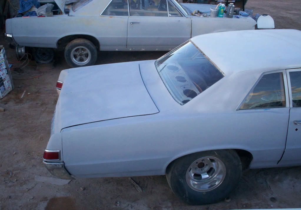

    Here is the left side going together
    This picture shows clearly how much was changed from stock. As before, a stock '64 GTO is in the background ( same as '65 Tempest wheelbase). Many altered wheelbase cars do look kinda' goofy ( funny I guess ) as their body lines do not look right. It is my opinion that this change actually looks better than stock, or at least, as nice as stock. I am very pleased with the amount of rear wheelbase change and think.
