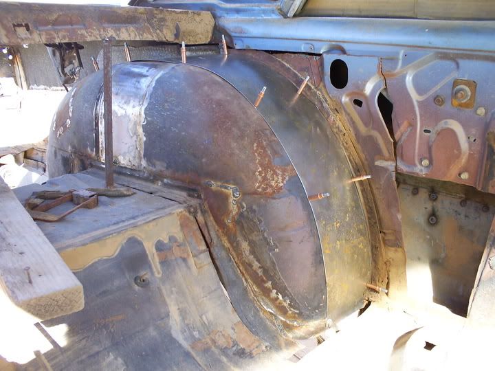

  19. Here is more of how we did the wheel houses on the Tempest.
    Hosting- 14th annual Pontiac Heaven March 30-1 Phoenix www.pontiacheaven.org

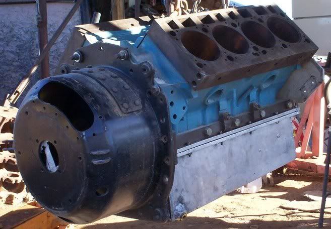

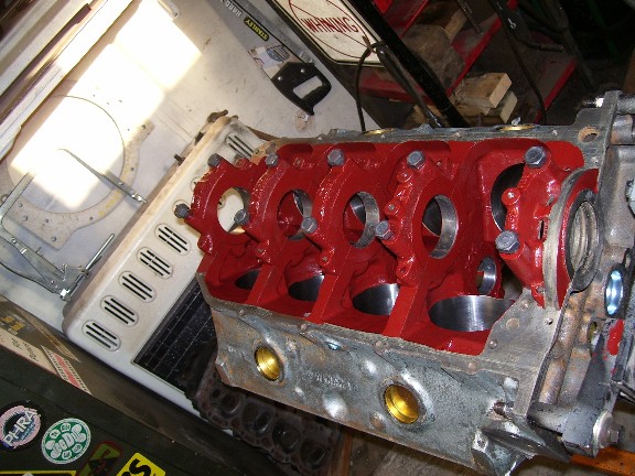

  21. Here are some mock ups of the 577 being fitted into the ch***is. These are test fits, etc.
    The block and deck plates shown are the actual 577" parts. You may note the differences in the earlier posted set of plates. These are more finished.
    You can see the gun drilled cooling holes that run the length of the plates under the exhaust side. They are tapped and have allen plugs in there for now. Note also the larger counter bores where the head studs would be. They are bolted down there with 1/2" thread allens. You can also see the drilled and tapped thread holes on the valley and exhaust side that will mount the external bracing.
    The clultch can is a Lakewood SFI 6.3 spec for a Lenco.
    Hosting Pontiac Heaven March 30-1 Phoenix www.pontiacheaven.org

  25. Here is another pic of the nock up short and bell going into the ch***is. You can clearly see the counterbored holes where the stock head bolts go. The deck is 2" thick, the counterbores are 1 1/2" deep leaving 1/2" of material for the allen head bolts to secure to the block deck. There is about an inch of depth left above the allen bolts. One of the next things to do on this engine project is to mount it in my larger mill flat to the deck. Then will be tapping these counterbores,. I had special thread inserts made that will screw in these threaded holes. The ID of these thread inserts is 9 1/6" which will be the size of the head studs.
    Once this job is done ( not sure when I will get to it ), then the block can be squared decked. Once I know that, I can order my pistons. I have the rest of the lower end parts- Crower billet crank and rods, oil pump, etc. After that it will be balanced. I can imagine the balance job with be quite extensive! then, it goes together!
    This is the right quarter with some mudd now on it. This side ended up needing more filler than the other side due to the gas welding. Its just a race car anyway, not going to be a mint flawless show car.

    What a great build you got going. It seems to me that block
    would have to be sleeved, so that there is no part line between block
    and plate. Is that correct ?

  27. Yes,
    The sleeves for the 577" were custom ordered to my specs and are the full length from the bottom of the cyl to the deck. There is no parting line where the cyls are.
    Am looking for pics I took back then to share. I remember taking pics with the custom sleeves next to a stock replacement sleeve.
