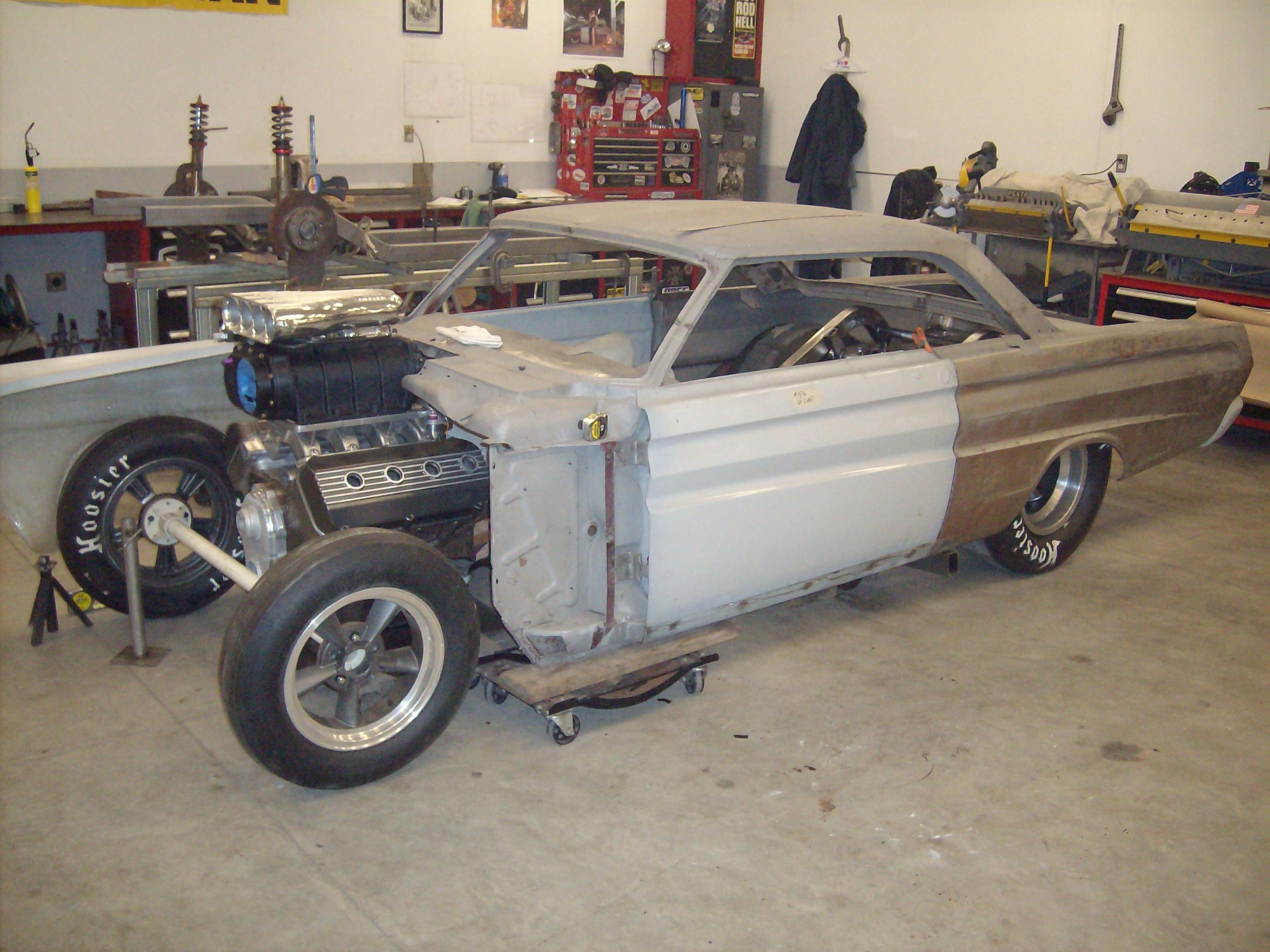

    Here are some pics of the left side...
    The other day picked up the re drilled brake rotors. Checked on the rear parts, no progress with that :( will have to motivate them or bring it somewhere else.
    The custom magneto is now finished and should get here any day now.
    Still not sure which engine will go in first- 428 with 6-71 or 541" with 14-71

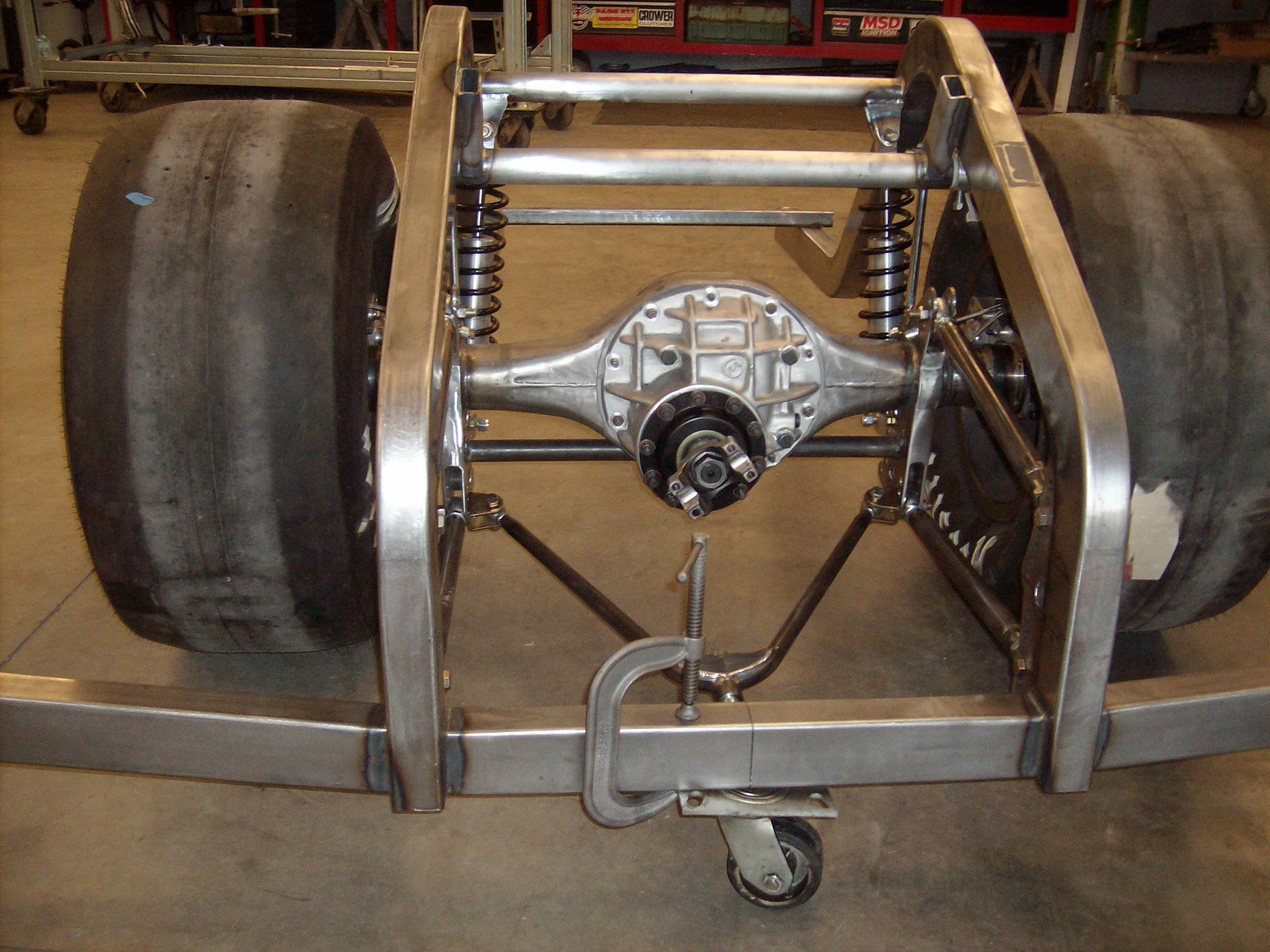

  7. [​IMG]
    Now, will cover the frame mods, then later, the rear end and front fenders.
    We actually modified the rear of the frame first with the body off of the frame but, going the show the front work here first.
    After much thought and many ways to do it, I decided to extend the front wheelbase 5" and leave the engine in the stock location.
    Here we have the front frame clip cut off and the retangular tubing fitted.

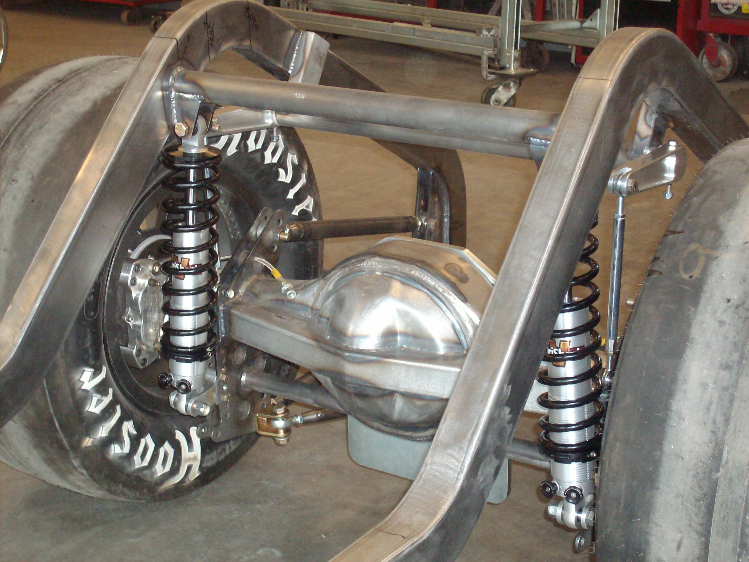

  10. There are 2 rears for the car- both use the same housing and brakes
    Street set up is a 3.90 posi with 33 spline billet axles
    Strip set up is 3.64 spool with 35 spline billet axles
    This are the big Pontiac 9.3 rears

  18. Well, like many projects, this one is taking more time than I would like. It's not the only thing I am working on though so, am happy it is moving forward.
    Now, both of these early Pontiac 9.25" rear ends for the Funny Car, street and strip, are ***embled and ready for use and abuse.
    The race set up is a 35 spline spool with 3.64 R&P, billet axles with 11/16" drive studs
    The street set up is a 33 spline posi with 3.90 R&P, billet axles with 11/16" drive studs.
    Both have billet yokes and all the right parts. They will be used in the same housing. I'll get pics of that in the future. It'll not only have a rear brace but, a custom front brace to support the carrier housing itself. It's another idea I have pondered up.
