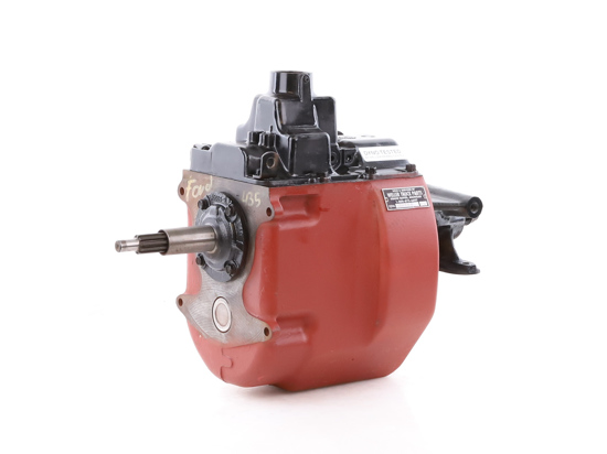

  1. Putting a 289W in my 47 Merc, thinking about using an F100 new process 435 four speed behind it because of the shifter position with the origional bench. As the Merc engine bay is longer, will the box fit without cutting up the crossmember too much? Many others done this?

    Big truck granny low four speeds are not really hot rod transmissions...you won't find many in cars, probably close to zero.
    It might fit, if you make room for it. And the car isn't lowered very much.

    I ran a NP435 behind the 351W in my '51 F-1 for quite a few years. 2nd gear syncro finally went out and it got replaced with BW 3spd+ OD out of a Galaxie.
    Don't make the same mistake I did. That is a transmission best left for medium duty trucks, and that is about it. Lots and lots of better choices for a late edition 289 (***uming you have the later "standard" Windsor 6 bolt bellhousing.)

    The Granny low in the NP435 is useless in a car. Gear ratios in the NP435 are =
    The ratios for the Ford NP435s are: 6.68:1 First; 3.34:1 Second; 1.74:1 (or 1.66:1) Third; and 1:1 Fourth with a 8.26:1 reverse. NO overdrive on that trans.
    The only time you would use first gear would be crawling in traffic going into out of big rod trots where the slow gear might be useful.
