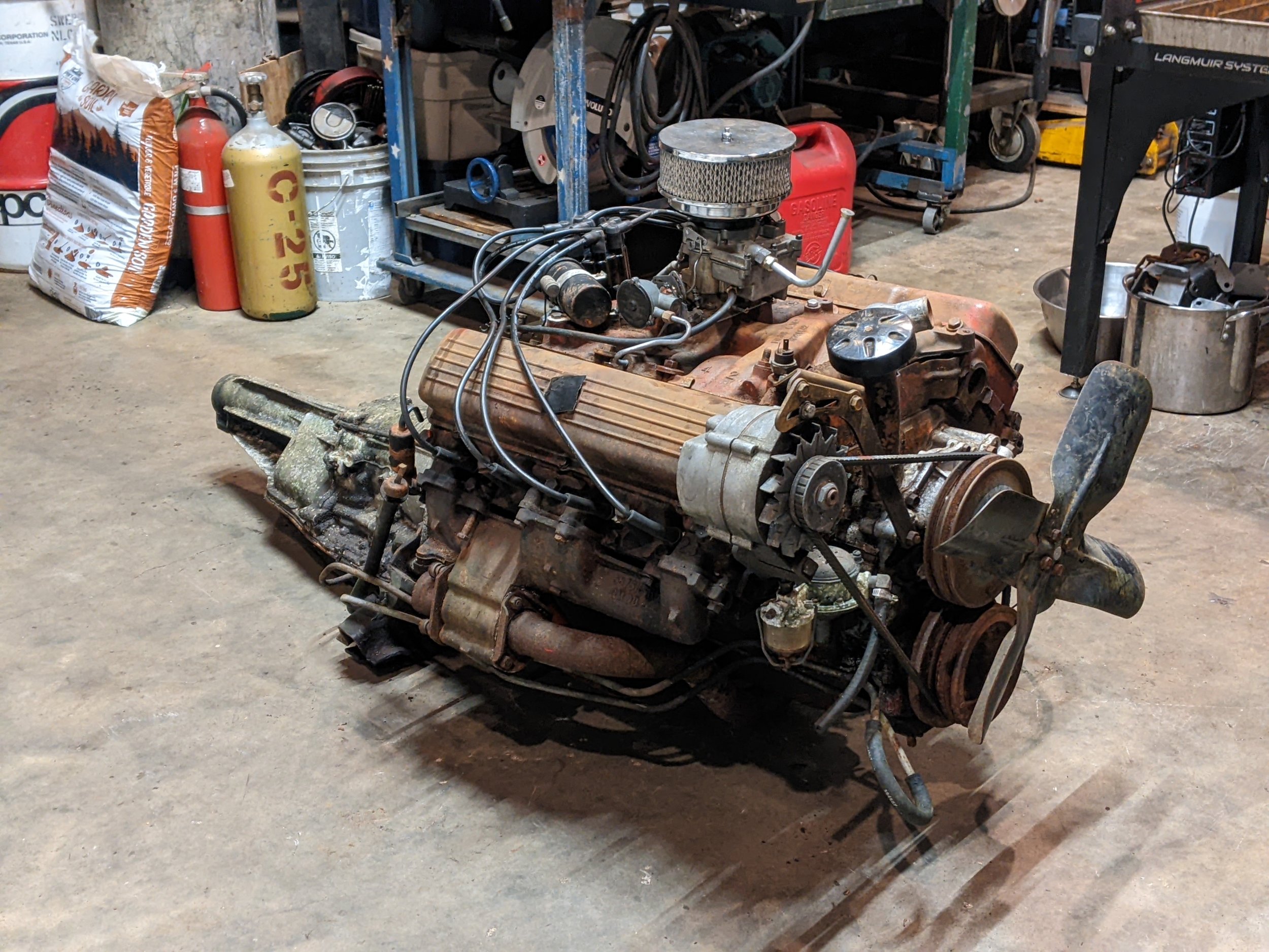

    I have been wanting to build another run stand,
    so this seemed like a good time to do that.
    again, back to the misc parts and materials stash
    and put together a basic stand,
    this one is for now anyway Olds specific,
    to mount other engines will require modification,
    not a big deal.
    I hooked up water temperature and oil pressure gauges,
    found an NOS fuel pump in my stash I'd forgotten about! that was a happy find.
    mounted the engine and ran it

    Is that a model A radiator on the run stand?
    Moondog13 and Sharpone like this.
  16. Paul
    Joined: Aug 29, 2002
    Posts: 17,206
    Paul
    Editor
    yes it is, non pressure, in fact I don't even have a cap for it right now, it's my only spare radiator that doesn't leak!
