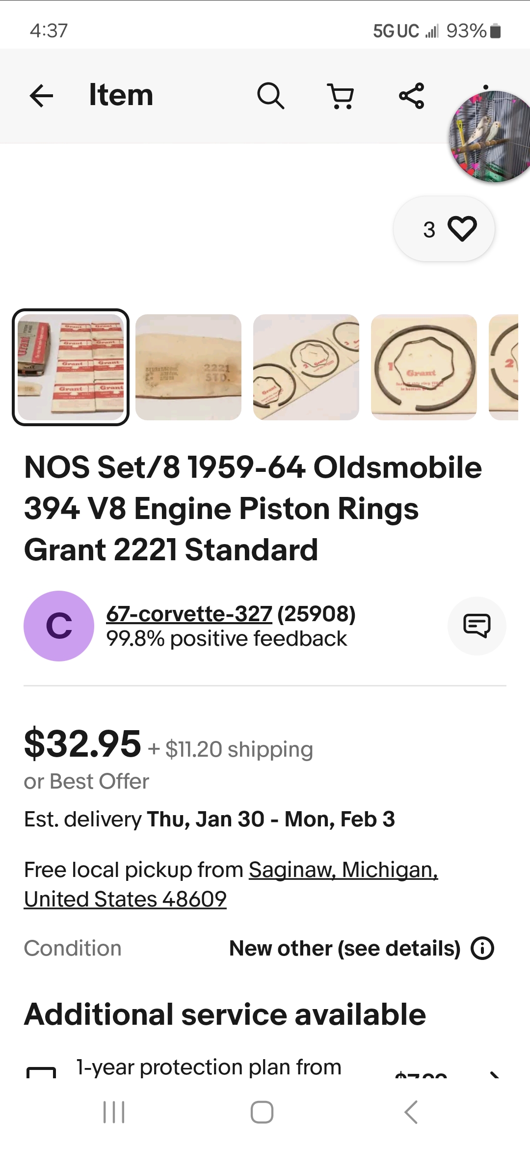

  4. Sharpone
    Joined: Jul 25, 2022
    Posts: 4,780
    Sharpone

    I think this thread illustrates how eBay's functionality has changed over the years. I used to troll for underpriced vintage speed equipment. Now, I mainly use it to look for "off-beat" stuff and generally do all right. I still troll, and once in a while, pick up something good, but it has been few and far between lately.

    Yeah, about the only time I luck out on old speed equipment any more is when the seller has incorrectly listed it, as in saying that it fits a Y block when, in reality, it fits an early Olds V8.
