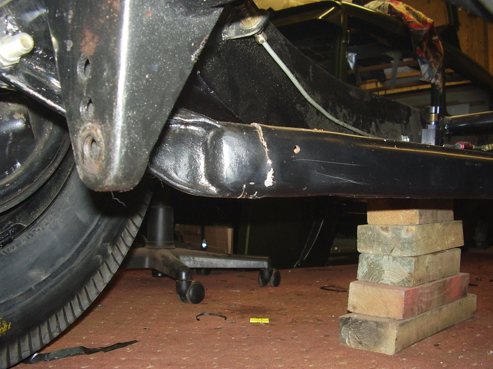

    This was a under my Sedan when I got it. Similar set up, catastrophic failure imminent......
    winduptoy and Andy like this.

    :eek: I'm sure glad I consulted this group! I'm up to my ears in the DeSoto so I'm not looking for another "project". Really hoping to find something that I can get in and rip on the highway with no concerns. Hopefully the right roadster shows up soon, but appreciate everyone's input on this.

    I learned the hard way a long time ago that rear suspension set up with that geometry will break somewhere sooner or later. Lucky for me, I noticed an odd characteristic with the ride before anything fatal happened. Early Fords had ONE suspension point in the front for a very good reason.

    It applies to the front with a tube axle. A Ford front axle will twist just fine.
    I was at a run and looked at a rear end set up. The arm bracket had ripped the housing open. I stuck my finger in and could feel the axle shaft.
