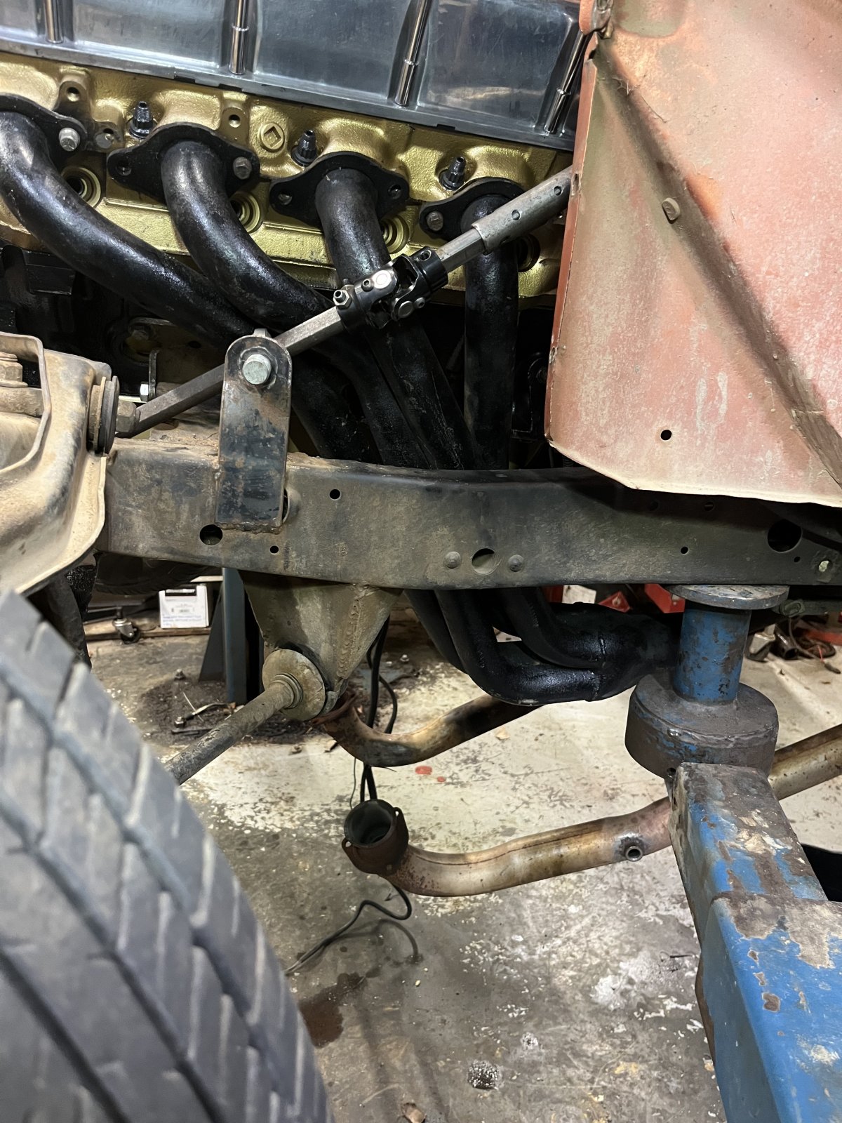

  1. I switched the power plant in my Willy’s coupe to a big block Chevy.Ive tried about 6 pair of off the shelf headers. I found a set of cheap built, rusty ,bent flange old headers that I’m guessing to be 67-72 truck headers for a big block? I’d like to buy a new set now that I’ve found something that fits.( Once I moved the steering ,fuel line,trans cooler lines. ) Any of you guys recognize or care to guess what brand or application I might have here. No identifiable markings.. or what have you used with success inside the frame rails? Thanks gents.

    Headman /cyclone . ( or at least they look very close. ) I used a set just like them on a 56 pickup. I had to cut one tube and customize one tube for around the steering box.

    Takem off and take them with you if you can. I’ve done that more than I like to admit.And yes I think those fit from 64-86 c-10/square body trucks ch***is is same other than intro to disc brakes in 71-72.
