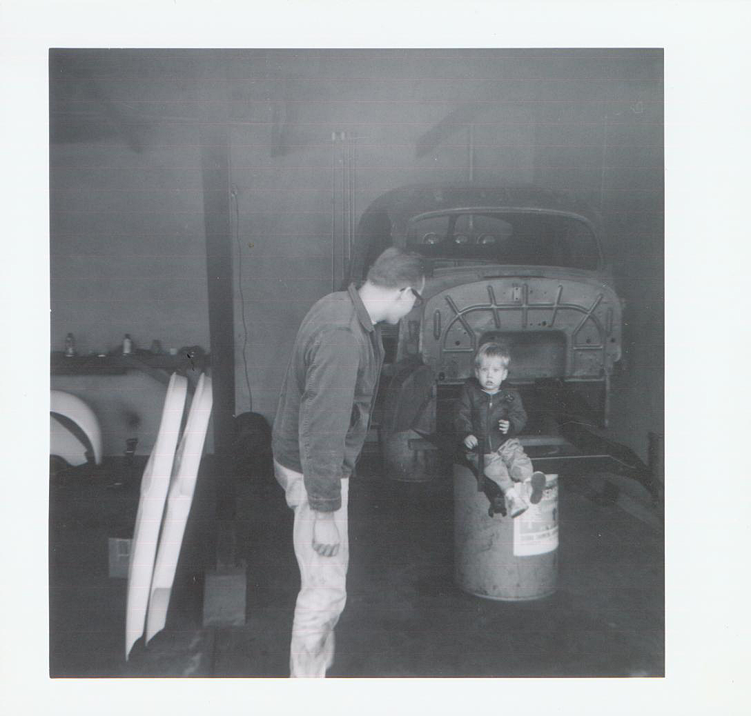

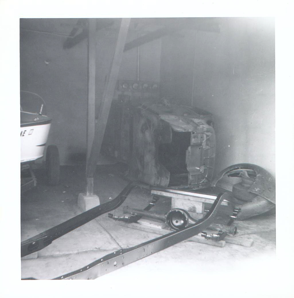

    Progress was slow at first as Dave worked at the Midas Muffler shop in Sacramento and money was tight. The project got kick started in Dec. '64 when his wife surprised him for Christmas with a complete Kellison Fibergl*** Racing Kit consisting of a '41 gl*** nose, doors, trunk and rear fenders for the car.
    The body was taken off and the frame was cleaned reworked and painted with no rust paint. Dave took the frame and boxed the front, and added his trademark oval lightening holes to the rear part. It was very time consuming as he would torch the holes, then drill and grind the holes into oval shapes, one at a time. Pontiac Olds rear with Ford Truck springs were added. More work to the body with firewall removed, floor work, etc.
    By August '66 the body/frame were back together and he started to concentrate on getting the transmission and engine for the car.
    (see pic with Dave's '61 Pontiac Ventura)
    Stay tuned for the next installment!

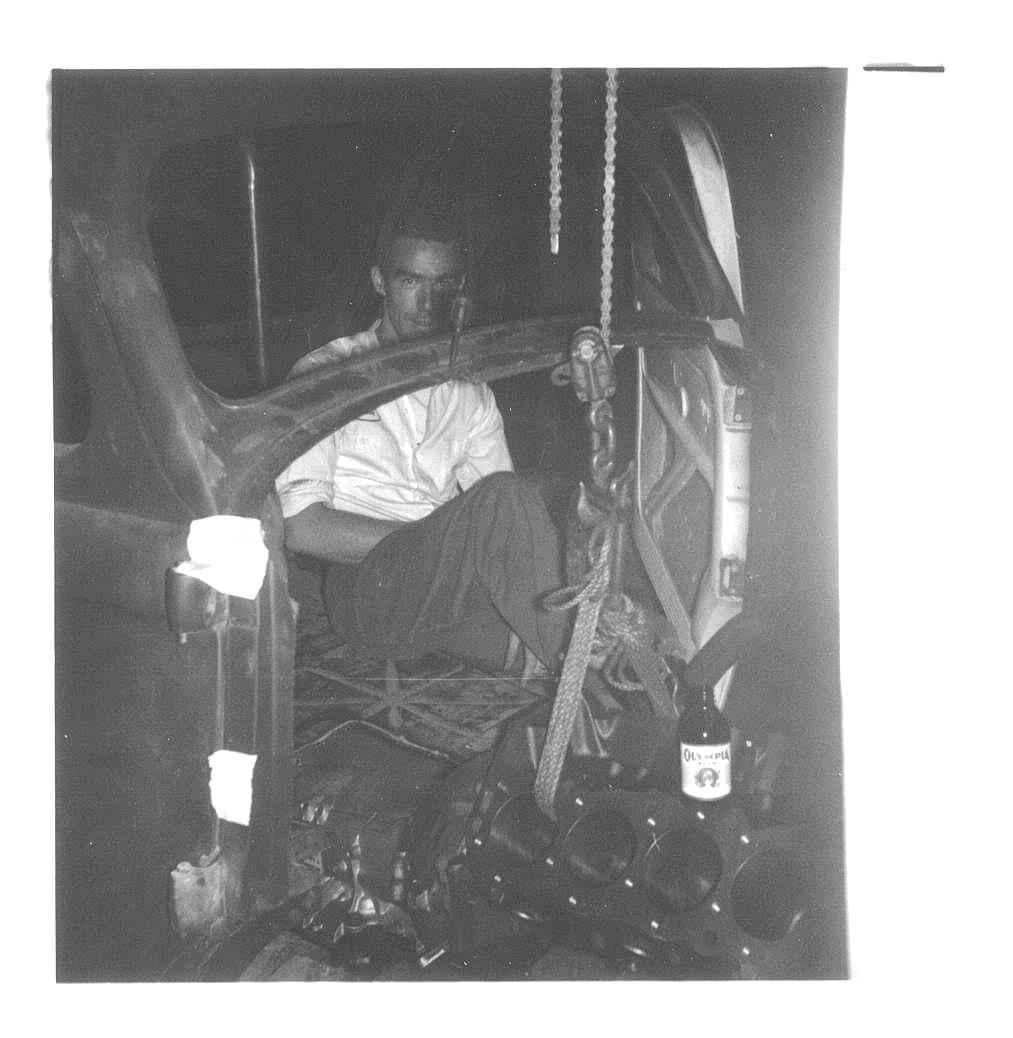

    More work continued into '66-'67. Here's the delivery of his ****** and 396 BBC engine for the Willys. The car would soon have one even coat of primer as it got closer to it's debut at Lions in '68.

    Here's some shots of the engine mounts being made for the 396. Starting to get primer on the car here too.

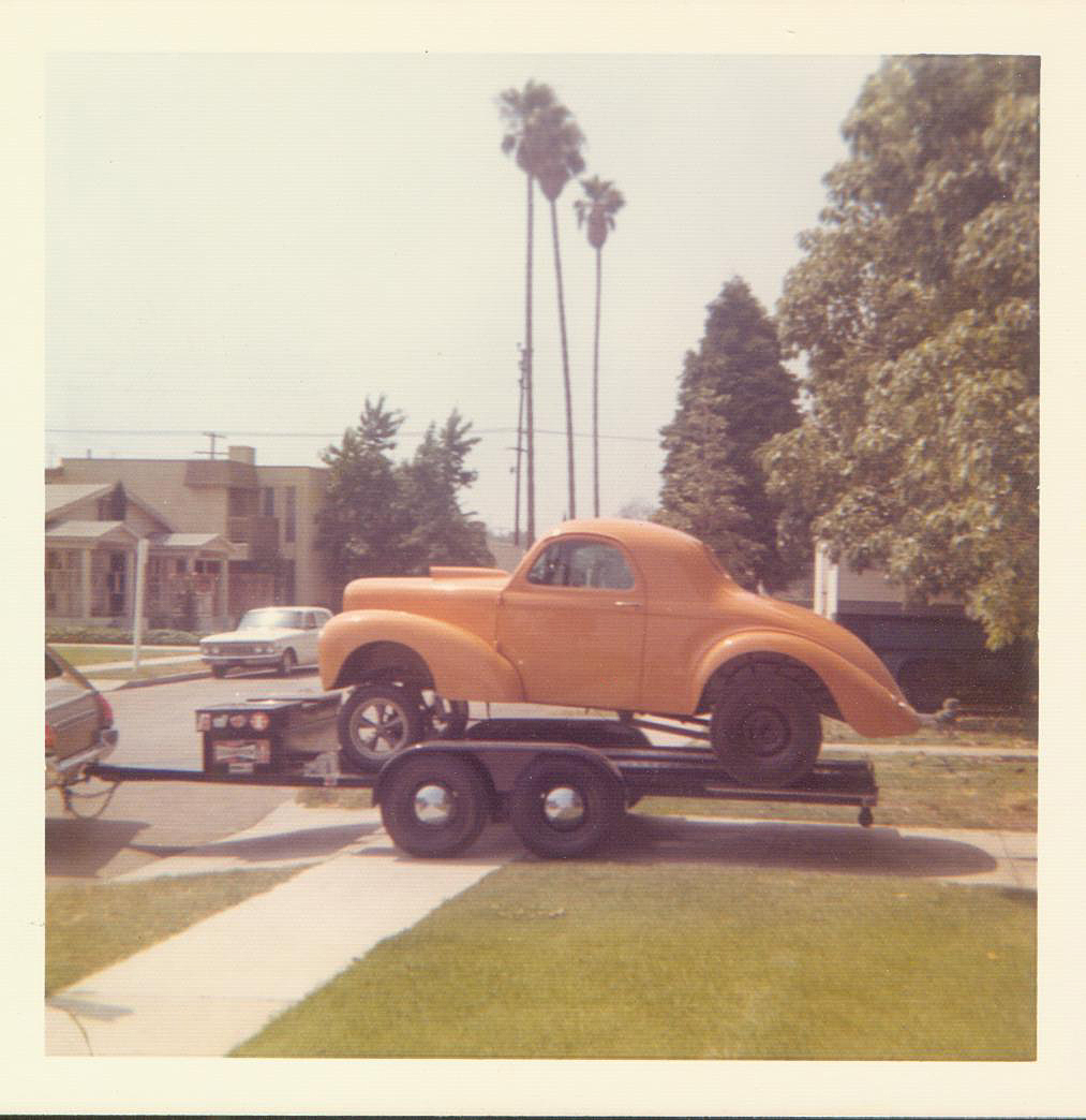

    Looks like the Willys was painted orange sometime in '73. The pics dated Dec. '73 show the progression from all steel wheels to first the American spindle mounts up front, then to the full magnesiums with the rear big windows added by Dec. Note decals are being run on the car by then as well. Also, the trailer was upgraded to a dual axle.

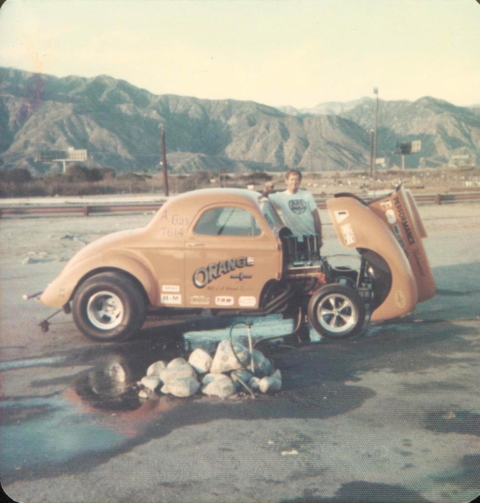

    The Willys was raced alot from '73-'75 or so. The Orange Plus name on the car appears in pics dating back to early '75. Dave received trophy for best appearing car - think this was at Irwindale Summer '75. Dave lowered the front of the car and the mph responded breaking over 140 MPH during this period.

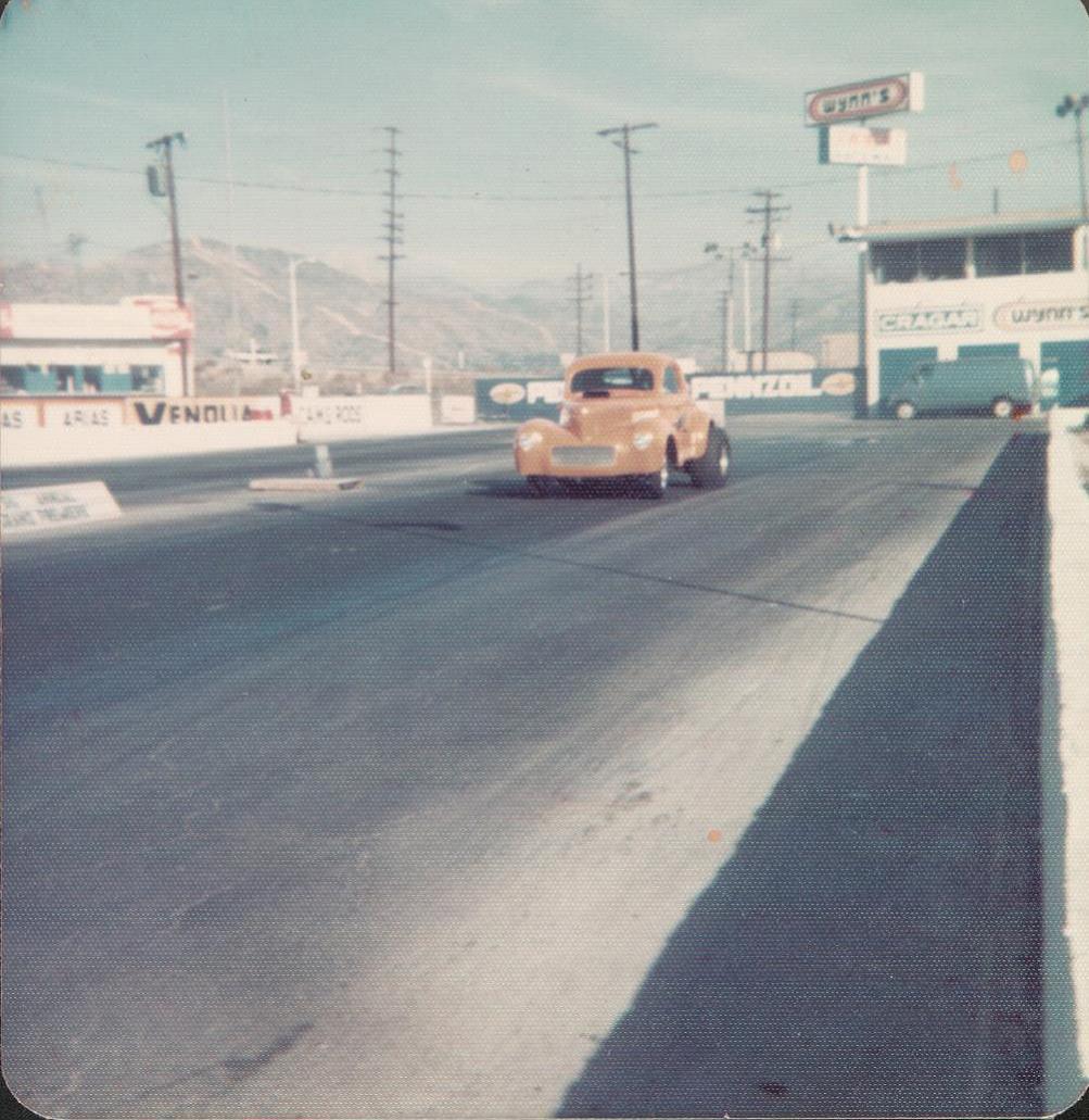

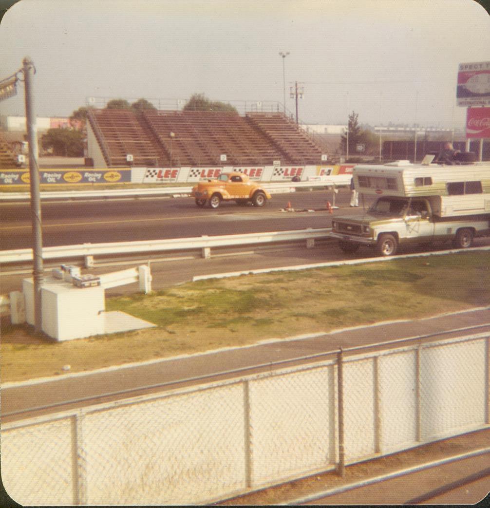

    Here's neat pic from Antelope Valley Dragway from the 70's.
    Another launch from Irwindale.

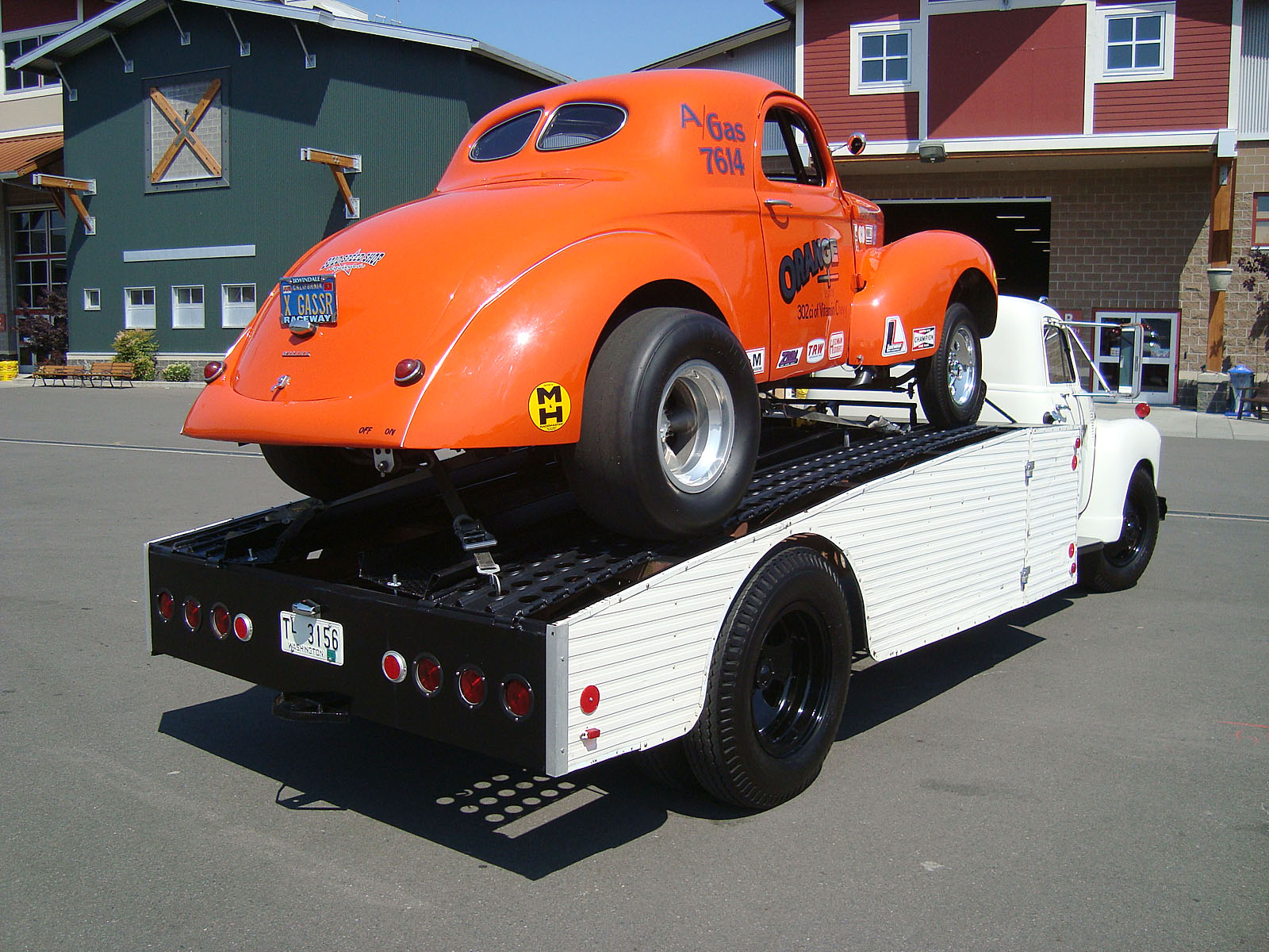

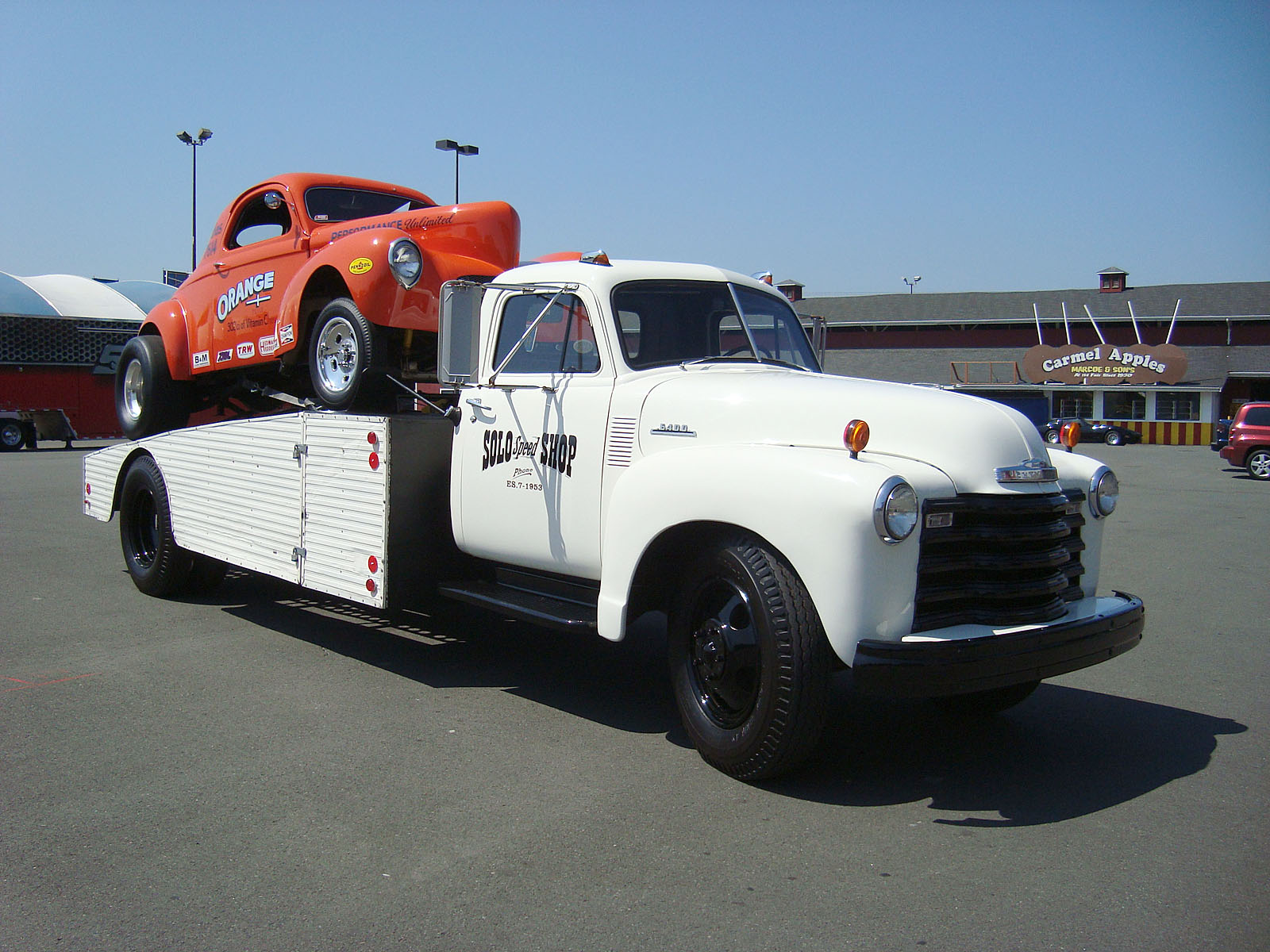

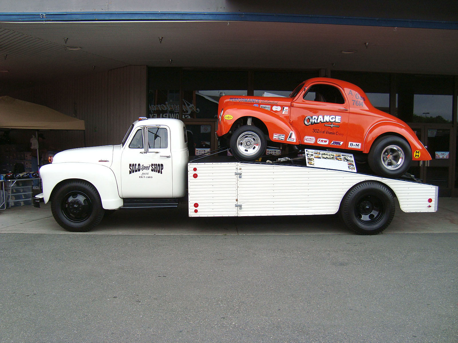

    The Orange Plus will be spending time up here in The NW this summer and been fun taking around. Got the new baffle setup for the exhaust and sounds very wicked. Not much restriction which means LOUD, especially at 3500 rpm and above...but love it! First time out for any extended cruising was to the local cruise in here in Bremerton, WA in July. The car hadn't been on the road in at least 10 years so there were bound to be issues. The rad was blocked so ran pretty hot, and had a pesky oil leak coming from back of the intake. Redid the rad and lifted the intake and new gaskets/resealed and now good to go.
    Next was able to make it out to Goodguys event at Puyallup, WA. with my ramp truck. Had it out front next to our booth there. Great fun talking and meeting alot of cool folks that dig these old cars too.
    Last weekend was able to take it up to Mission, BC Canada for the Old Time Drags. Had it on back of the ramp truck for the 200 miles up and 200 miles back having a blast. Great time up there with awesome cars, racing and those great Canadians.

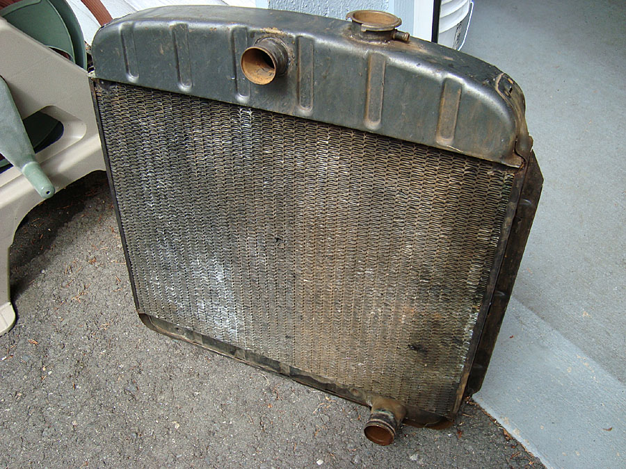

    When I tore into the top end to fix the oil leak and get rad fixed found some cool stuff.
    Radiator I believe is the original one Kiwi Kev put in back in '84!
    Check out the roller lifters and Isky Rev kit as well. All looks really good inside. Put a new bronze dizzy gear on as well. The engine runs one of those Isky Reverse Rotation (backwards) camshafts. Has the two gears up front like a gear drive and the backwards cut dizzy gear so the firing order is the correct 18436572...pretty interesting stuff.
