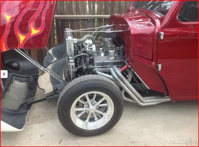

  25. My '36 had to have firewall removed to fit the hemi. On my friend's '39 pickup, we inserted a portion of a wheelbarrow for room for his SBC but leaving enuf stock firewall room for feet.
