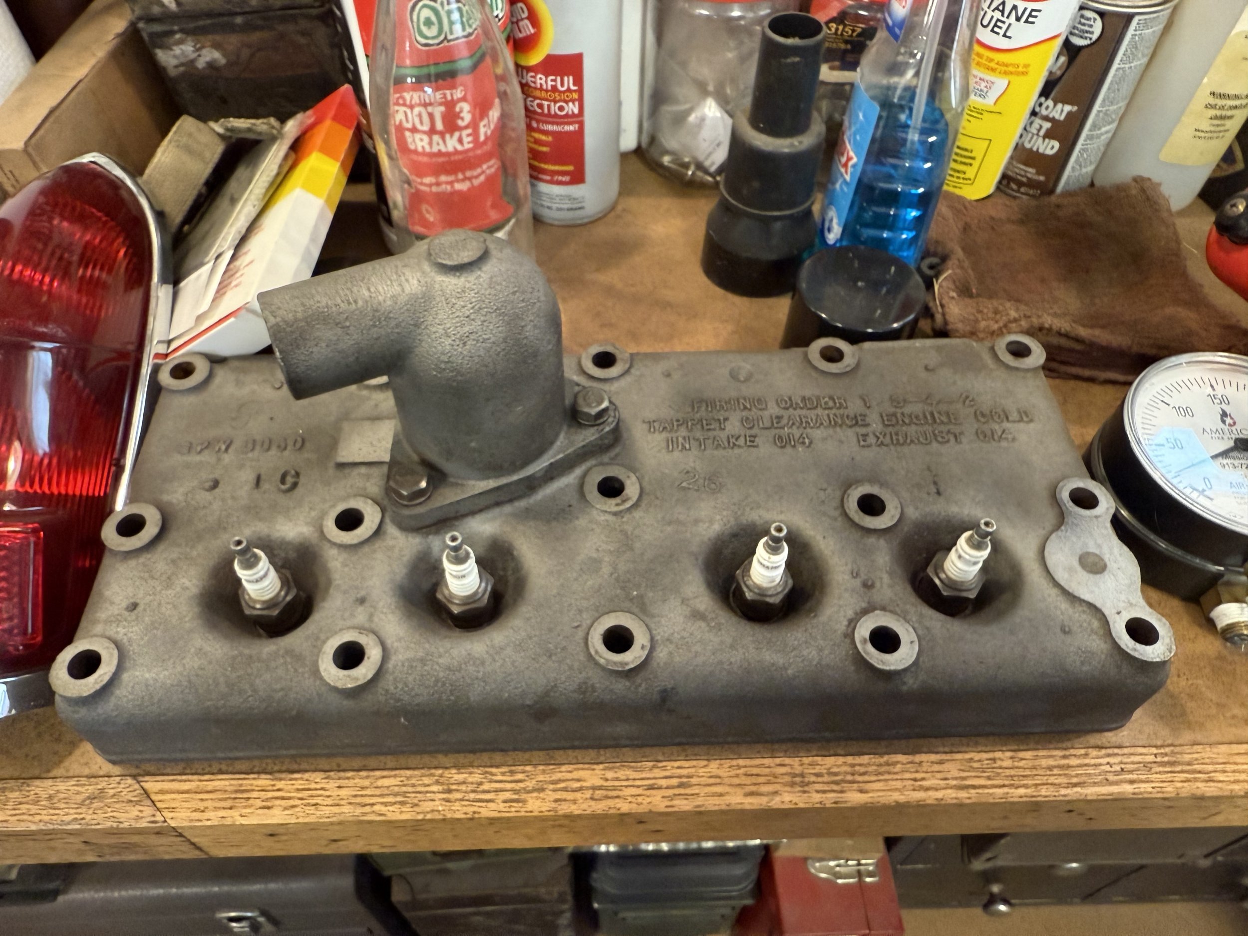

    Great looking Go Devil.....what is that cylinder head.....it looks aluminum ?

  8. I’ve got a low compression industrial head if you want to supercharge it:)

  10. If you get a wartime head, it won’t say Willys. If you get one out of a GPW it will have an ‘F’ on it since it was made by Ford! Go for it!
    I just put an MB together with an L-134. Great little motors!
