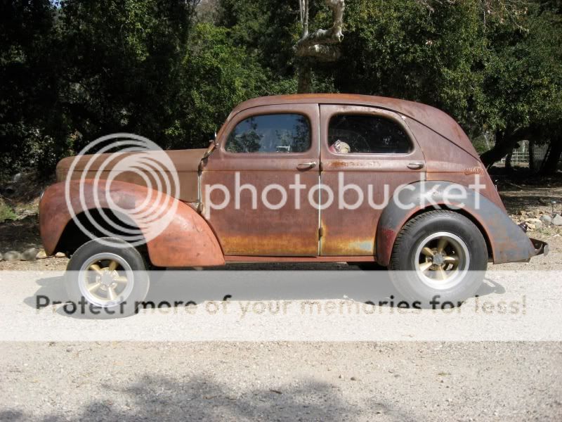

    What Dave says. I have a 1941 front clip fitted to my '39 sedan and the wheelbase is fine. The problems start when you try and use 1941 coupe fenders on a 1937-1940 willys coupe or sedan. the wheel opening on the 1941 fenders is moved back over 1" when compared with 1939 Overland and 1940 - even though the wheel openings on 1939 Overland and 1940 rear fenders look almost the same.

    my coupe is a 1939 model 39 with a 41 front clip. It bolted right on and the wheels were centered up. I'm using a stock front end and springs.

    Looks like the fronts have a little issue with centering... My 40 has a similar problem with the driver's side seeming to be more to the rear of the opening. Is there a better market for particular year rear fenders?

  17. Looks like the fronts have a little issue with centering... My 40 has a similar problem with the driver's side seeming to be more to the rear of the opening. Is there a better market for particular year rear fenders?
    I have found fenders on original cars and the wheel openings didn't match from side to side. Opening was anywhere from a half inch to an inch bigger on one side...and no they weren't the bigger opening style 37-38. Incidentally all Willys rear springs are the same size eye to eye (46 ", or there about,looking for my factory data sheet,) so the factory just changed the location of the center bolt when it changed wheelbases on the different years. My theory is their fender dies wore over time, as they did their stamping. There is one constant with Willys cars...the factory had little quality control in those days, so anything was possible.
    g-willys
  18. Here's a 38 body with a '39 nose,... 39 rear fender on one side, and a 40 rear fender on the other.
