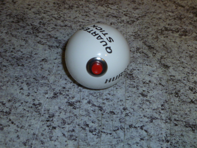

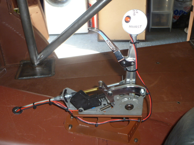

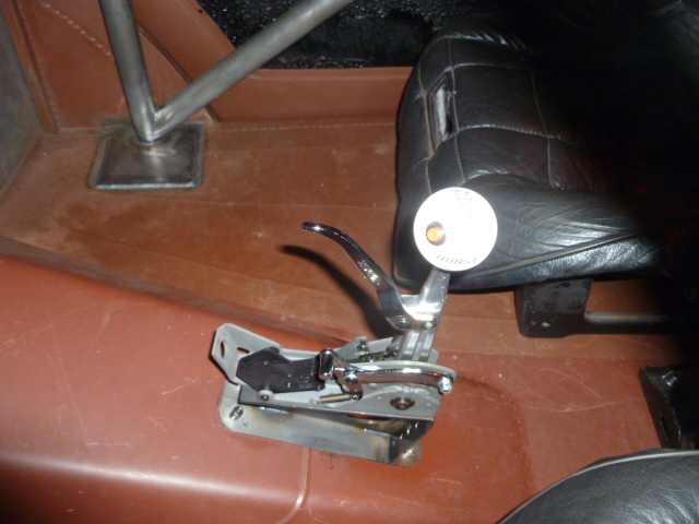

    I've been pondering what to do for a line lock switch and usually put a push ****on on the steering wheel but didn't want any cables hanging around, the obvious choice was the shifter but I didn't want to change the Hurst quarter stick shift knob so I marked where my thumb would go and drilled and counterbored it out then put a small hole in the base for the wires to come through, didn't cost a thing as I already had the switch and Ive retained the original look too.

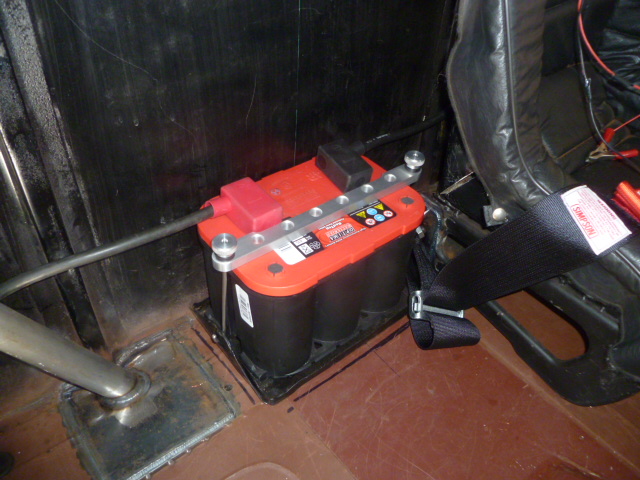

    Decided to relocate the battery inside the cab after consulting the rule book and finding out it was perfectly legal to do so, this tidies up the pickup bed as I don't want to run a tonneau cover, not the best for weight distribution but will compensate for that by adding a weight bar at a later date.

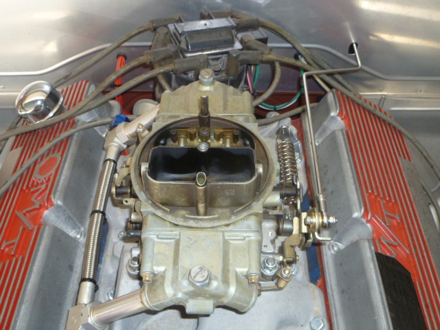

    Also made a gas pedal linkage from 3/16" stainless steel rod with rod ends each end for smooth operation, I prefer rod linkages to cable as I think they look a lot neater and have a more positive feel.
