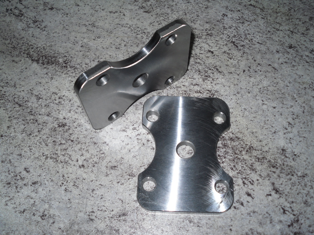

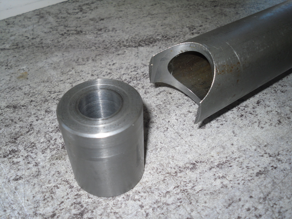

    First thing I wanted to do was change out the drop tube for a straight axle, I made one from 2" o/d x 1/4" wall dom tubing during the year and have finally got around to finishing it off with shock mounts and new top plates for the springs.
    Trial fitted it today and am pleased with the look, it's raised the front only an 1" or so as the original axle had blocks under the springs.
    Next job will be to make some aluminum hubs to replace the old Chevy ones which will look a whole lot nicer and will lose a few pounds too :)

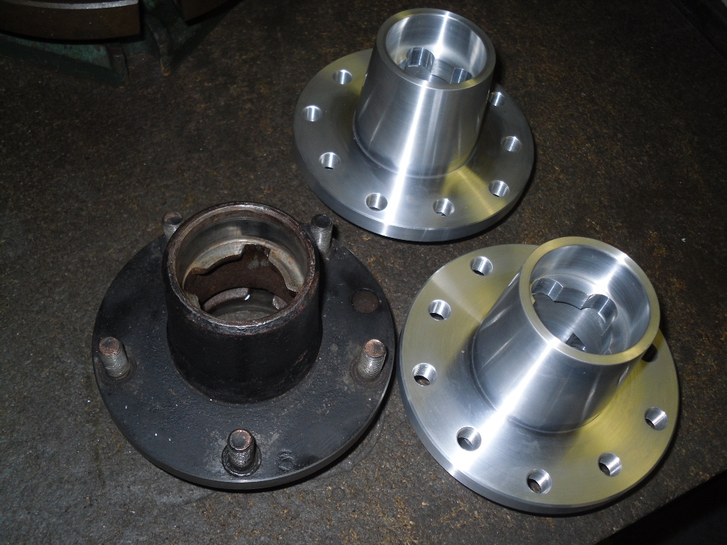

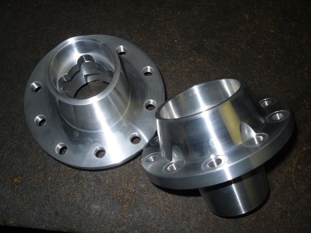

    The material arrived for the front hubs.
    I had a bit of spare time so spent a few hours copying the old cast steel Chevy units in nice lightweight aluminium, I decided to double drill them to take Ford & Chevy PCD to give me a better choice of front wheel selection.
    Look a whole lot better than the originals and over half the weight too.
    Just need to make some caps for end to keep the grease in and the dirt out etc.

  17. Yeah, absolutely lovely machine work, will cut seconds off the ET.
    9sectruck likes this.
  18. loudbang
    Posts: 40,346
    Wow that is some nice work more details on how you did it and the type of machines used would be great.

    So how much do the new ones weigh vrs the old ones?
    Looking good!

    Thanks for the compliment, I forgot to take pics while machining these but just used normal machinery, I have a Colchester Chipmaster Lathe and a Bridgeport EZtrak Mill that I use in my everyday business as I have a small home engineering machine shop. Heres a pic.
    They weigh around half the originals , just a couple of lbs each.
