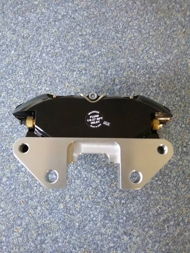

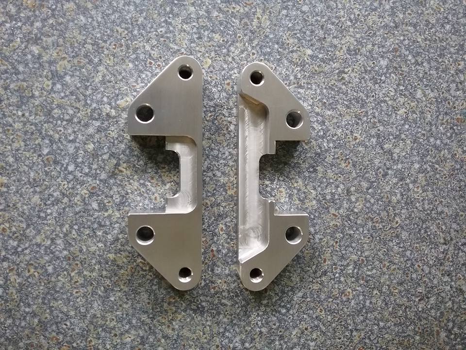

    Winter upgrade time for the old truck, I decided to replace the front brake calipers with some new Wilwood 4 pots which meant manufacturing a pair of brackets from T6 aluminium.
    A bit of trial and error to get all the clearances correct which meant back and forth from the milling machine to the truck but I'm really pleased with how they turned out.
    I'll probably fly cut the Wilwood name off which will also remove the black anodising as they look a bit too modern and show through the front wheels.
    Caliper bracket1.jpg Caliper bracket3.jpg Caliper bracket4.jpg Caliper bracket5.jpg Caliper bracket6.jpg

    As usual that is some nice machining work.

    How about cutting some fins? Not enough meat to make them very deep, but fins would fit the theme better than flat.

    Thats a very good call, I'll pull one apart and see how deep I can go, thanks for the idea! :cool:

    From what i found Wilwood's engineers don't leave a lot of fat on anything.

    You were right, not enough on there to cut grooves so I just milled the name off instead.

    NICE WORK ON THE BRACKETS.id finish the wilwood script in black and leave the calipers alone.
