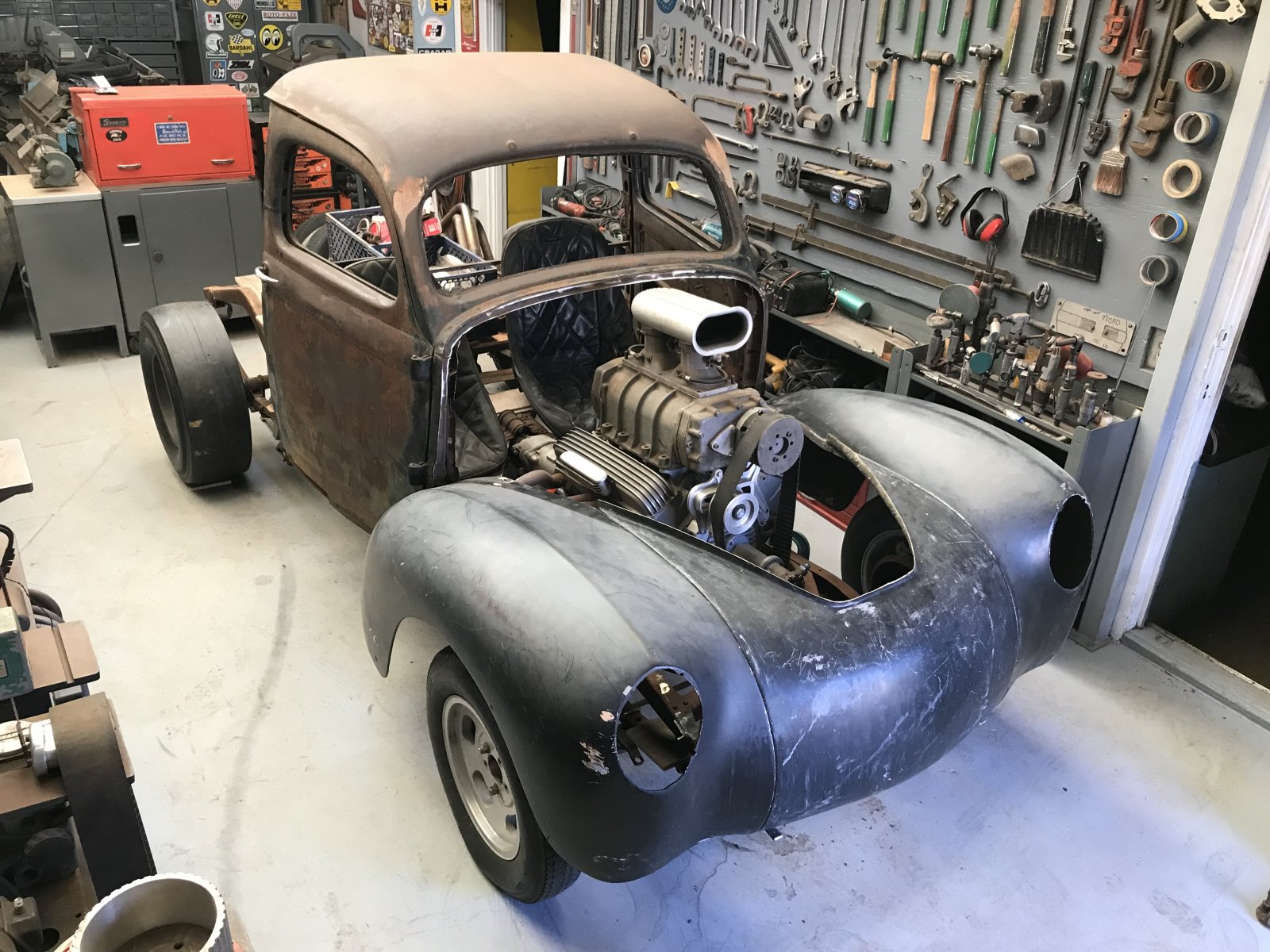

  25. IMG_1953.jpeg IMG_1963.jpeg IMG_1965.jpeg IMG_1971.jpeg IMG_1977.jpeg I cut up a sedan I got from Porkshopjohn several years ago. I figured one day I might build a race truck for myself so I mocked it up in my garage so I could day dream about it.
    9sectruck, KiWinUS, porkshop and 3 others like this.
