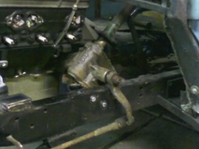

    Kevin the Ross steering box is an old sprint car box.my truck has the same box as well.

    The stock boxes on both my 41 willys sedans are Ross also, a little different mounting but they must have made a few applications?

    I think landseaandair nailed it with the steering box. The mounting holes on that tractor look the same. It is probably a Ross box that was used on several things. I have had several different styles of Ross steering boxes over the years and I know they came stock in Willys and a lot of different cars and even fork lifts etc. I was just wondering if anyone knew exactly what this one came out of.
    Modelkitbasher.... I know Ross boxes have been used an all kinds of race cars and hot rods over the years but I don't think they made one just for sprint cars. I'm sure many builders put them in old sprint cars.

    Iam sure your right Kevin,I just had a guy tell me that about the sprint car thing.thought I would relay what I was told.keep up the great work man.

    Steering box mount. The column is also bolted to the firewall structure inside....
