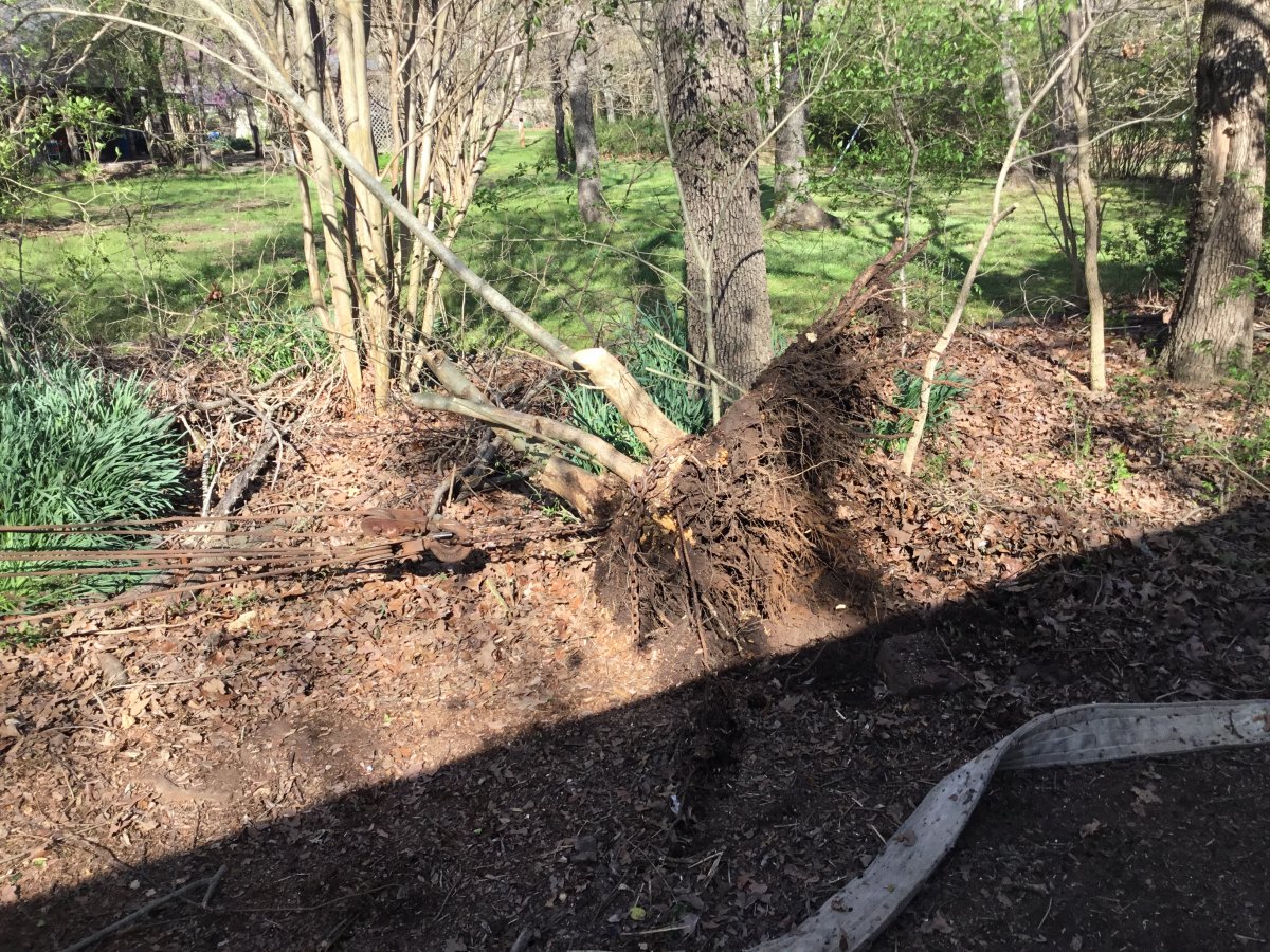

    Well guys, you just stepped off into my bailiwick! I used to be a couple of different brand winches, dealer! ....First of all ... all winches are rated off the first layer of cable! So... if you have a 8000 lbs winch and 16 feet of cable layed out , you actually have a 4000 lbs winch! A 4500 lbs winch on the first layer will out pull it!
    You all are all talking about different lbs. winches...... well, a winch can only convert whatever energy you have in a battery to motion!
    To get the “ full” 15000lbs force, advertised by some companies, you need three 31 series batteries hooked up in parallel to achieve 15000 lbs of force!
    A little winch on a large battery will work better than a big winch on a small battery!
    Like mentioned a ****** block will help the winch pull a big load! But that comes with a penalty!
    But using pulleys to your advantage, can be beneficial! Here is a stump I pulled out with a Polaris . And that is a small one!

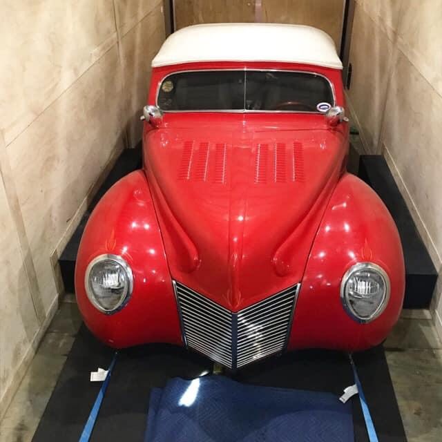

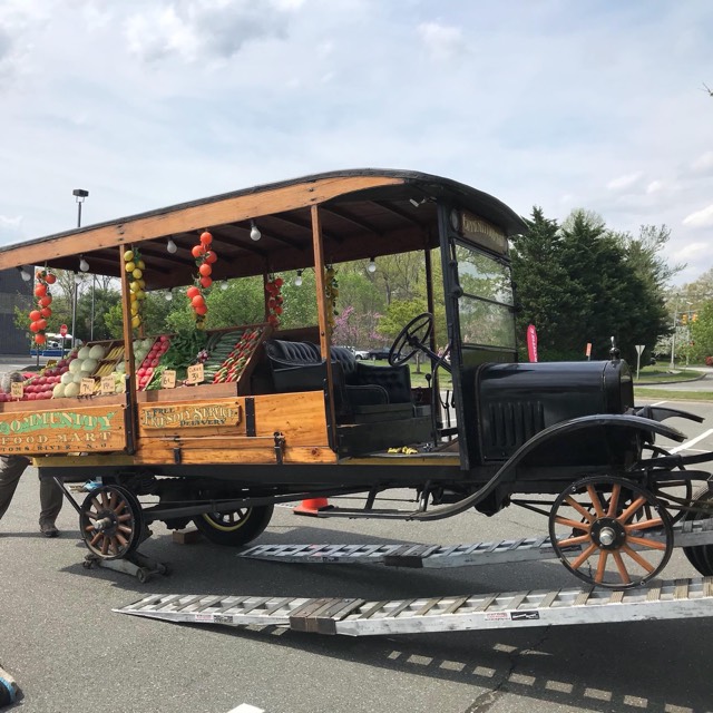

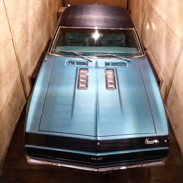

  12. I use a winch every few days.
    Harbor Freight 12K w/wireless remote.
    I load & unload all vehicles using the winch.
    Jim

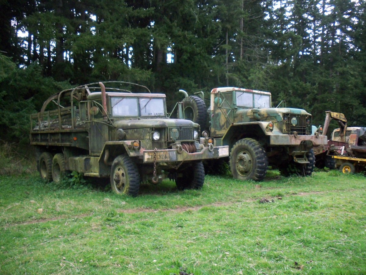

    my m123 has a 45000 lb winch behind the cab. it will pull an m60 tank on a trailer do I win? 100_0389.JPG

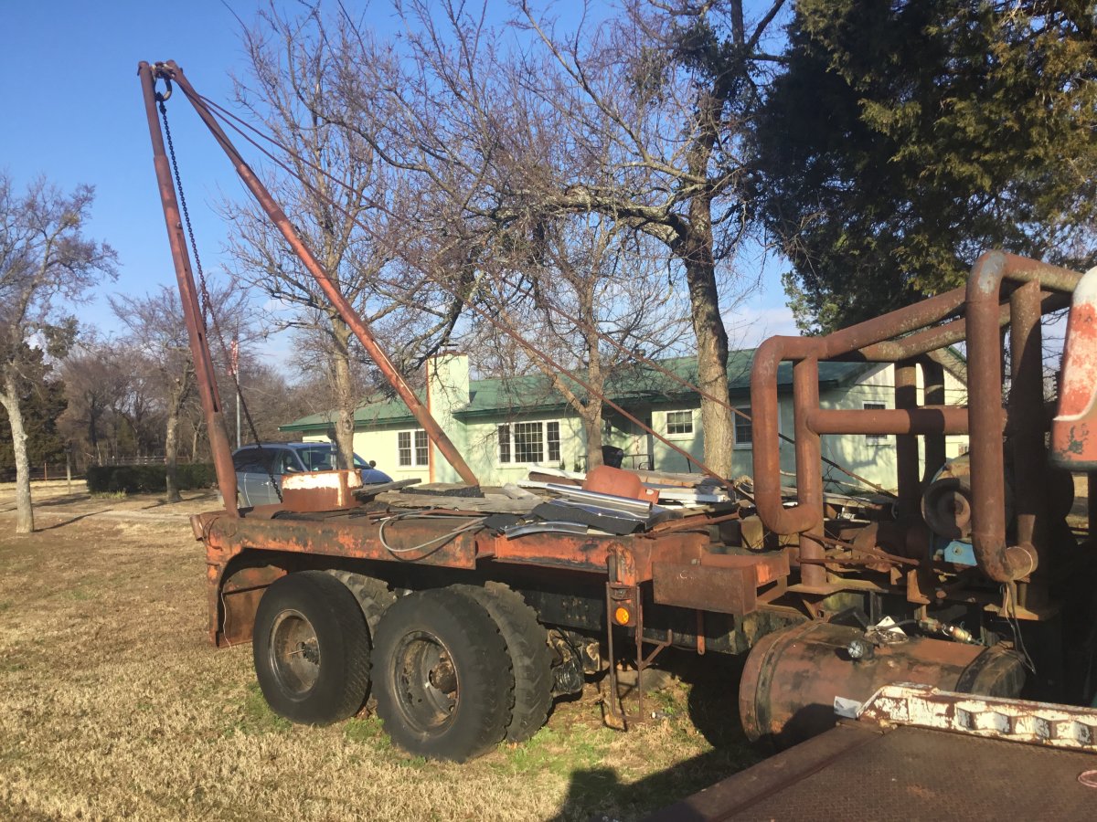

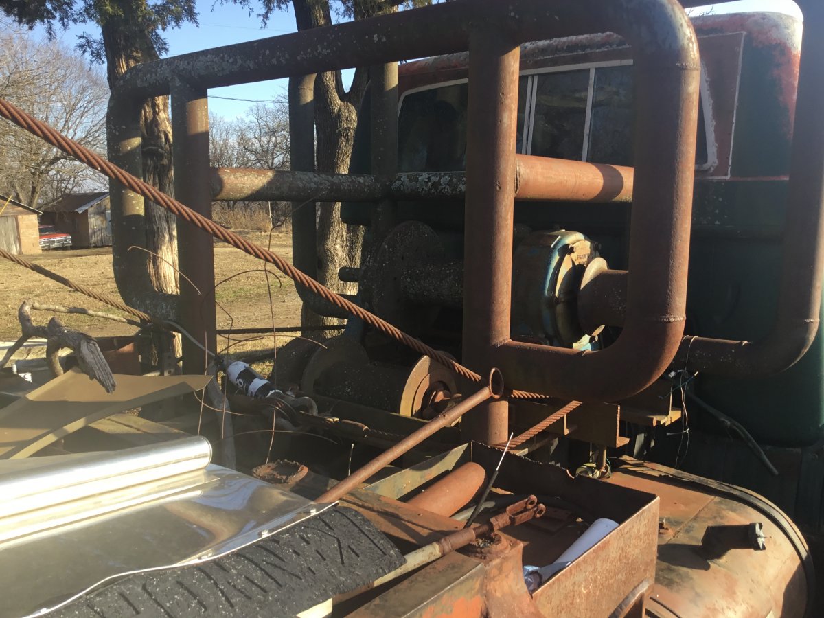

    No..... my truck has a 45,000 lbs winch too and a 20,000 lbs winch for live poles. ED016288-263F-4372-9517-1D5FF88DAE2E.jpeg E2E2A7A7-8EDB-467E-A9E8-906AEA9D3E1E.jpeg And I have several ****** blocks to boot. These are just two of over twenty five winches that I own! Lol

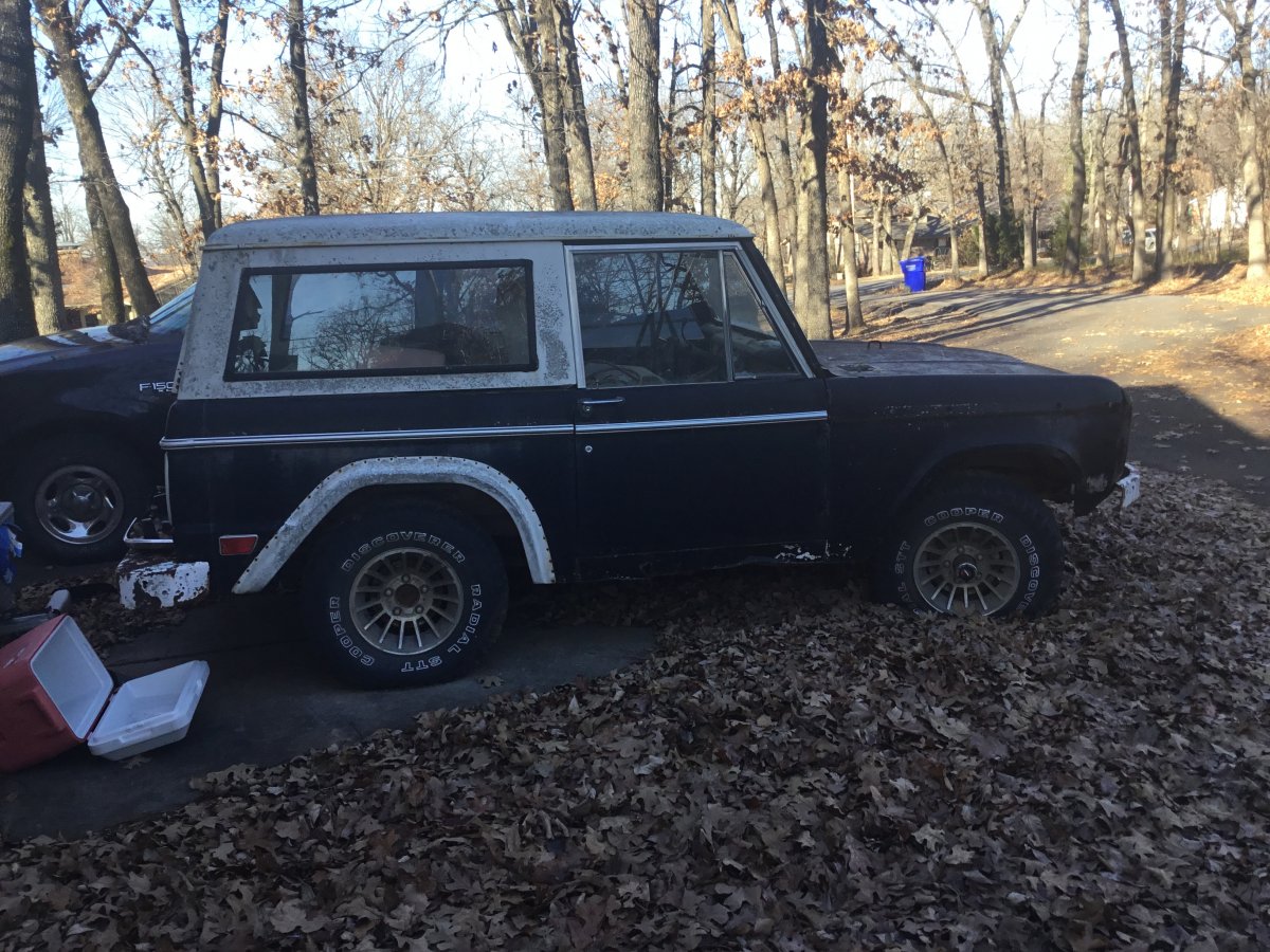

    In the event you might want to sell that Bronco I'd be interested.

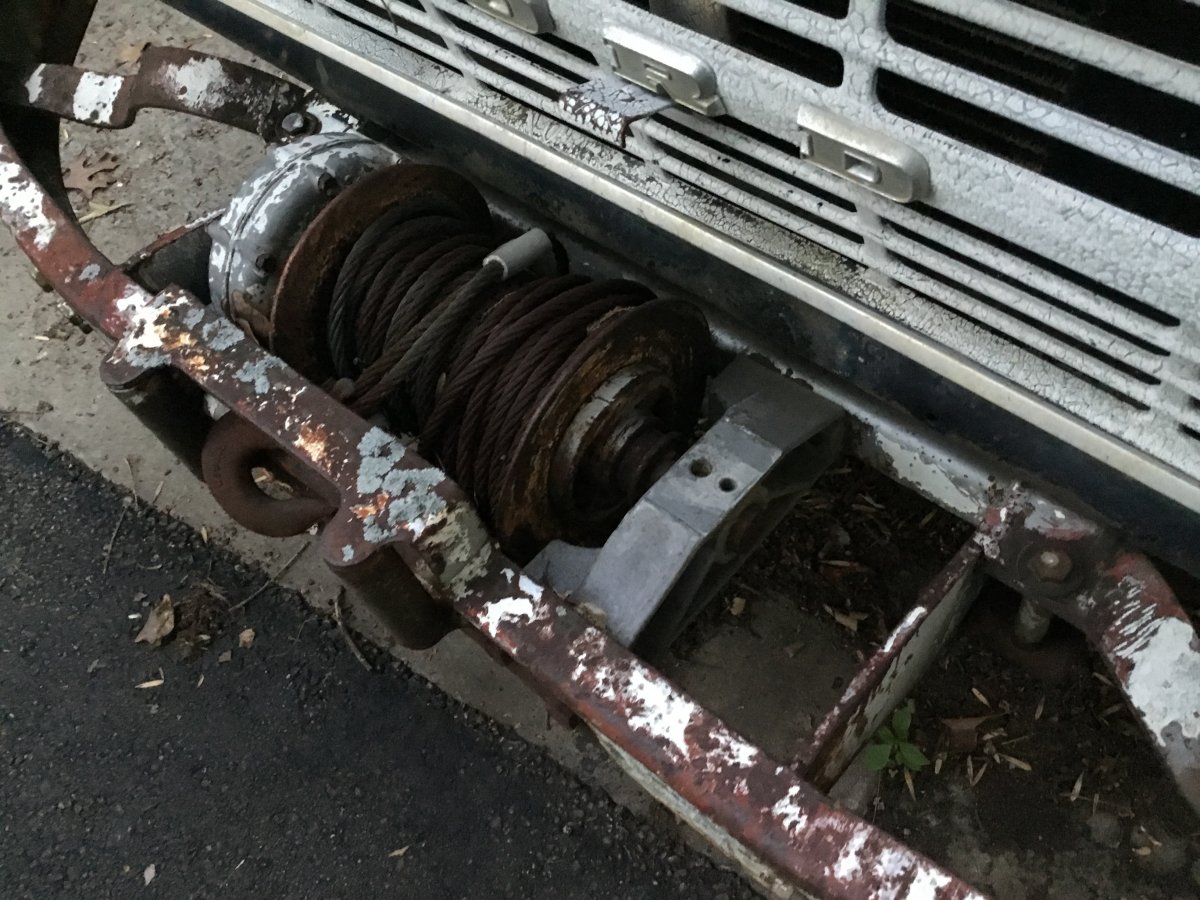

    My neighbor ordered that Bronco special in 1968 from Clay Ford, Checotah, Okla, with almost every option available that year. Including two trac-locs and pto winch. My friend bought it in about 1972. We four wheeled in it for a couple years. He drove it to his ex wife’s house, things went bad, she shot and killed him with the gun he bought her and taught her to shoot. I lost track of the Bronco after that. About 15 years later I saw it for sale, at a business. I bought it, played with it, let it set, fixing it back up now. I reckon I’ll keep it and the 73 that I have.
    Bones
