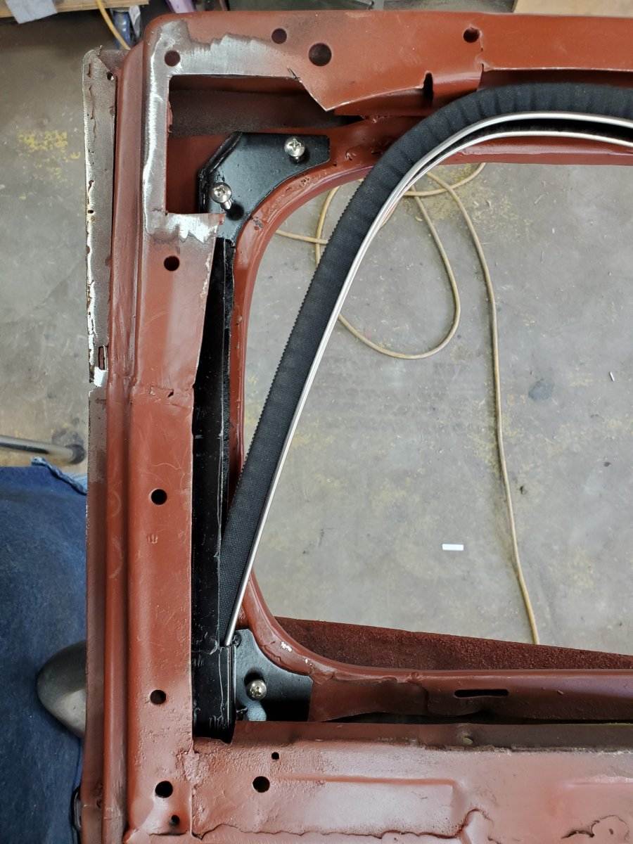

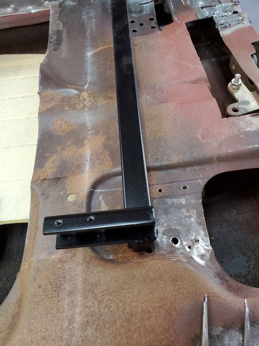

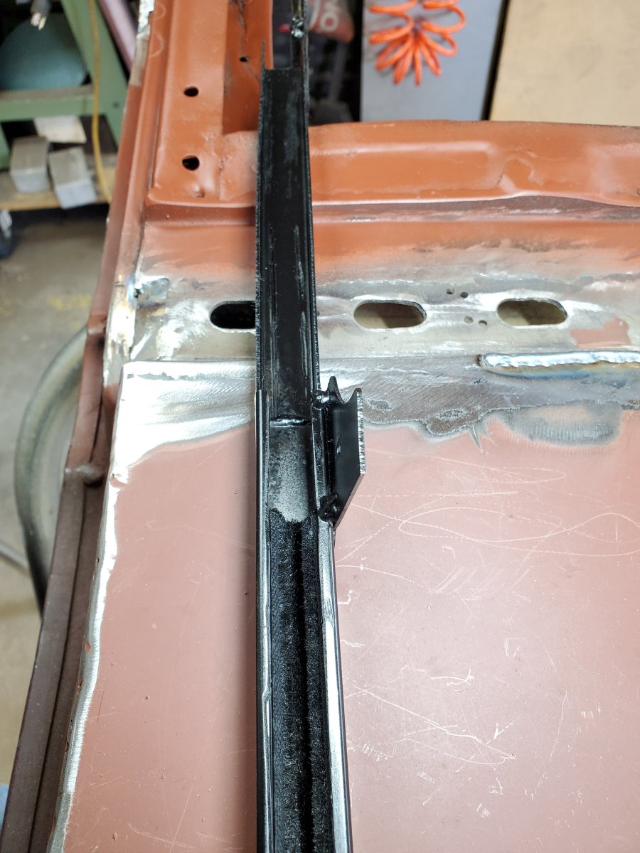

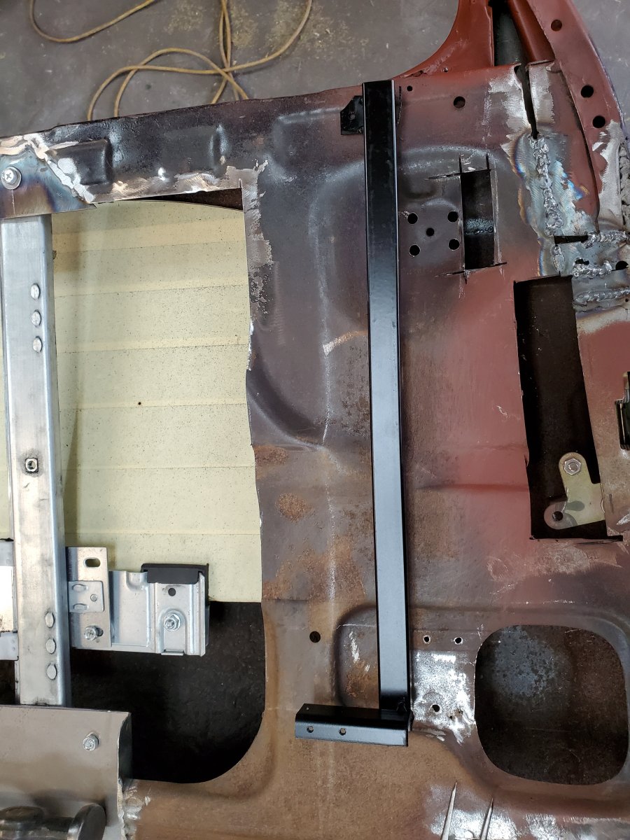

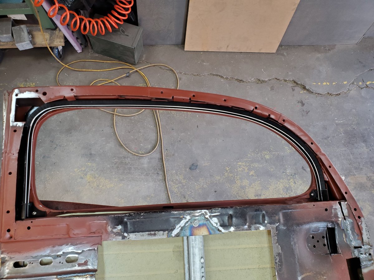

    I made my own tracks for my 35 5W. I used flexible universal window channel I bought off Ebay. made tracks for it out of 3/4" square box tubing I got at Home Depot to make the vertical supports. The channel fit in the upper door nice and snug with no support needed.

    Good stuff Do It Over . Thanks for the pictures. I will probably have to do this for my Es***.

    thanks for the pic !!
