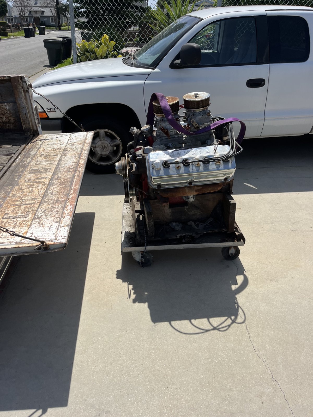

  23. Woa...oil pan failure! So, is it getting a blown and injected hemi now?
    Hollywood-East and Rolleiflex like this.
  24. drumyn29
    Joined: Feb 16, 2006
    Posts: 2,305
    drumyn29
    I was picking one up at the time.

  26. Oohh Baby ,
    Imperial valve covers too ! ,,,,,that’s a nice one there .
    Look at it this way,,,,it’s a sign you needed to swap engine brands !
    That Hemi will more than make the pain go away from the windowed block .
    Tommy
