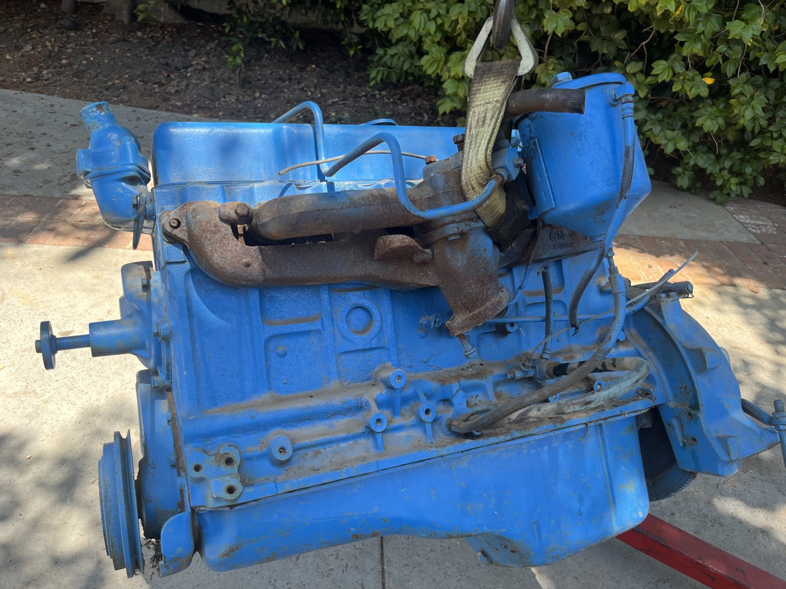

  9. drumyn29
    Joined: Feb 16, 2006
    Posts: 2,405
    drumyn29
