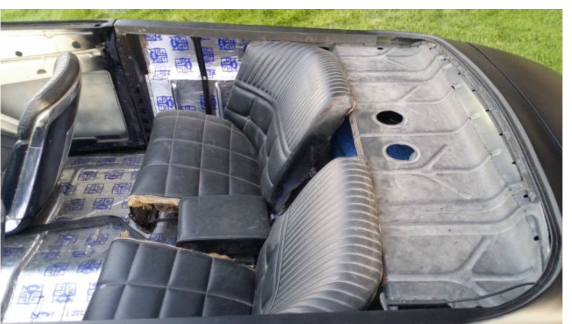

    I am thinking about buying a open air 1949 custom mercury convertible. Can side window and convertible roof be put on vehicle?

    Was it a convertible to start with, and now the top frame is missing, or was it a coupe or sedan with the roof cut off? Second one seems more likely.
    First things, before I'd consider any beheaded former coupe or sedan, I'd want to see what was done to reinforce the body. These cars are known for having wasted inner rockers and other underside rust issues, if they just cut the roof off, you're in for a ****load of work.
    If it was a convertible originally, it shouldn't be too hard to make a Carson style lift off top and make the side windows functional again, but if it was a sedan or coupe, the original window mechanisms and door vent wings aren't really going to work without the door frames in place. Were the door tops capped? Lots of questions here.
    If you post some clean pictures of the car, especially showing the rear top section and the tops of the doors, it will be a lot easier to say.
    No matter what though, it's not going to be easy or cheap. Just to find a Mercury convertible top frame could take years and thousands of dollars. Not a whole lot of those getting cut up for parts.

    Before I attempt to buy this I just wanted to know about outing windows and convert top. Not interested in a roadster with no window or top.

    Making a top for it wouldn't be impossible, but making the side windows functional would be extremely hard. You'd have to find some vent wing windows from a convertible or hardtop of the same period and adapt them to your front doors, along with some ht/cvt window frames and regulators (sedan ones aren't going to work, they need a frame around the gl***) and you'd have to damn near design the rear quarter ones from scratch, Merc coupe quarter windows popped out in a vent wing design and never rolled down.
    I love Mercs, and I like a metalwork project, but it would be an insane ****ing ton of work to give this car a top with functional side windows. Like 500 labor hours. It'd be easier to weld a top and door frames back onto the car. I hate to say it, but the car is kinda ruined as-is. I bet it was a top chop job gone wrong, and that's a shame.
    Dash is nice though.

    Just spoke to the owner and he has the side windows and the wing gl*** just hadn't had the chance to put them on. He said the only thing I will need to do is fabricate a convertible roof or Carson top

    It's the same old story, what's your skill level, pocketbook and desire for this car? It could be very nice with enough skilled effort!

    He said that did he? That is not surprising.
    Mmm, well, by the questions you are asking, I get the impression you are temped to buy something because it's cheap and you have nowhere near the skills or experience or possibly the money to make this hack job into anything good.
    Don't be tempted by cheapness or seller spin.
  12. I don't see a place to put a rear side window, unless you are a glutton for punishment, run!!!!!!!!!!!!

    I think the seller is way underestimating the amount of work it would take in the hopes you'll buy it from him. The reality is it would be extremely challenging to do for someone without experience.

    Well I am going to go down there with my mechanic and he will make an ***essment for me. He makes a habit of not giving any ***essments until he sees it in person but be shares your skepticism.

    Looks like more work than I'm thinking you realize. And personally I don't think a "mechanic" is the correct person to make an ***essment on level of work needed on a cl***ic/Hotrod/Kustom.
    I've done quite a bit of fabrication work, and wouldn't even consider this project.

    Looks as is if it would be an extremely expensive proposition at best. Finding the convertible parts you'd need would be a challenge. A Carson top to me is Fugly. If it were me I'd p*** on this project. It s always easy for others to spend your time and money.
