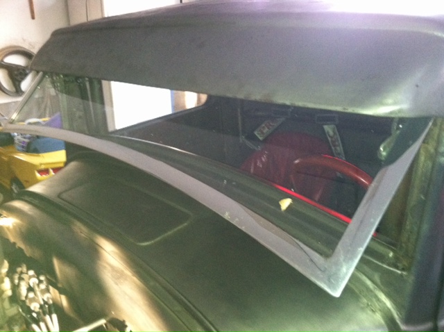

    I used an aluminum one on my pickup. Like any repro piece it wasn't perfect but it didn't take much to get it into shape. The bottom arch was slightly off on mine. I chopped it and to cut the corners and angle them out further. Once the corners were cut loose it was easy to reshape the arch.
    Like you said aluminum is easy to work with so it was no big deal. I ended up polishing it and I think it looks good.

    Mat Thrasher
    Here's a couple ****ty iPhone pics, hope that helps.

    scootermcrad
    Looks pretty good to me!

    There's a T-shaped rubber that slides in the frame. I can't tell you if it works or doesn't. I never put mine in. I don't have any side gl*** and the nothing else is sealed up so I'm not too worried about it. Plus the couple of times I've closed my windshield the exhaust fumes about killed me!
