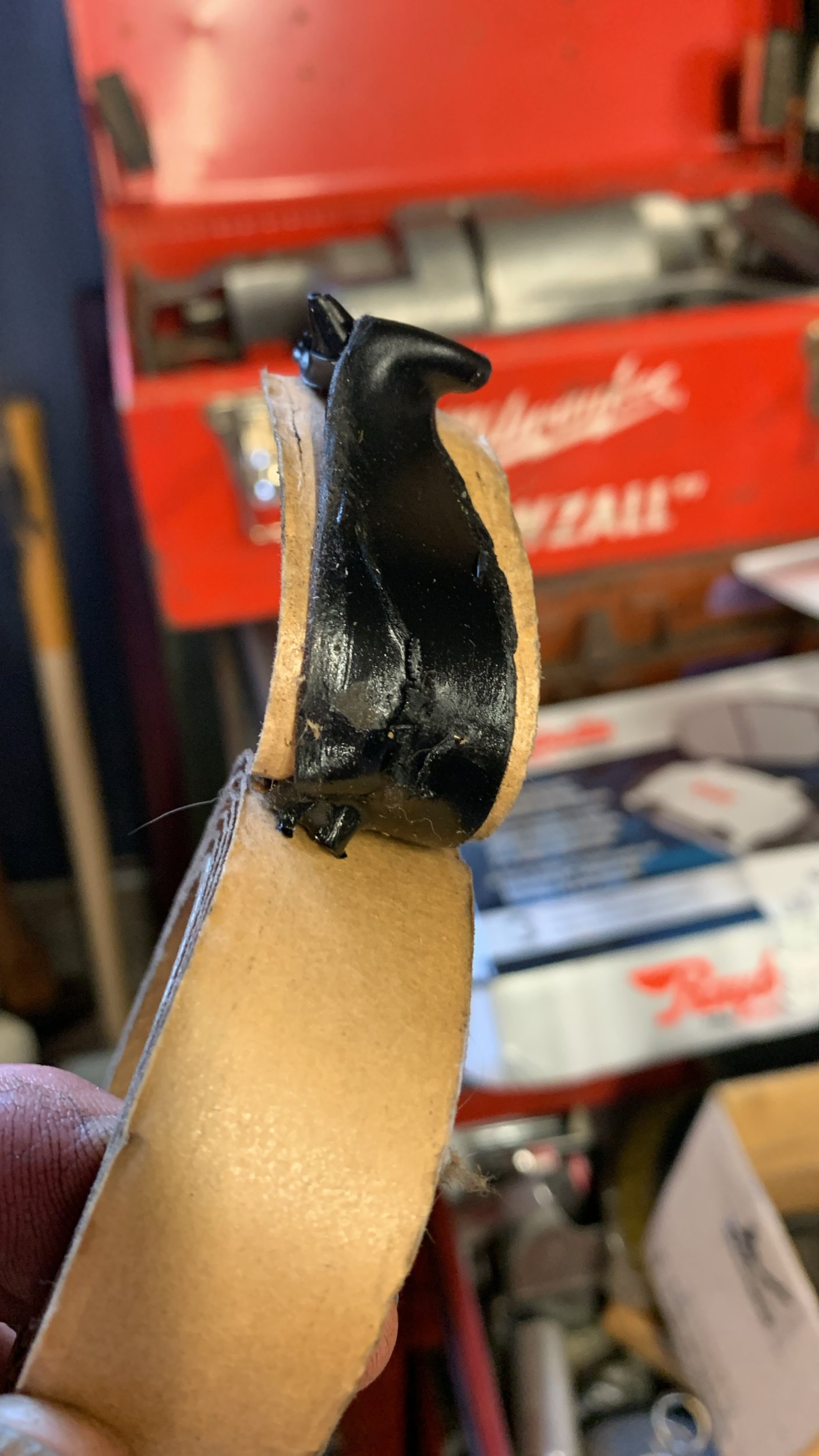

    I removed a windshield without damaging to install on my daily..and i see there is windshield adhesive on a roll which would be easier to apply..anyone ever use it,,seems like a dated product but i got a few feet in my garage and its still as sticky and pliable as it was 20 years ago..
    Ive found the product available online..

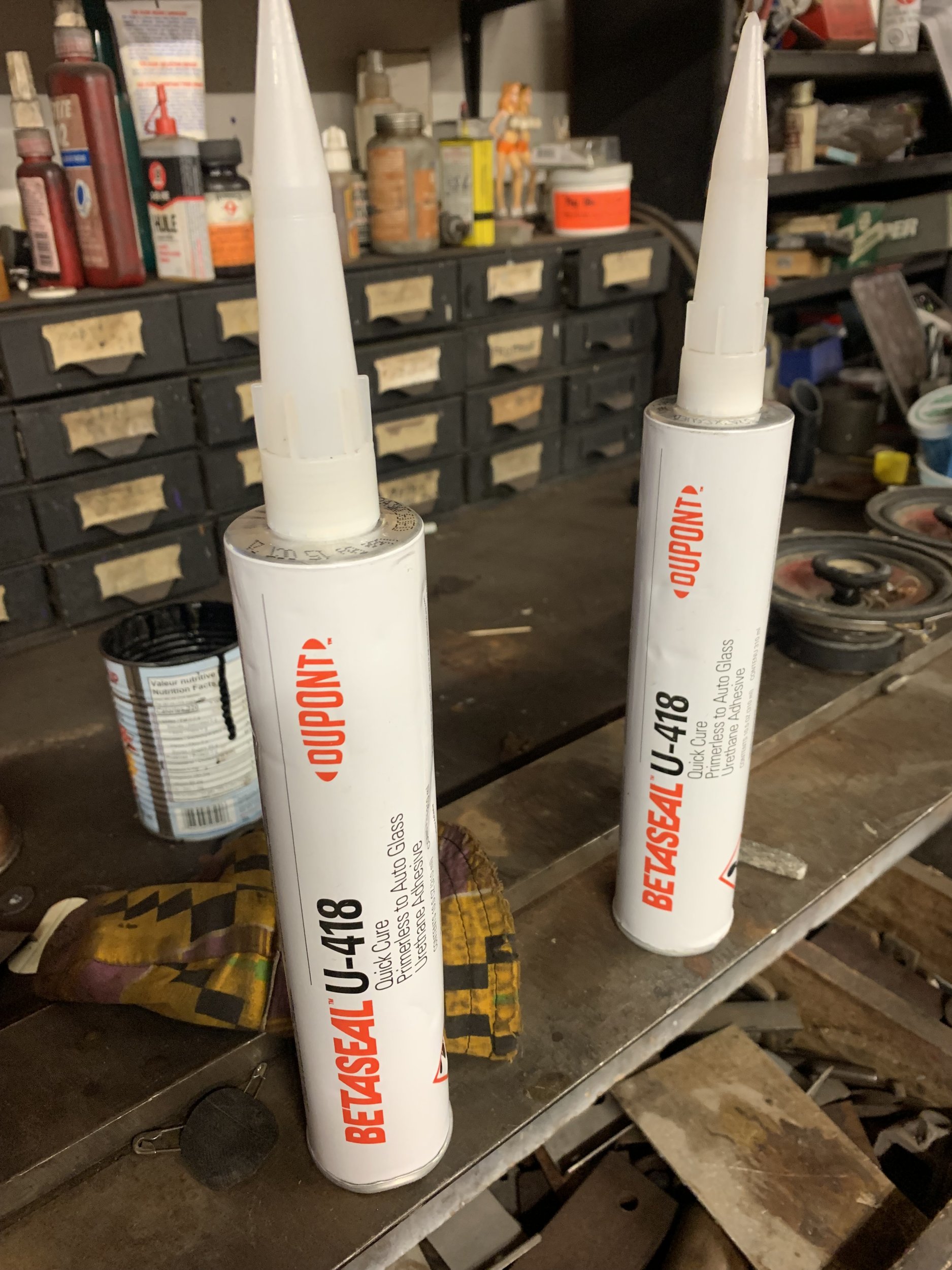

    Thanks for responses..my bud gave me 2 cartridges Betaseal U418 urethane windshield adhesive today so thats what im using…was looking for easier option but cant turn this down…
    There is a lot of products get damaged in shipping…good to have someone ya know keeping eye on whats headed for dumpster..
