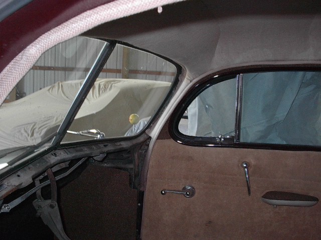

    Electric on my 40
    HOTRODPRIMER, ladyhrp and neilswheels like this.

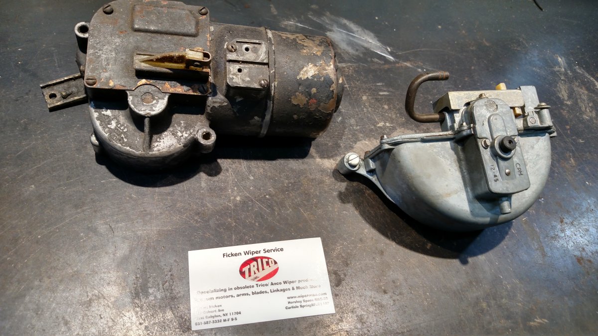

  21. chevy57dude
    Joined: Dec 10, 2007
    Posts: 9,878
    chevy57dude
    Met a guy who rebuilds Trico vacuum motors. Going to give him a try on mine.

  22. neilswheels
    Joined: Aug 26, 2006
    Posts: 1,374
    neilswheels
    from England
    Got any pics Frank? Looking at doing this on my 40

  25. Ned Ludd
    Joined: May 15, 2009
    Posts: 5,581
    Ned Ludd
    Those are either Trico-Folberth or Sprague. They're comparable in size to Trico vacuum units, and they should work fine with an air suspension pneumatic setup, even one with an electric compressor.
    Trico-Folberth:
    Sprague:
    I think a Trico-Folberth motor would look right at home in a hot rod interior.

  26. Frank Carey
    Joined: Oct 15, 2009
    Posts: 579
    Frank Carey
    No pics. Too long ago. My wipers are above the windshield. Your '40 wipers are below. Not much in common.. The beetle my wipers came from had the wipers below the windshield so you might be able to use more of the VW system than I could.

  29. 4tford
    Joined: Aug 27, 2005
    Posts: 1,824
    4tford
    Don't know the source it came with the car I installed the motor and switch.
