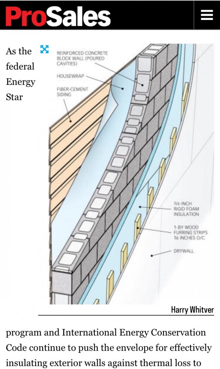

    I'm with nrgwizard, I would try to insulate the building 1st.
    http://www.prosalesmagazine.com/news/industry-trends/new-ways-to-better-insulate-concrete-walls_o

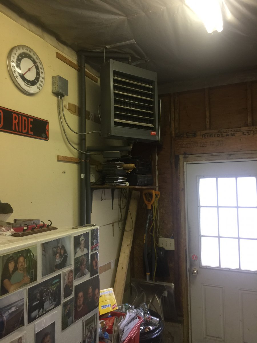

  10. DDDenny
    Posts: 22,542
    This "Hot One" heater has a fan but is probably a little small for my shop considering the height of the ceiling but the big ceiling fan helps bring the heat back down and circulates it pretty well. It pivots up and down and I made the mount so it can be rotated based on where I'm working.

    Thanks for the pics. I think I will do as you did. My ceiling is 10' but not insulated ( I have junk handing from the trusses). I will re-arrange and then call my nephew to do final hook-up as he is a certified HVAC guy and you don't want trouble with insurance companies re is ever a problem. The main work area is 19 X 28 and the unit is a sealed 40,000 BTU unit that is 10' long and then reverses itself. I also have another unit rated at 80,000'BTU that is not sealed which if needed could be installed but not used when painting. It's getting chilly around here at 7* c . It's not the temp it's the constant rain that absorbs the heat so easily!

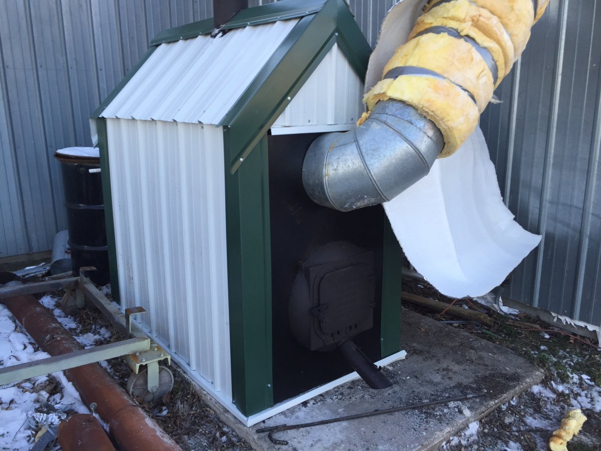

    I've had radiant floor heat for 5 years. I get cold easy and always feet first. I heat my house with wood from outside boiler. I run my return line from the house through pex tubing in the floor, in other words I siphon a little heat from the house. It is easy to keep floor from 55* to 60*. It is easy to work in my regular shoes and sweatshirt, for hours.
    Go over to the Garage Journal and you can find a lot of good information. This is where I got all my information for radiant floor heat and where I learned enough to design my own system. My handle is the same over there, Chevy G***er, I have pics and information about my setup.

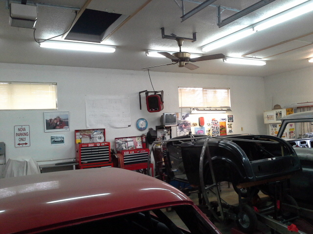

    You can see in your upper right hand corner I usea 45000 BTU hanging shop furnace. These are wonderful if you have 9 ft and up ceiling.... I keep it @ 55f Unless Im out there flandering about ...then its up to 68-70. I have tried wood stoves they just take up to much room and need to be looked after for fire hazard etc. and keeping wood around invites bugs...... Another benefit about constant heat is it keeps the temp up and humidity low so when spring comes all your precious metals wont sweat and corrode.....
