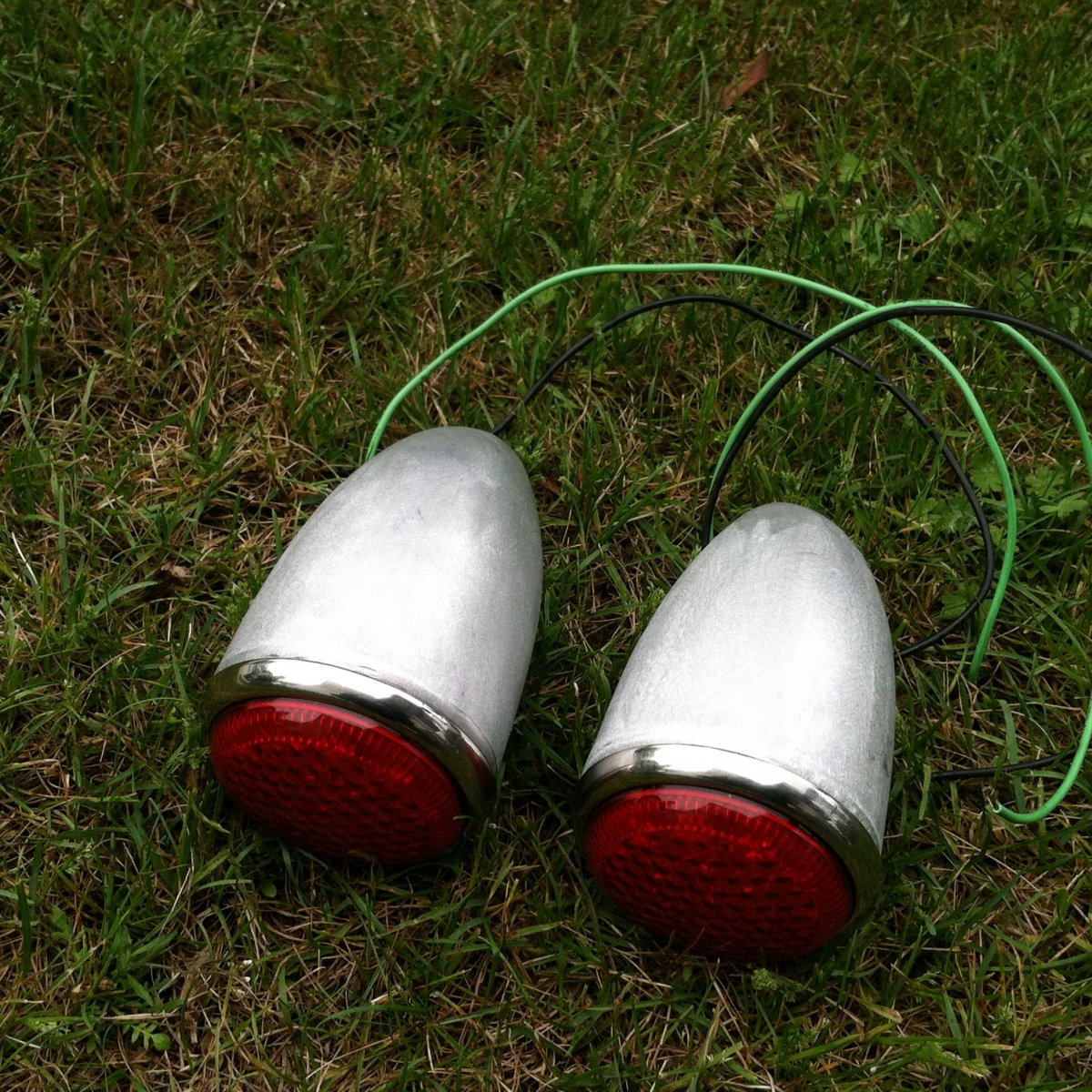

    Headlights, tail lights

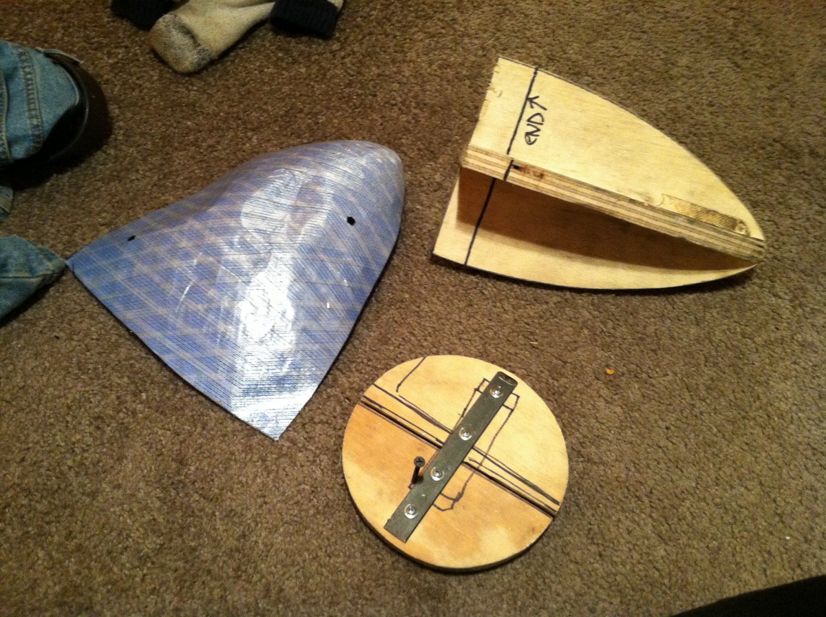

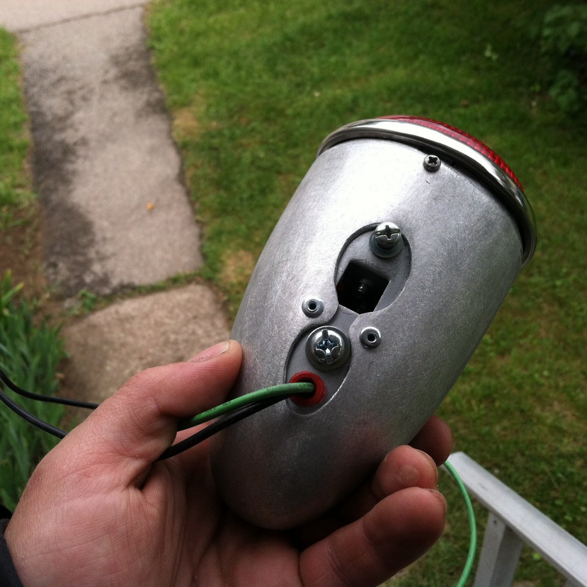

  6. Hey J,
    What can you tell me about those light buckets
  7. CustomJ
    Joined: Dec 10, 2008
    Posts: 103
    CustomJ
    Well, Jeff bought headlights out of a speedway catalogue, I took the diameter of the originals and cut the wood,
    Then after that I made halves and took a flex pattern off of the half I made and welded the two halves around the diameter piece of wood to get an exact part.
    After that it was a matter of using a bead roller to make a groove for the trim rings to fit into.
    I just mounted them today after making mounting brackets, I used brake lines after Barry gave me the idea to hide the wiring.

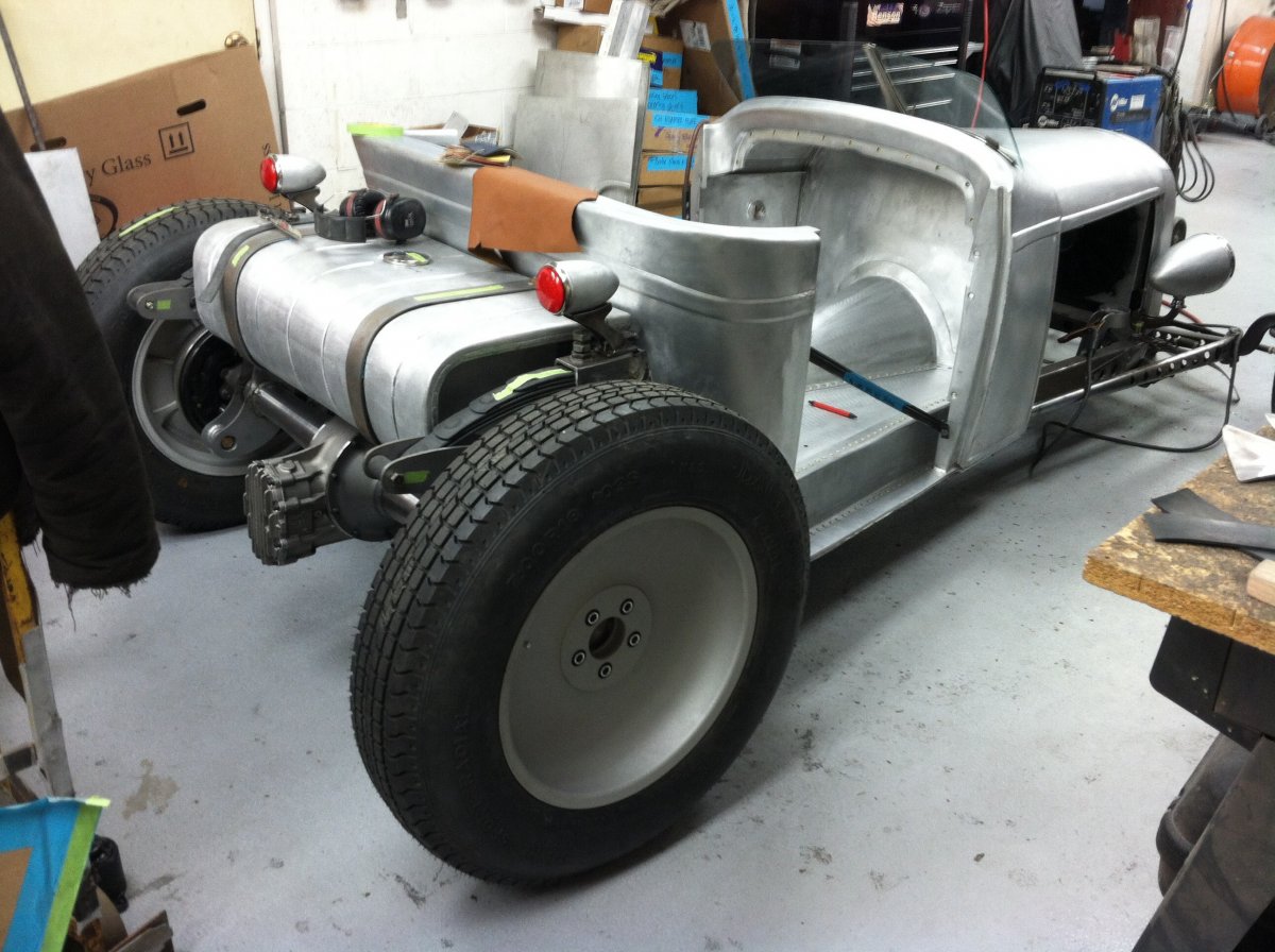

  12. CustomJ
    Posts: 103
    CustomJ
    heres an update on the car, just finishing up the details.
