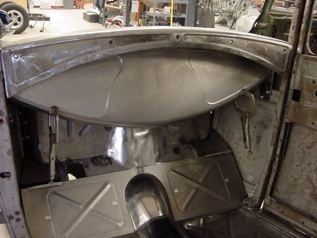

    Well after solving a few of the exterior problems I knew that I would need a good floor and support structure to support the body. The car came on deuce rails and I did not like what was left of the original floor so I cut out what was left and decided to fabricate a new floor. I got 3/4" cold rolled tubing and welded two pieces together on the very ends on the inside seam only. This way when I bent the tubing to the shape of the rails they could flex easier and could be welded together later. This is the structure that I built after the two side rails where formed.

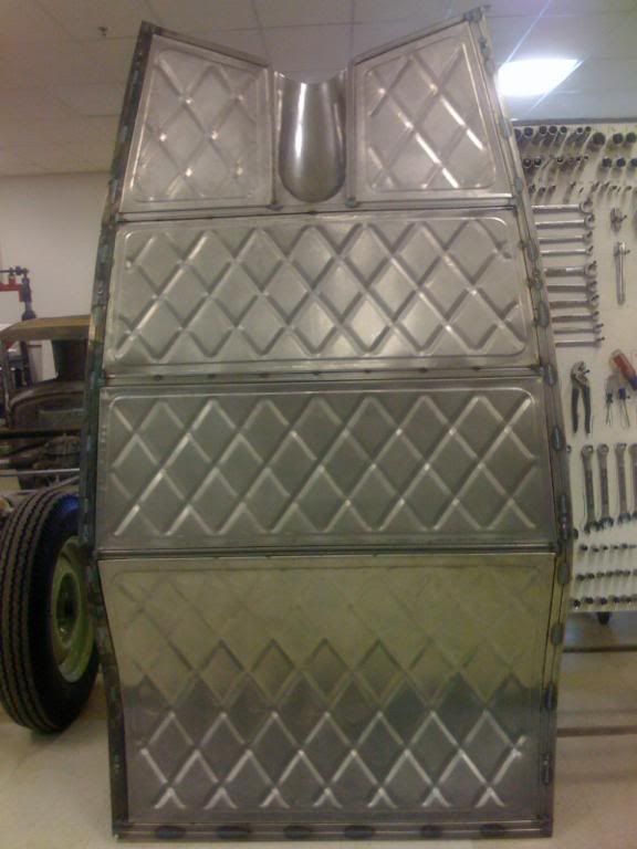

    Next it was time to start putting a floor in the car seeing as it now had a support structure. I initially had contacted Tim Conder, one of my favorite artist, to do a rendering for this project but funds got tight and the time slipped away from me. I had many ideas on what I wanted the sedan to look like but I really wanted to do a more traditional car. Looking in old hot rod magazines like the "little books" I knew that people used to upholster their wheel wells and other outside areas of their cars. I wanted that upholstered look but did not want to deal with sacrificing driveability or having to clean filthy upholstery. I have been kidded by friends as to having robbed the panels off of a taco truck but I ***ure you I painstakingly rolled these from flat 16 gauge cold rolled sheets and did my best to make them look like diamond tuck interior from the bottom of the vehicle. Yeah, I know, who is going to see the bottom of the car, well me, and that is the look I wanted.
    I new that I needed a transmission tunnel for the floor to cover the turbo 400 and I wanted it to almost be one piece, or look like it, so I started looking at the tools around the school. I had never used the power hammer before, and figured that this would be the best thing to use, so I fired it up and started going to town. I had hand hammered a gas tank before so I had a good idea how the power hammer worked and with the help of the shrinking die on the pullmax this is what I came up. There is a upper tunnel and a lower piece, I TIG welded them together, but I got the look that I wanted.
    After getting the trans tunnel made I centered the wheels in the wheel wells and welded the new floor to the old body. I had to make extensions to the lower A and B pillars but everything came together well and I welded the original rear section of the body to the cross section of the new floor. I made an upper frame work for the kick panel, after looking at my own rendering, I bead rolled out the panel from 16 gauge. I also put Dzus fasteners in the kick panel for "serviceabiltiy" to reach any electronics or wiring that will be behind it. There will also be an aluminum floor, that matches the kick panel, that goes on top on the other floor with deadening material sandwiched between; also fastened with Dzus ****ons. I believe that this will help with noise and heat, the car resides in Texas, and also hide any wiring to the rear.

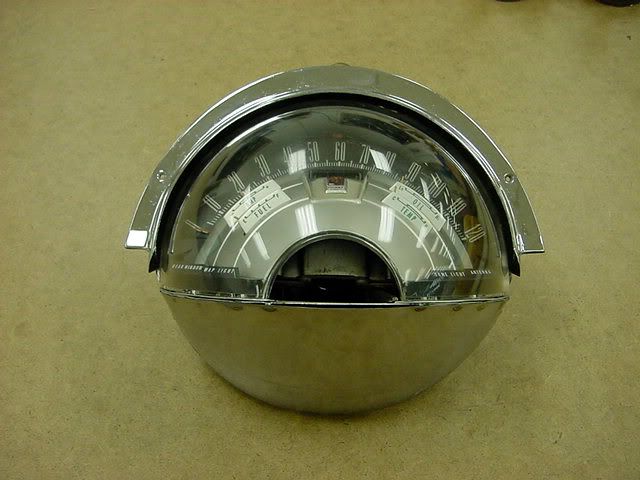

    Now was the moment I had been waiting for throughout this build, the crowning piece of the dash, a Chrysler Imperial gauge cluster. I got the cluster in trade from a friend and thought that it would match perfectly with the "diamond tuck" floor panels and be period correct??? So off to all of the machines that I had access too in school to make a lower piece to the cluster. The cluster was originally in front of the driver but I wanted to mount it in the center of the dash and make a custom lower piece. I also will put a tachometer in the snout of the cluster to facilitate in hiding the hole where the steering column used to come through... anyone have a cool vintage sweeping tach? And eventually I will make, or find, a piece of trim to separate the upper cluster from the lower fabricated piece. I decided to use the stock chrome upper trim to go over the cluster.
