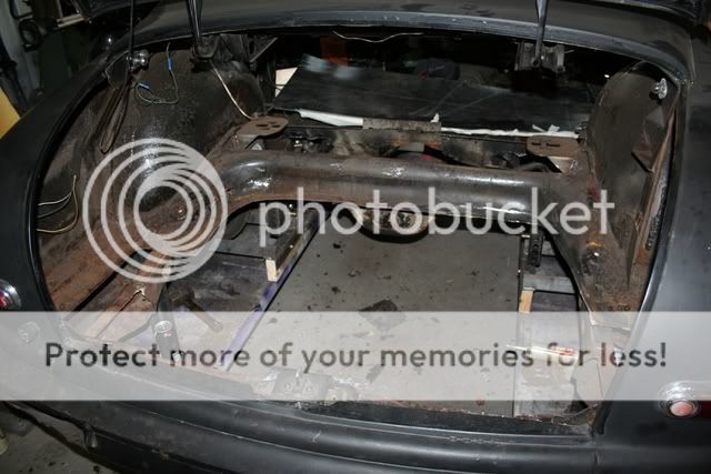

  5. The previous fuel tank arrangement was a fuel cell placed in the trunk, which, our rego guys dislike, so, we removed the previous stuff (rust included)
    and fitted a locally made GM utility (comodore) fuel tank
    and adjusted floor to suit the new suspension arrangement
    Note: the car was 'jigged' at our ride height prior to doing the repair work, squared, and straightened. New ride height is 4 1/2".

  7. here's the repaired hole...
    and tunnel mods...
