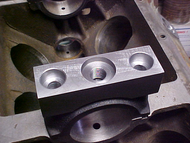

    Can you explain your cap supports, I'm not sure what your trying to do, unless there is more to your supports. I have a blown flathead and I run a center support to the sides of the block and steel front and rear caps. All this is tied together with ARP hardware. Thanks.--TV

    I did make the manifold myself. It started out as a 2x2 fenton. I made the pop off valves too. The main cap supports are a cross between billet caps and thoes crappy little aftermarket support straps. The tops of the main caps were milled flat and the support has a 5/8" fine thread allen set screw and countersunk jam nut. The bottom of the set screws have faced off flat for the maxium contact with the flat on top of the stock main cap.

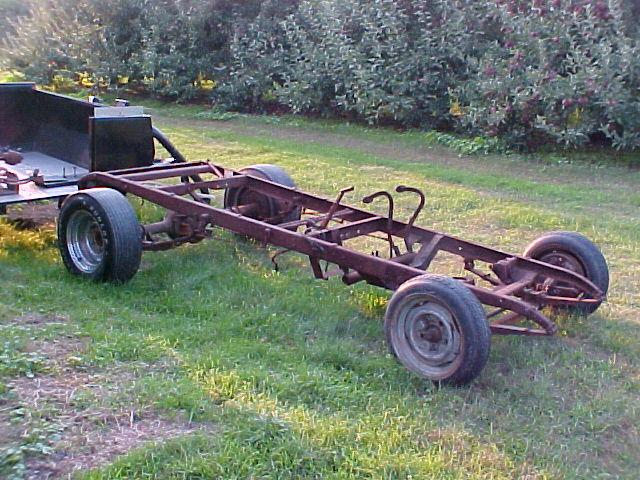

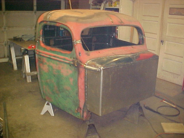

    Heres the cab, 75% done. 3" chop, 5" channel, flush firewall, no hood relief. I just got the frame rails done last week. There a longer copy of a '23 durant frame that started this project. 9" ford rear and f100 straight front axle narrowed 5 7/8". Old durant frame pictured with ford axles.

    I don't know what set up on the front you will be running under or over, But I still think your center main should be tied into the block side walls. That center web is not very strong from the start. I have seen them blown out on many blocks. Not trying to bust your chops, just trying to help.--TV
