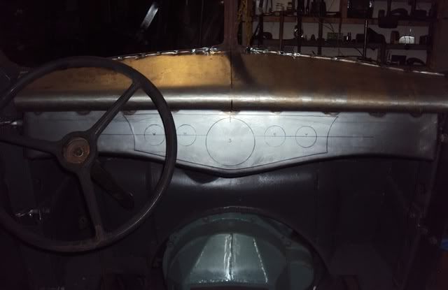

    A couple months ago I pounded out this dash piece,
    and lost it.
    Last week I found it,
    and after some hemmin and hawin,
    decided to just tack it in and see if it was gonna work.
    It's basically a larger copy of the 40 dash top.
    The plan was to let time do it's thing,
    and see if was going to be ripped out or grow roots.
    It was supposed to rain today,
    so our job was pushed back.
    I ended up staying up late last night.
    (and of course it's not raining)
    So that dash piece had grown on me a little.
    I was kicking around a zephyr like dash
    with that center waterfall type piece.
    With no huge zephyr gauge,
    it seemed like it would look more like a street rod center console.
    I do have a nice '36 speedo,
    and mixed with a '32 shape,
    came up with this.
    Using my trusty hammer block,
    pounded this out.
    For some reason the edges were tough to fit.
    I nicknamed it the muffin top dash.
    When staring at it,
    it looks a bit big,
    but this is the main view most people will see.
    I'm also planning a dash insert or overlay,
    so with some finish work, gauges and paint,
    it shouldn't be so overbearing.
    It's only tacked in so I've got some time to let it grow on me.
    I'm surprised how much it stiffened the cowl up too.
    Looking at this pic makes me want to go finish it up.
    TP

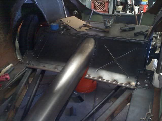

    Finally I decided on the missing subrail.
    This piece would be the frame for the floor and the fenderwell.

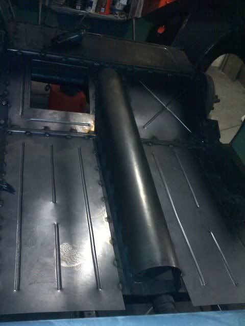

    I dug out this old hand bead-roller and decided to begin the floor.
    I'm not practiced at this at all and it was alot tougher than I thought.
    Instead of getting the hang of it on some s****,
    I went straight to the freshly fitted panel.
    Of course it came out a little wavy,
    but I couldn't waste it so in it went.

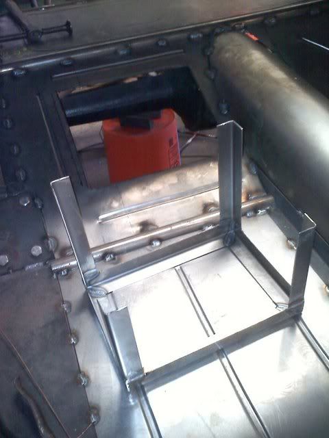

    The tube looking frame is actually 1" tubing cut in half.
    Than I made a base to fit the bead roller on using the hammer stand,
    instead of the table/clamp method.
    Much easier to work with.
    Next was the driveshaft tunnel.
    We have a really handy roller at the shop.
    The ends needed to be flattened out to make a U.
    With the tunnel tacked in,
    the gaps could be filled.
    That first piece looks alot better as a shelf!
    The tunnel diameter looks extra wide and it is.
    There are 2 torque arms going down the middle.
    The same half-tube trick was used at the base.
    A friend told me about a metal store up in his neck of the woods,
    and they had this 1x1 sheetmetal angle.
    It made the transition from the tunnel to the floor quick and easy.
    Not pretty though but hey it's a floor.
    This really helped cause the fitting didn't have to be exact.
    I wasn't worried about a little overlap on this part,
    only 1000 of us will know about it.
    If you noticed the sheetmetal bumps weren't symmetrical on the angled part,
    it's cause the plan was for the battery to be stuck in there.
    All this work has been over the past week,
    a couple hours every evening.
    This morning I rallied up (wife works so kid duty!)
    and got the start of the battery box.
    And that's where I'm at!
